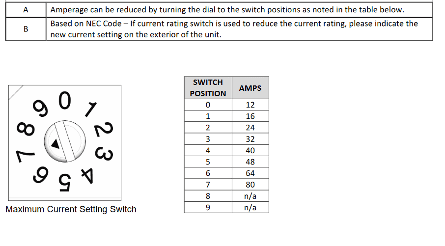

One thing to note, the amperage on the Ford Pro chargers that come with the XR's are adjustable so dial it down to setting #2 for now and this would give you an "upgrade path" later.
They're available on this forum for around $500 or so

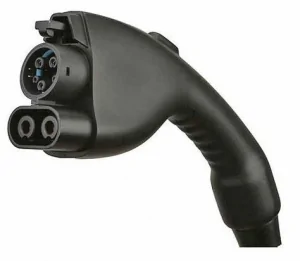

All true BUT BUT BUT.... Because the FCSP has the possible feature of home backup built in, the CCS style plug is used. This is a deal breaker. Why? Because all too soon in life, we will have friends/family/visitors or another vehicle. That CCS plug on the FCSP renders it UNUSEABLE in a standard J1772 vehicle, of which there are many.
I installed the FCSP for my brother. I happened to be driving my RAV4 Prime PHEV. At the end of the install I sort of ignorantly moved to plug in my RAV4 to test. Boom. Reality hit me. I had not grasped this. And do NOT suggest that J1772 is dead. Its not. CCS might be as a DC Fastcharging standard, but lots of J1772 will likley co-exist for a long long time. The FCSP is not a bargain, even at $500. Get the tesla or if you need cheaper, the Emporia is more affordable.

This is correct. J1772 and Tesla together are good future proofing. For home overnight charging 48A will be enough for a very very long time. See below why NOT to use the Ford EVSE.
Good point, I had thought of that. so one would need a CCS to J1772 adapter which appears to not exist maybe just take an oscillating tool to the lower part of the plug!! :)
cdherman
Jul 18, 2023
142
148
Kansas City
RAV4 Prime, 2016 Leaf
That's a very novel thought! I think first, one would want to kill the electricity to the EVSE and make sure the wires to the CCS (DC) plugs are disconnected. Judging by the installation manual, the wires from the CCS plug are connected to stuff inside that is isolated from the AC 240V stuff pretty completely.
But you are right -- in the stetting where only the J1772 is needed, cutting the CCS DC part off makes perfect sense.
The other thought I had was that there are cheap J1772 female to NACS (Tesla) adaptors and cheap NACS female to J1772 male adaptor. Put the two together and you effectively have a J1772 extension that would put the CCS DC stuff far enough away as to no longer interfere. Only problem, is that it might put some torque/leverage on the vehicle J1772 port because of the length and weight.
The idea of modifying the plug is a good one. I may do just that the next time I am at my brother's house. If I do so, I'll take pics. If that works, its a really effective way of obtaining a $500 80A capable charger..........

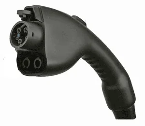

I would just flip the breaker on the charger and usese something "easy to wield" to cut off the legs around the DC section of the plug ("Artist" rendering below LOL )
Yeah, I suppose making sure nothing was on the DC side is a good idea!
Agreed on the CCS1 to NACS -> NACS to J1772 rig up but would go with something that would support 80 Amps and, like you said, not be too heavy to seat correctly. The advantage would be once could charge vehicles with NACS.
Prablably would fill the 2 DC holes with a good grade of silicone caulk too.

3) a great option, though, is a 240v ADJUSTABLE 30amp EVSE, which allows you to CHANGE the amperage to BELOW 30amps, such as 24amps, giving you the ability to use this at your HOME, with your 'spare' 30amp breaker, but the ability to dial it back up later, if you install a NEMA14-50, etc.
