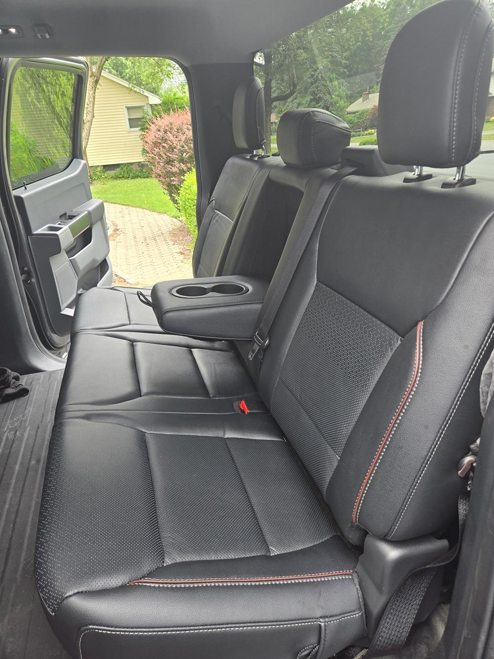

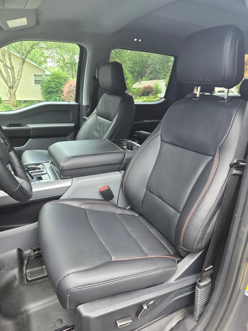

Hi all,
Very excited to get this project done! I'm coming from a Jeep Cherokee Limited, that had very nice leather seats and although the vinyl seats in the Pro weren't as bad as I'd thought they'd be, I've wanted to upgrade them since day 1.
There are some ebay sellers who sell new leather take offs from Lariat trucks. I'm fairly certain the sellers are Katzkin installers as the seats were delivered in a katzkin box. These take offs are incredibly cheap. I purchased mine for $165 and they look brand new. An important note is that the take offs are for Lariat trucks that have a rear fold out cupholder/armrest. The backseat of our Pro does not, but you can get the piece sewed in or purchase it sewed in for another hundred dollars or so. I'm not a fan of how that looks though.
I also wanted to upgrade the driver and passenger seat to a 10 way powered seat. This wasn't as straight forward, but I was able to find a scrap yard that were selling the driver, passenger, and back seat with the fold out cupholders from a 2021 F-150 for $400 total. The seats had airbags deployed and were in rough shape, but it didn't matter. I was able to transfer the airbags from my seats over.
Some notes:
  • The powered drivers seat was plug and play, but the passenger seat wiring harness is missing the pin for the powered seat for some reason. I was able to tap into the 12v line that the drivers seat has and jump it over to pin 21 on the wiring harness on the passenger side.
  • I was planning on reusing the cushions from my seats as they are pretty much new with little usage. The cushions on the seats from the scrap yard were considerably more dense though and I think they would wear better than the lighter, squishier cushions from my seats. After the install, they are considerably more comfortable. I'm wondering if all new f-150 cushions are this way or if they made cheaper cushions for the Pro model.
  • This take A LOT of time, but you can do it yourself. There are plenty of youtube tutorials on how to do it. I would plan for 2 full days, if you've never done it before.
  • The takeoffs have holes for ventilation. I did not choose to add ventilation, but I might look into adding aftermarket fans.
Ford F-150 Lightning Lariat Powered Seats install in 2023 Lightning Pro for under $600 20240623_122620

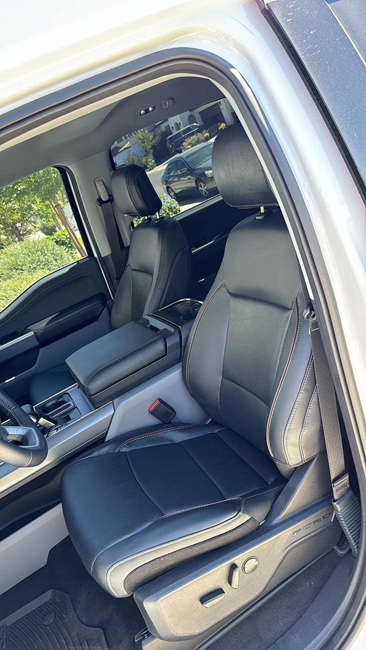

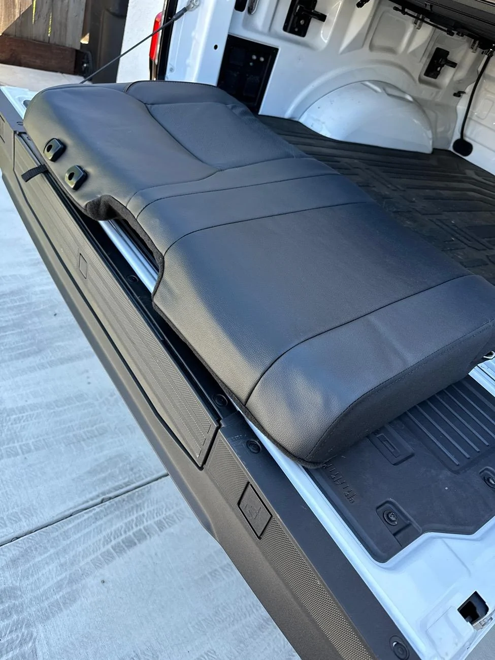

Man I just did the lariat takes offs in my XLT and I would really love to have the armrest in the back seats

Front seats look great!
Funny that I think I'd prefer the XLT seats. Maybe I should look into takeoffs from takeoffs like yours!

Honestly, I thought I would be happy with the cloth seats but Everytime I got in another vehicle with leather I just wanted leather again. Like all my other previous cars.

Looks good! Not sure I want to tell you this, but you have the bottoms of the front seats on the wrong seats. The felt side should face the center console... I did the same thing and was so frustrated when I found out.
makes sense! I keep having the clips come un done. I guess I need to redo the bottoms which isn’t the end of the world
