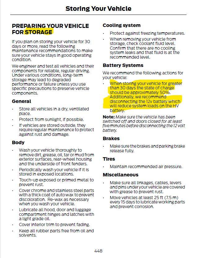

I just had mine sitting for almost a month while traveling, temperatures mostly between 40 and 70 F. Didn't lose any noticeable charge.
On a related note, I store my truck in an unheated but below grade garage for most of the winter. It rarely if ever goes below freezing, usually staying in the mid-40's. The post above from the Ford manual recommends disconnecting the 12V battery. However when I stored it last winter, I left the battery connected and on a Noco battery tender. Seemed to work fine and SOC was still at the 50% I stored it at almost 4 months earlier.
Which leads to my question. Is one method clearly better than the other, or does it not matter?
