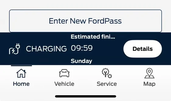

Unlikely the adapter drained the 12V.
Most likely your phone or keys were close by to keep the car awake ?
Next time check on the charger by using your app.

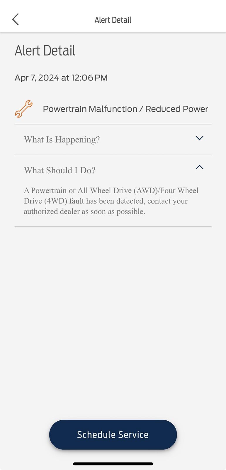

This is the alert the Ford Pass is giving me now:

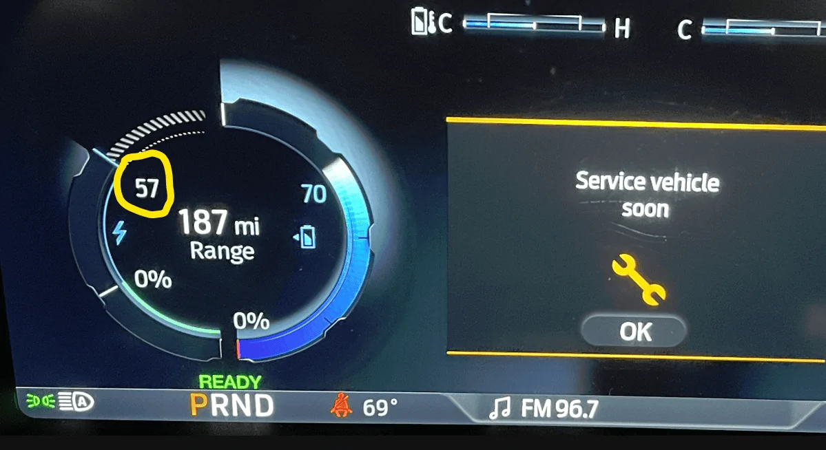

How much has your power been reduced (see yellow circle below)? Seems like many of us who have gotten this error, had power reduced to 54-57% and we had a bad battery module. If you have CarScenner, it will tell you the DTC.
I didnā€™t notice that reduced power thing. Iā€™d check now but I had to ditch the truck at home and take the wifeā€™s ICE car because I headed 4 hours up into northern VT for the eclipse and couldnā€™t risk the lightning.
Hopefully I can get the dealer to figure it out when I get back.
