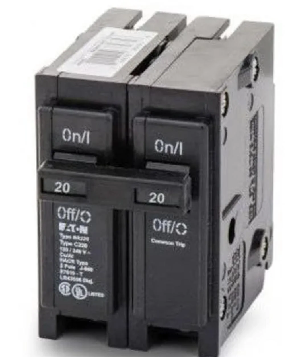

Double 20's? Your running 2 20 amp 220v circuits in parallel?
It takes the place of two separate 20 amp breaker slots, in my case had two 20s repurposed. It's an Eaton BR220
20A 2-pole.
20A 2-pole.
With this breaker you will only be able to charge at 16 amps (80 percent continuous load for the circuit). This would be appropriate for 12 guage wire. 240V x 16amps is 3.8kW. It will take a long time to charge. If the wiring is 10g you could put a 30amp double pole breaker in and be good for 24amps 5.7kw, 8 guage is good for 40amp breaker (32 amp continuous =7.7kw). See an electrician for more details on what you need to do to upgrade.
Absolutely, ours is 8 ga. THHN with 8' run from the Service panel so very limited wattage loss. It serves the Mach E with it's 98kwh pack just fine. We have solar as well and we'll be installing the charge station pro for it's Backup power capabilities. Although, our 20kw Nat. Gas generator should still have 3-5 years of serviceable live left and thus may not need to use the Lightning but I want that capability. Bottom line, the charger that comes with the truck will meet most needs.
