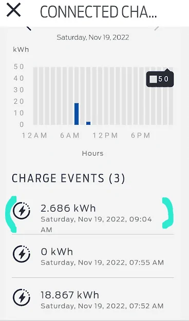

This mornings energy consumption of 2.686 kWh while pre-conditioning from 8:45 to 9:00, (note the cloud server is still on EDT, real current EST was 7:45 to 8:00), I had the MAX Heat switch on as of last shutdown
Note the 18.867 kWh is the final load of charging from last nights cold weather endurance run, I mention in another thread, that was 77% to 90%, it actually finished around 12:35 am early this morning, but the truck does not report to the mothership until the CCS-1 / J-1772 connection is removed.
Thanks for this post! …great to know. Best real world gestimate of the power draw of the cabin heat/Climate system I’ve seen to date:
~179.067 W/min. or ~10.744 kWh ; or, ~8.2% of the usable ER battery if I have my math/logic correct?​

10744 watts / 240 volts ~ 45 amps mean draw during that 15 minute period.
