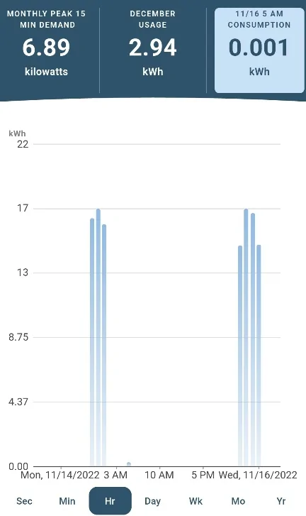

Yes, it's a detached garage on an exclusive service, (got my first bill yesterday for kWh accumulated from 9/30 to 11/15) and I agree the FCSP app is woefully inadequate for data geeks like us, but that's all I have to work with.
You could put an Emporia Vue2 on your FCSP feed. If you charge over 65 amp I wouldn't recommend the 50a leads. They won't be accurate. I purchased a seperate unit and used the main 200a leads for mine.

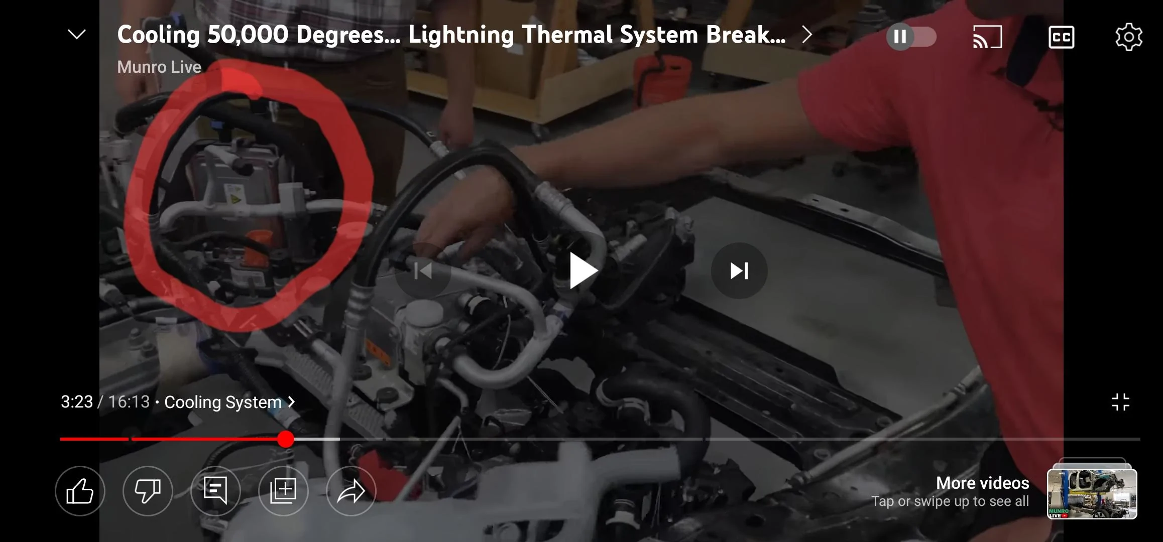

I'm surprised that Munro didn't cover this in their overview of the thermal system (especially since they spent 5 minutes talking about how many coolant reservoirs there were), but you can make out the PTC heater at several points in the video, including here. It looks exacly like the one in the Mach-E. It's hard to tell if there's a second PTC somewhere else. It will be cool to see how it actually works once the service manuals start leaking out.
Thanks for your insights…I agree with you they probably modified the engineering from the Mach-E. I too was surprised Munro didn’t cover this more in-depth….hopefully in a future segment??
