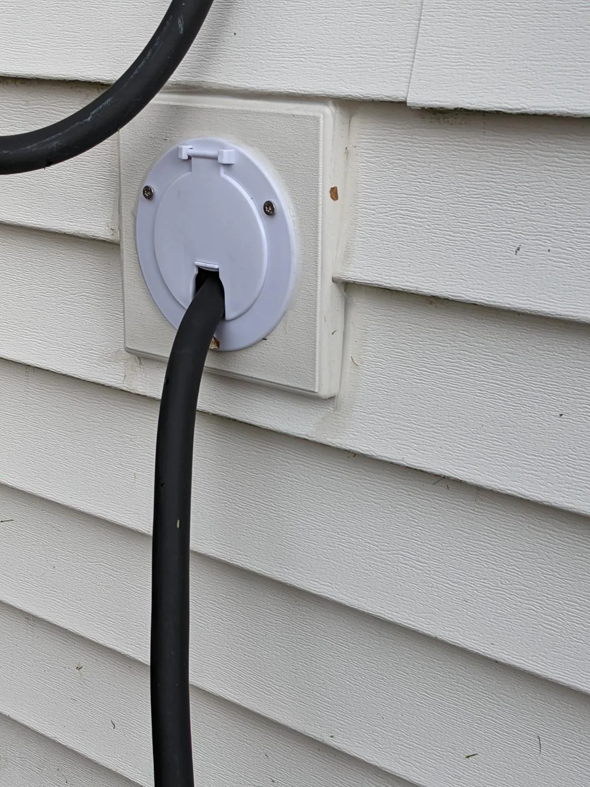

Anyone know of a similar stainless/metal hatch? Locking ā€˜peephole?

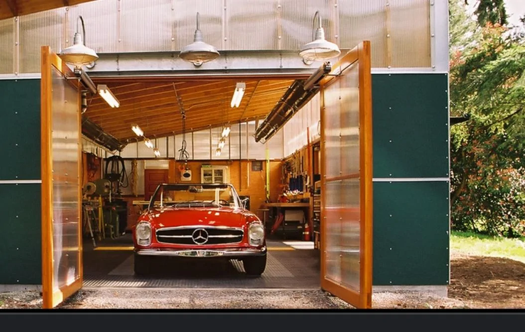

If the front or rear of truck is touching the front/ backwall and it is drywall, frame it out like a window (cripple studs, header, etc.).and cut out the drywall on the inside of the garage. Depending on whether you have 2x4 or 2x6, you'll easily get another few inches out of it, more than you need it.
You can also put Carriage Doors on the Garages, that will get you another 7-10 inches as they open and shut to the outside of the Garage opening.
Ford F-150 Lightning Lightning bigger than my garage! Screenshot_2022-05-23-23-28-18-56_40deb401b9ffe8e1df2f1cc5ba480b12

With an outdoor enclosure on the outlet, I hope?
