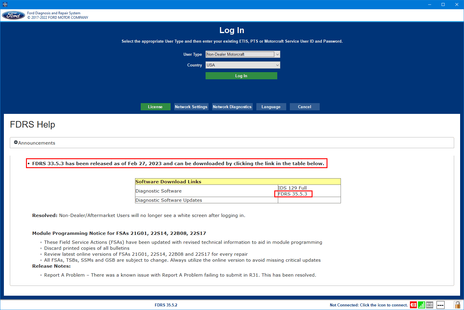

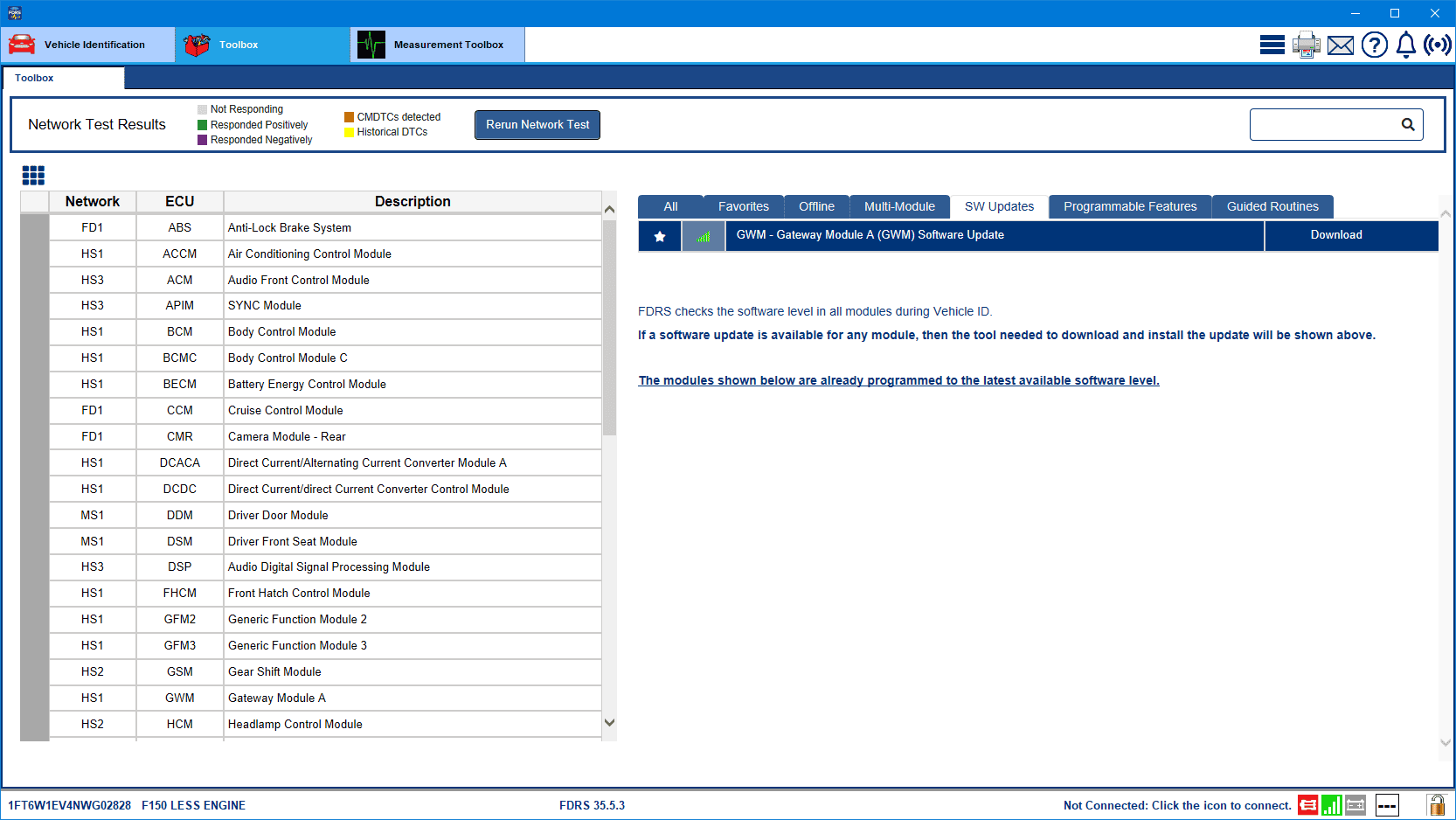

It's been a little while but I woke up to both a new FDRS update and a GWM (gateway) update this morning.
It's likely this GWM update is the Lightning version of the GWM update that came out in the last week for the Mach-E.
Ford F-150 Lightning Lightning Software Updates using FDRS FDRS_35.5.3
Ford F-150 Lightning Lightning Software Updates using FDRS Lightning_GWM-27-Feb-23
And before anyone asks :) after I updated my Mach-E there was nothing notable or visible in the way of changes or performance. It could be an update that is intended to correct some issue, and it could also be an update that is laying the groundwork for a future update (like an APIM/Sync update). An OTA version of this GWM update has not yet been recorded in the wild for the Mach-E as of this date.
If you already had a GWM update in your list prior to today...it likely would get superseded by this version instead at the time it would be applied.
