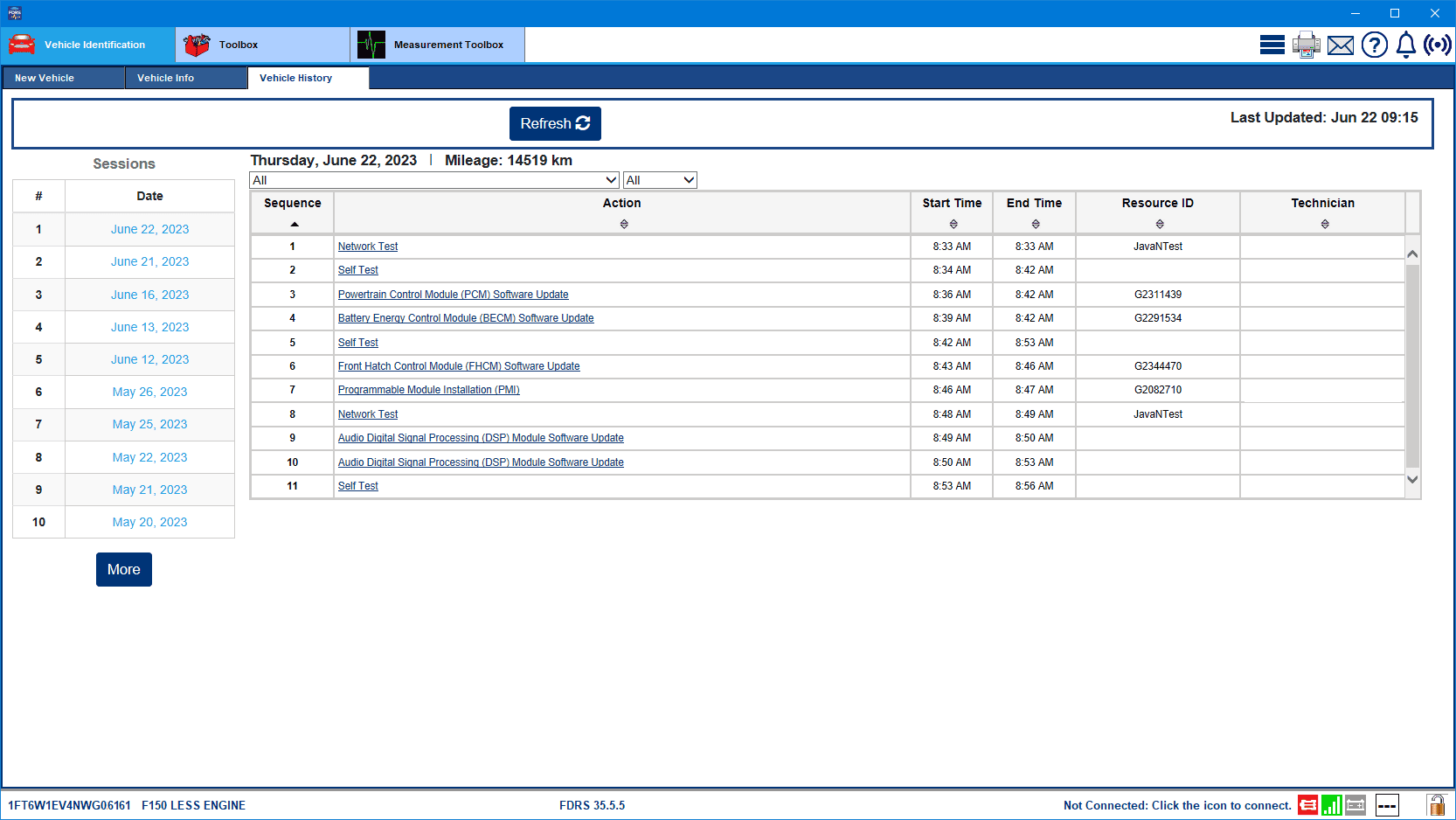

Did the updates this morning but couldn't get the DSP to go away even after a PMI (as suggested by my local Ford senior tech). In fact the DSP update doesn't even bother to try to replace the software, it apparently thinks the correct version is already installed and just pretty much jumps to the configuration phase of the process. You can see in the session log where I tried to do the PMI, and then tried without success to re-do the updates again. Still no joy.
On the upside the other modules; PCM, BECM, and FHCM, went without a hitch.
Ford F-150 Lightning Lightning Software Updates using FDRS Lightning_Updates_22-Jun-23Work

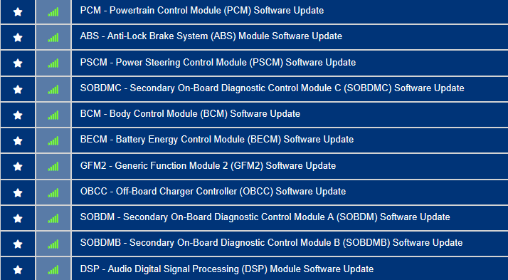

I've posted the BMS learned values reset procedure to ensure your 12V battery is fully recharging when you drive. That should mitigate the low 12V battery problem you were having with OTAs not processing.
Here's the list of your currently available software updates:
Ford F-150 Lightning Lightning Software Updates using FDRS 1FTVW1EV0PWG06095-29-Jun-23
If you are also having problems with your preconditioning not working the attached TSB should be of some interest to you since it would provide your dealer tech the necessary procedural path to getting most of these updates done on Ford's dime (under warranty).
