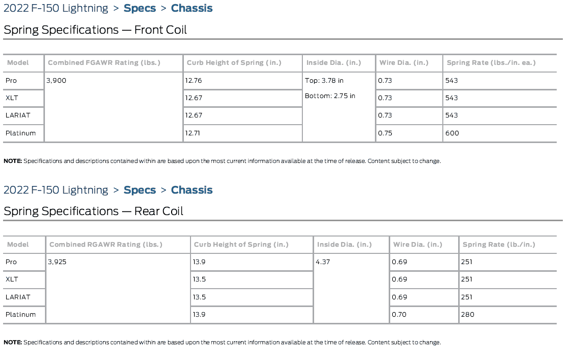

One thing I noticed too, is that the spring rates on the Platinum and the Lariat are different. That could also affect the ride somewhat.
This is an interesting find. I wouldn't have expected that, but will be interesting to know the true difference in parts and ride/drive.
Do you have the spring rates for the different trucks? I thought I'd seen them somewhere but couldn't find them when I searched recently.
I'd have thought the spring rates would be different for the SR and ER trucks, but not between Platinum and Lariat.

It was listed in the e-source book for the Lightning. Took me a bit to find it, but here it is.
I had the part numbers too and I copied the data from Oasis, but I don't have access anymore and I am not sure where I put it.
Interesting that the platinum gets stiffer springs, is it really that much heavier than a Lariat ER? I am actually planning to stiffen the front springs and shocks on mine, with bilstein 6112 coilovers that come with stiffer springs and ride height adjustment. Made for ICE F150's but we know they will fit.

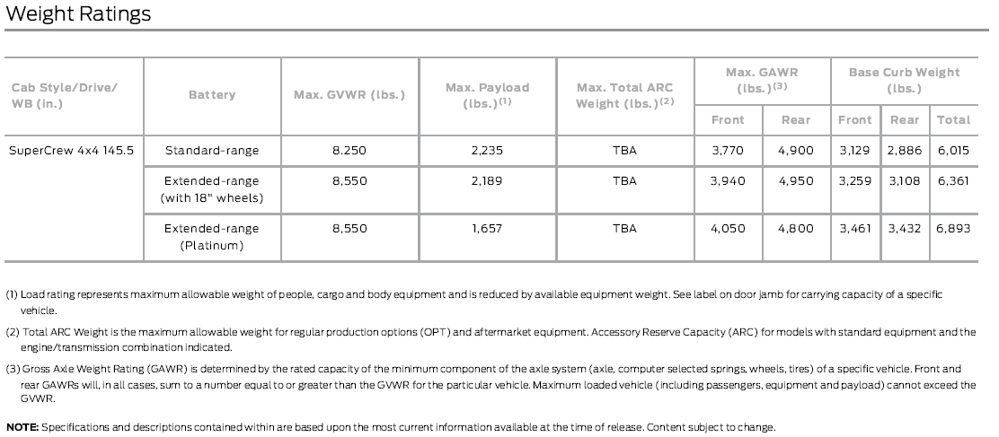

Bilstein 47-323841 Bilstein B8 6112 Suspension Kits | Summit Racing
It is a bit heavier as I recall, but I wonder if the wheels and wheel size have anything to do with it. I believe the both additional weight but moreso wheel size is why the Platinumhas less range than a Lariat
Due to tires and rims I think. Plus other things in the truck related to it being a Platinum.
Also, from a base stand point, the Platinum appears to be more a balanced 50/50 truck.

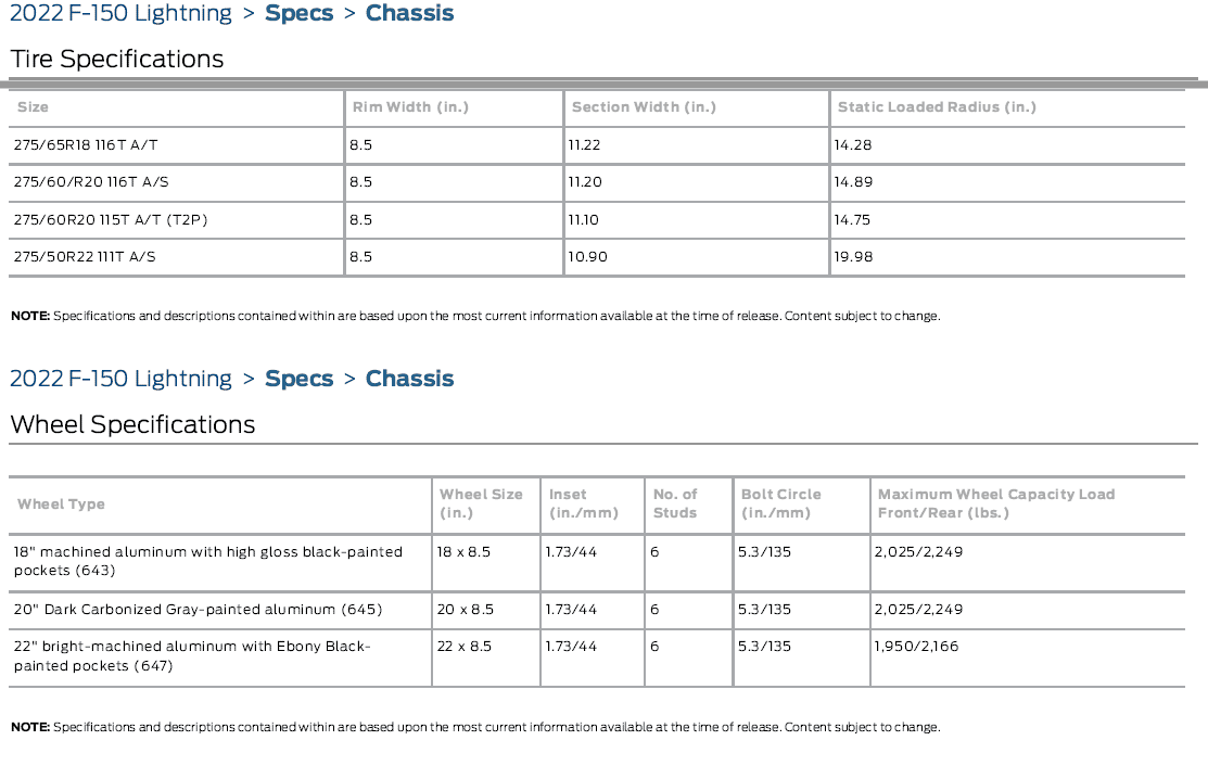

Tires and wheels are unsprung weight so I would not think they are the reason for the stiffer springs on the Platinum, but that's all I got. I suppose during a suspension impact the wheel/tire combo gets tossed around, and more mass means more energy to damp, but changing the spring rate for that presumably small change really seems like the tail is wagging the dog. Does anyone know if the Platinum uses the same shocks as well? I'm just baffled that the SR and ER trucks use the same suspension.

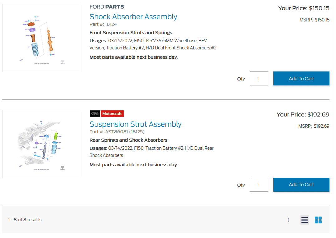

I did a search on Ford Parts, and based on a VIN of my Platinum, and another VIN which is a Extended Range Lariat - they look the same. However if you notice "Traction Battery #2" so there might be a different version for a none ER version.
Ford F-150 Lightning Lightning suspension comparison to current F-150? plat
beatle
Jun 1, 2021
885
992
Springfield, VA
What's that site? We could snag a SR VIN from one of the reservation threads and put it through that same query.
