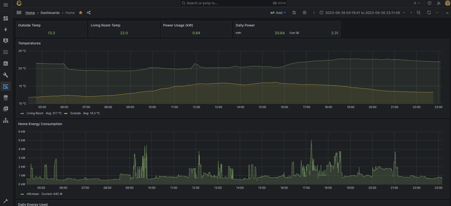

Here is a screenshot of what my current dashboard looks like
