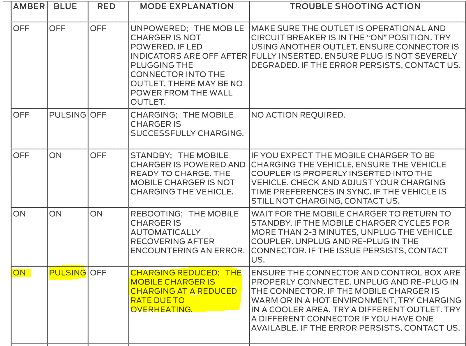

For the last few days, I’ve been charging at 3KW. The light on the far left of the mobile charger is amber, other is blue.
I put a meter on it and it is getting 240v.
I put on a different charger and outlet and that works fine.
It’s been in the mid 90s outside. Is it possible that it is charging at a reduced rate because of the heat?

Does the mobile charger feel warm to the touch? Is the charger itself sitting in direct sunlight? If you unplug the mobile charger and cool it down (say in the house) then will it start charging correctly for a time? If you still get errors and it doesn't work properly then perhaps it is defective.

It is never in the sun. It was extremely hot to the touch. I brought it in for an hour or so and then replugged in. Operated at 6KW for about 20 min and then it went back down to 3KW.

No, it is not odd, because a lot of people are having this issue at much lower temps. It is not built for everyday use. It's under warranty, take a video of it with the amber light, and ask for a warranty replacement.

The ford one works just fine, you can use it daily if need be. The biggest problem is people not plugging the dongle in all the way. Also check your 14-50 receptacle could be sloppy.
If everything is plugged normally then it could be an internal evse problem. Try on 120v see if it happens too.

Used my Ford mobile charger from Nov. when I picked the truck up, to a few weeks ago when mine struggled to go above 3KW. It wasn't until the temps reached the 90's that it began happening. Even on the coldest days during the winter here in NH, it never dipped below 6kw. Based on the advice from several people on this forum who are much smarter than I, I bought an Emporia and it has been a major upgrade. Steady 9kw every day regardless of temp. Highly recommend
