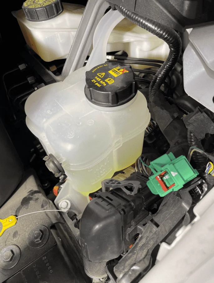

No overheating, but the coolant level on my new Lightning was delivered from the factory at the minimum level. I had it topped off by the dealer during a visit for other warranty items.
Mine was too, very low indeed. Just filled it up and it's been fine ever since. I hope that's the worst thing I have to deal with :)

Next I shut the truck off, got out and looked under the hood at the coolant reservoir. It’s well below the “min” line, as some others have reported. Checked under the truck and in the garage, no obvious signs of a coolant leak.

There is no level sensor on the truck.
Well. That explains it.
