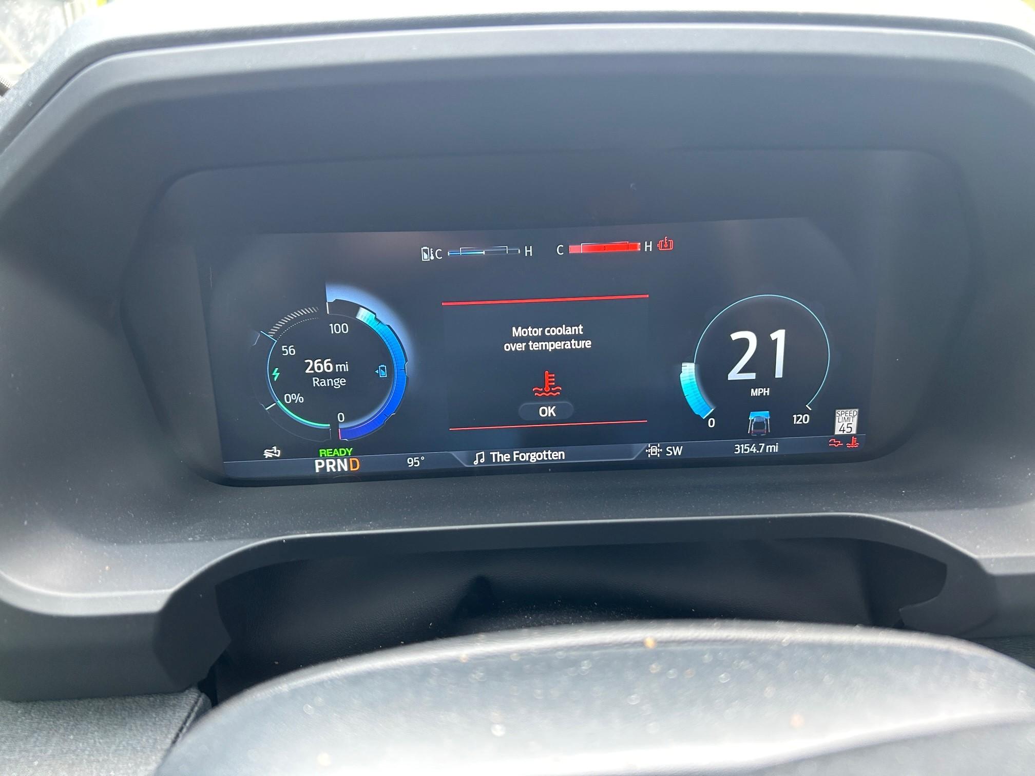

This happened to me today just after a trip to Home Depot. Truck had been sitting in a hot parking lot of about 95 degrees according to the dash for about an hour (motor coolant temp was fine before I entered the store). Here is a screenshot of my dash:
Ford F-150 Lightning "Motor Coolant Over Temperature" overheat 1
I figured it was a sensor error, and so decided to restart to see if that fixed the issue. I only probably left it off for 10 seconds or less before trying the restart. Restart did not fix the issue as the message reappeared.

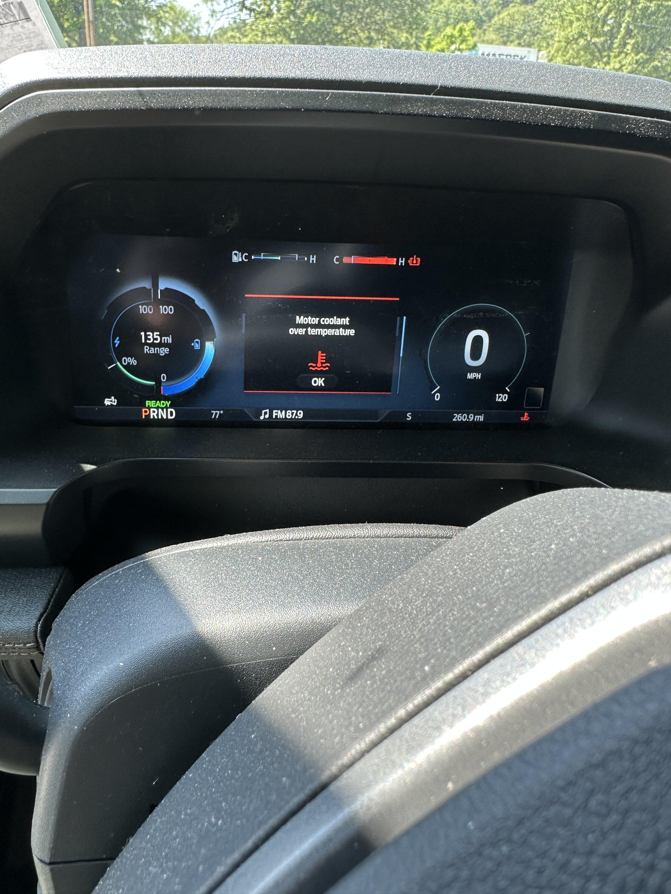

I decided to load up my purchases prior to jumping online to figure out what to do. While loading up the lumber (I had turned the truck on early to open the back window for an exceptionally long piece of cedar timber) the temperature came off of red and went into the yellow zone, and so I decided to give it a go and see if I could make it home. Didn't think to take another picture until temp was almost back in normal range.

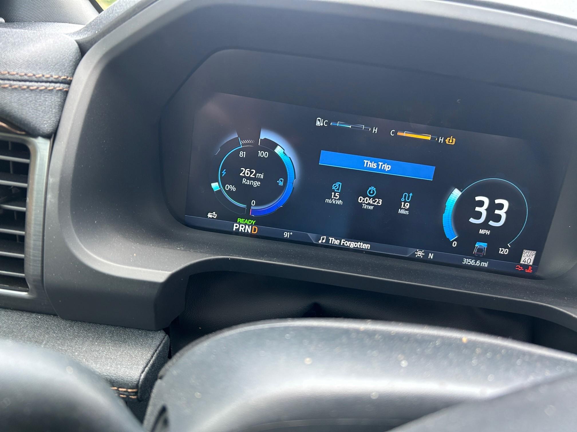

By the time I was in my neighborhood, temp was back within range.
Ford F-150 Lightning "Motor Coolant Over Temperature" overheat 3

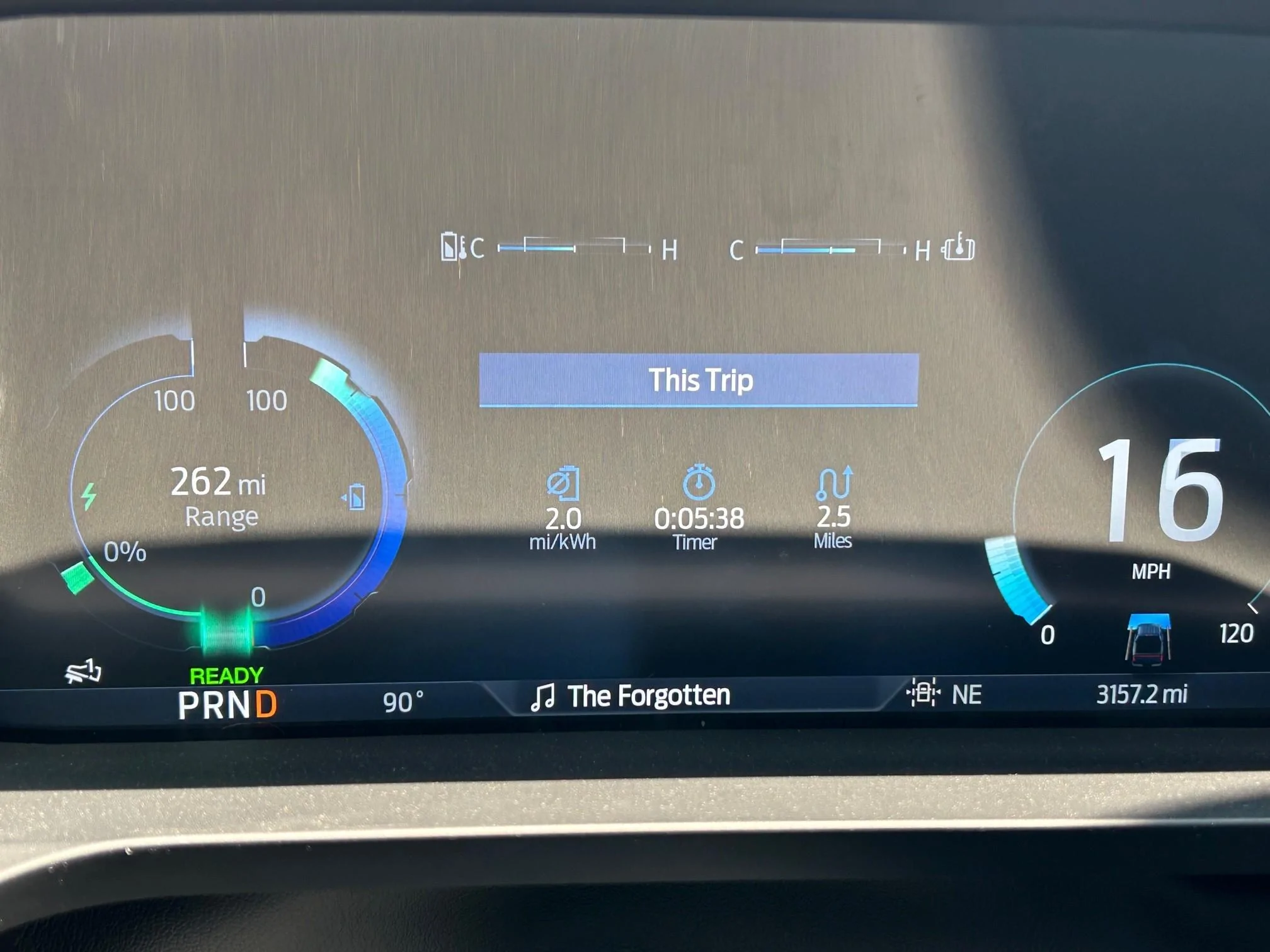

Turned the Lightning off and unloaded, then when I got back in 20 minutes later it was again centered smack dab in the middle of the acceptable range.

Then decided the motor coolant couldn't be overheating, because nothing had been running. Yeah 90+ is hot for us humans, but nothing for engine coolant.
Correct, this is the same software glitch where upon startup it shows over temp and it just doesn't logically make sense. It's fixed in an upcoming update
