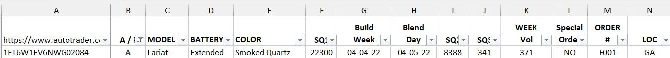

BTW: your truck was on my auto trader tracking project while it was in production:
Ford F-150 Lightning Need help identifying my 2022 Lariat as a Mannequin for 42/42 due to warranty issue 1743100764921-29
Ford F-150 Lightning Need help identifying my 2022 Lariat as a Mannequin for 42/42 due to warranty issue 1743100804486-f
Ford F-150 Lightning Need help identifying my 2022 Lariat as a Mannequin for 42/42 due to warranty issue 1743100850048-ga

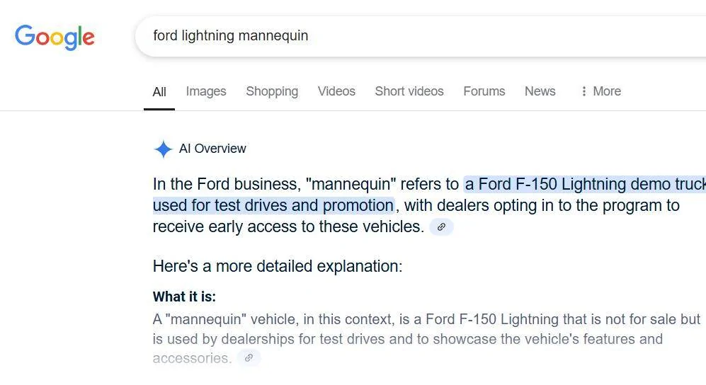

Ford F-150 Lightning Need help identifying my 2022 Lariat as a Mannequin for 42/42 due to warranty issue 1743181726910-8t
Hank42
Jun 19, 2023
139
132
NY
2022 Lariat ER
No you can't tell by VIN per my post, that's what's causing my issues.
The dealer would have known it was a demo/mannequin that they couldn't sell for 6 months and flagged it with Ford giving the owner 42/42 vs 36/36
Yup, sounds like mine, and I'm in the same boat as you - "how do I tell if Ford labeled it a "Demo" truck. Slightly off topic, Are all Lightnings painted white under the hood/frunk?
