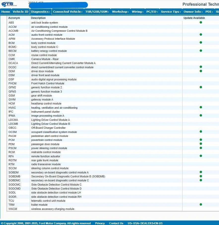

edit: for anyone curious, below is what's showing for his vin.

That's PTS. ~$26+tax for 72 hours. https://www.motorcraftservice.com/Purchase/ViewProduct PM me your vin and i can double check if it's the same or a different error. Think i have another 24 hours or so left.

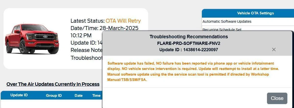

Thanks @PJnc284 for checking on my error. Has anyone seen this type of error on the BlueCruise 1.4 OTA update? Some history, I updated my truck with FDRS on March 21st. The update included the lengthy IPMA module. The OTA error indicates a file type 4 errorcode.

Took delivery of a Mongoose and OBDLink cable last week before the 1.4 OTA updates started flowing and rugedraw was gracious enough to provide me with an update list based on my VIN.
