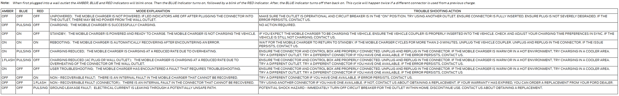

If it is just the amber light that is on, try removing and replacing the 120V dongle from the top of the charger. Error light meanings posted below:

First thing I'd do is take the dongle out and reseat it. It's a bit tough to get it fully seated sometimes and that will cause a fault.

If by chance you live in an older home (built pre-1970) its possible that your outlet may not be grounded. The ford "charger" will not function without a ground. I ran into this problem before installing a dedicated 240v outlet in my 1950's built home.

If you plug in the charger and it doesn't show a blue light, then stop and reset the dongle or try another outlet. Until you get a blue light showing, no sense in plugging it into the truck.

Woohoo!! The truck is now charging. It may take a day or two but it's working. I think the outlet was the problem. Thanks so much from a newbie.
