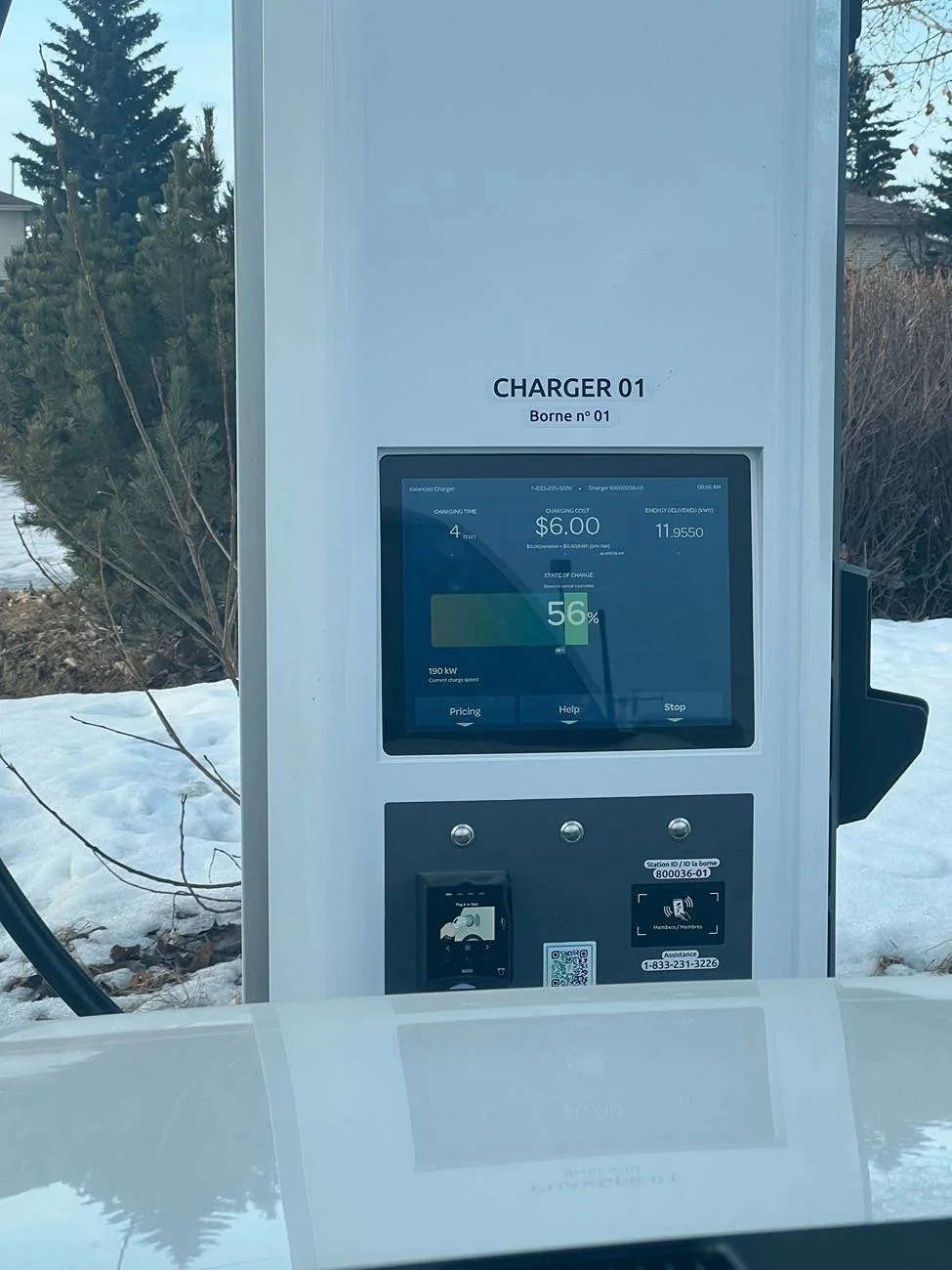

ā€œ8. Most Electrify America DC fast chargers can deliver up to 350kW of power, but your Ford will only accept up to 120kW (SR) or 155kW (ER).ā€
Ford F-150 Lightning Official Charging Recommendations IMG_7022
