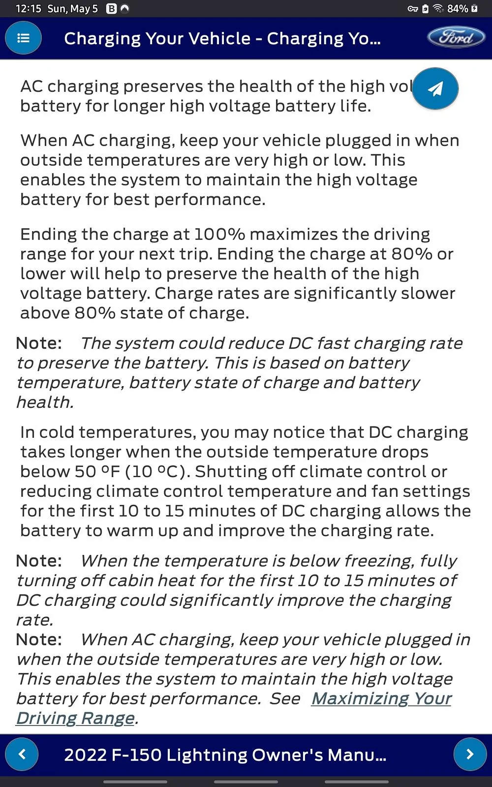

The best thing you can do as a new owner is to set up an account at ford.com. There you can find everything you need to know about your lightning, recalls, costumer satisfaction program, a online manual and lots of other information you will need.
Here's a screenshot:
Ford F-150 Lightning Official Charging Recommendations Screenshot_20240505_121531_Firefox
