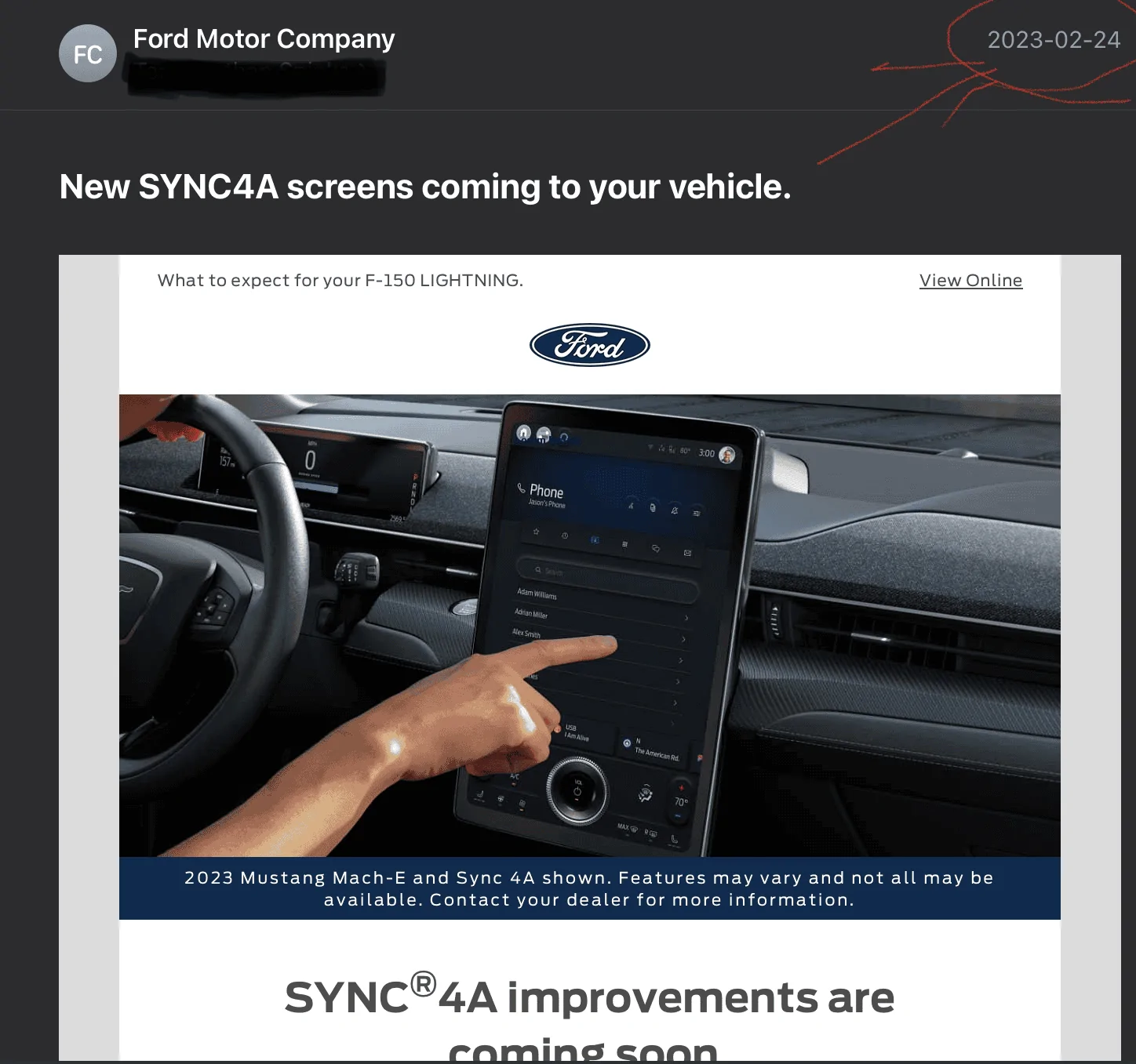

The marketing department got ahead of engineering again. I’m stuck in the no update since 4.1.1 camp. Some people have said that a BMS reset after pulling the neutral so many times may be the cause.
This email aged like milk :)

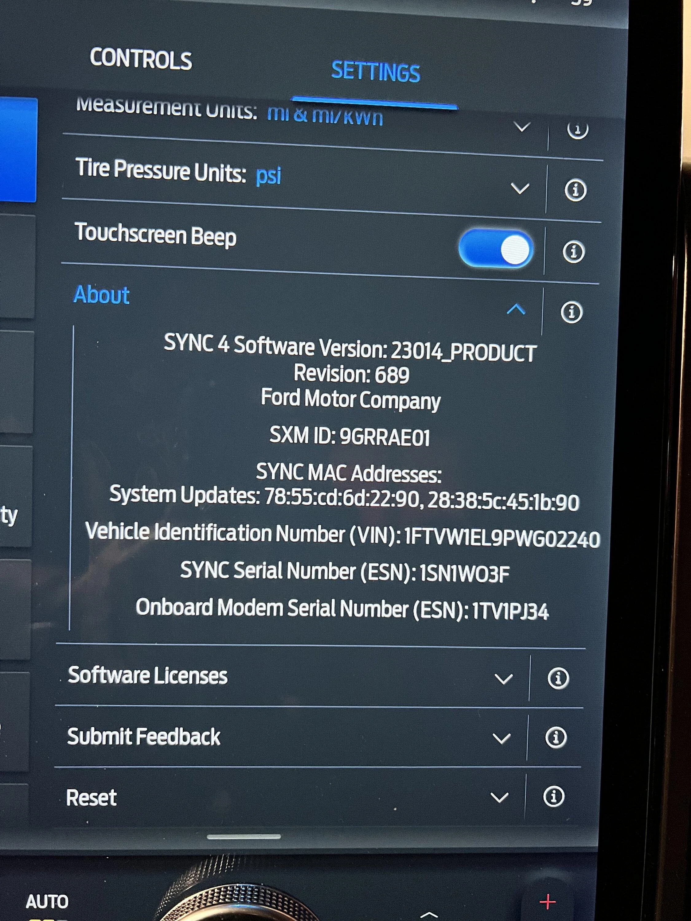

As for checking your Sync version...Settings > General > About and it should say "Revision XXX"

Thanks for the info. It looks like I am running Revision 546.
So for a '23 model that must be the 'intermediate' rev they started the model year off with. That would be comparable with Sync 539 on a '22 model. So it is a rev that's specific to '23 models but really no different to the Sync 539 that '22 models had at the time.

My ‘23 was built 10/25 and I have Sync 689 with the old UI. I did get 4.1.1, 4.1.2.1, and 4.2.1.

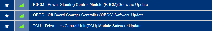

Well if it helps, it looks like you have a TCU update in your list that should come as an OTA while you're out driving around in a 3-bar AT&T coverage area. I would check and set the update schedule to a time when you're likely to be driving the truck (like on a commute).
The last time you ran my VIN I had a GWM, PSCM, OBCC, and an APIM update on the list. I assume the GWM came with 4.2.1 but does that mean I got an APIM update also or did they pull it?
Well they didn't pull any APIM updates as far as I'm aware. Check you Sync About page to see what your version is now.
