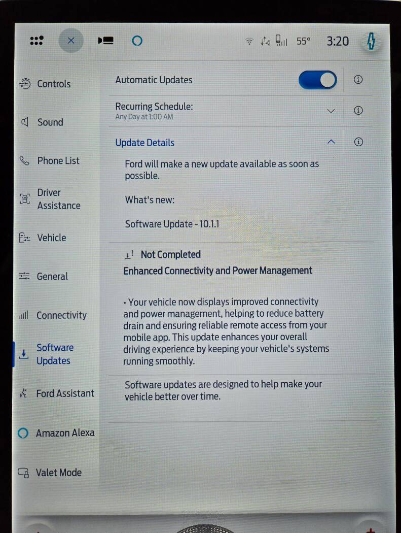

Hi. It's been a month or more that my F150 2024 lariat ER is stuck with update 10.1.1 not completed. Does anyone know how can I fix this issue?

Nothing to fix. Typically this means the file downloaded and the checksum determined the module was already updated. Or in some instances the file download was corrupted.
There is no way to force it. You have to wait for Ford to push the update again or of the update is not needed on your truck you will just get the next one they push.
Keep in mind these are not software versions these are individual module updates. Each truck built at different times means each module can be at different versions and not every truck needs every update.
This is well covered in the forum
