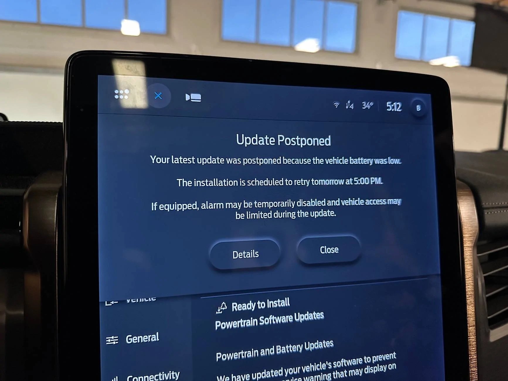

First time I have ever had an update fail. Interesting it clearly stated it was due to vehicle battery (stupid it doesnt say Low voltage battery). My response... pictured below. Gonna try again at 6 CST, currently sitting at 12v SOC of 65% which I would think is good enough.
The good news is it looks like Ford listened to our complaints and is now giving a reason why an inhibit update failed instead of the "update was interrupted by another process".

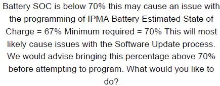

Edit: I would shoot for 70% SOC on the 12V. I was doing FDRS today and got warnings on a few modules if I wanted to do it less than 70% SOC.

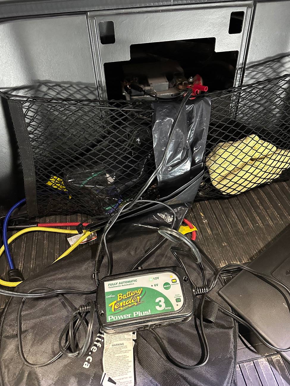

As you are noting the 12V battery does not charge unless the truck is on, or you are actively charging (just having cable plugged in is not enough).
Just turn the truck on for several hours (with the shutdown timer disabled) and it should charge up. I verified this when I replaced my battery sensor monitor. The other option is to turn down the charge rate if you have an adjustable charger, or use your level 1 charger for a while.

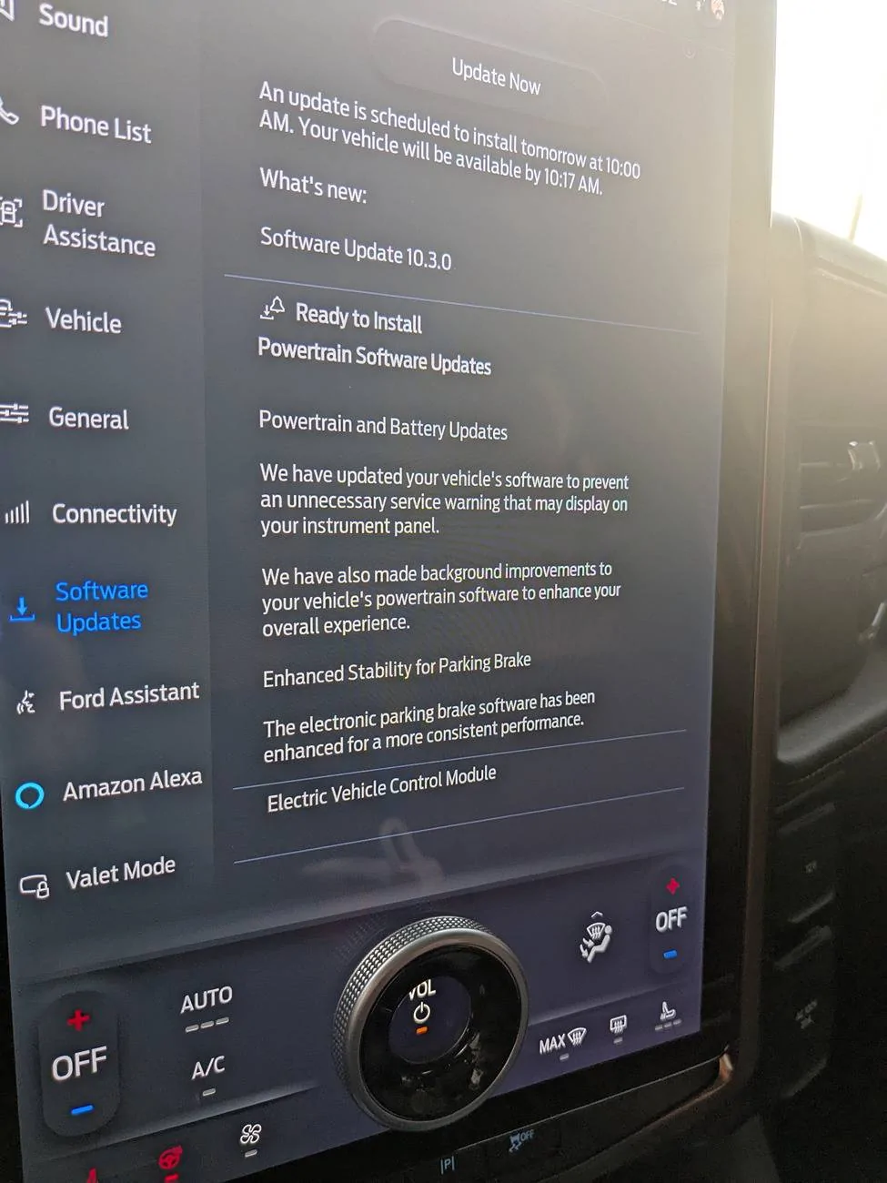

Powertrain Software Updates
Powertrain and Battery Updates
We have updated your vehicle's software to prevent an unnecessary service warning that may display on your instrument panel.
We have also made background improvements to your vehicle's powertrain software to enhance your overall experience.
Enhanced Stability for Parking Brake
The electronic parking brake software has been enhanced for a more consistent performance.
Electric Vehicle Control Module
I thought I was getting BC1.4 😂. Interested to see if parking brake activates more often now and what the powertrain software did.
