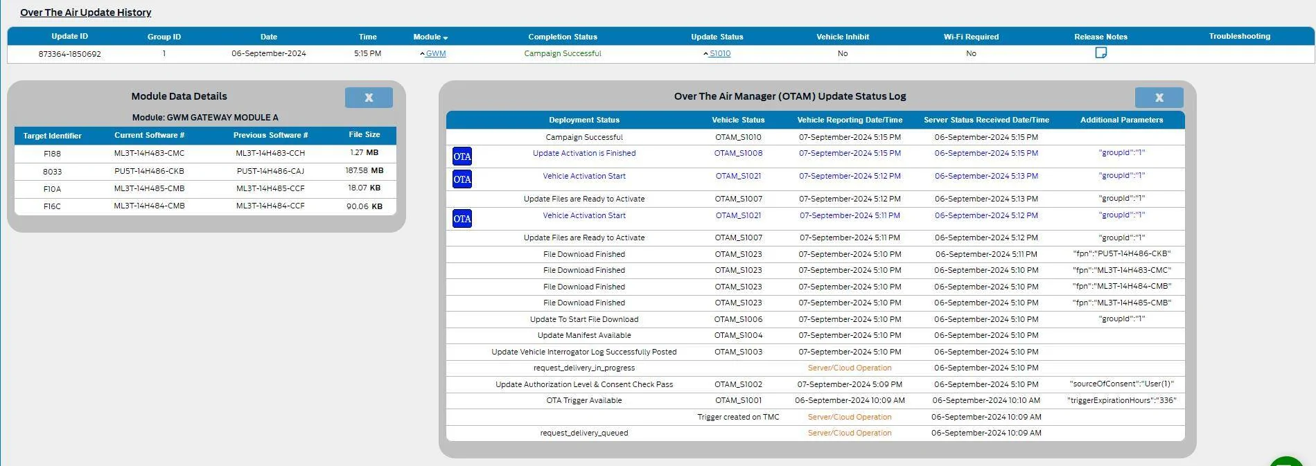

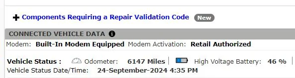

@Firn Got your message. Modem was properly activated; it is not in fleet mode. Vehicle is reporting its status to the cloud consistently including earlier today.
Ford F-150 Lightning Encourage Software Update? 1727233339528-pv
Below it the OTA dashboard showing the update you got on 9/6. Total update size was just under 200MB, and it downloaded all the files in less than a minute. This does not like like a truck that is suffering from poor data conditions to me.
Ford F-150 Lightning Encourage Software Update? 1727233474202-zd
I do not see anything to be concerned about tbh. Just gotta wait for the next one to be sent. Once that happens, if it does not install, lmk and I can check what's going on.
Awesome news, thanks!
