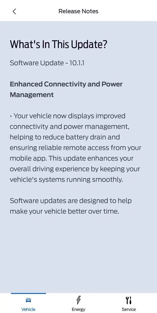

OTA Software Update 10.1.1 - Enhanced Connectivity and Power Management

Do any of you 2022 owners who got the 10.x OTA have NOT had the 24B56 front sensor CSP performed? I read a comment on Reddit this morning that said OTAs are locked out until this CSP is performed. If that has been said on this forum, I missed it. I have held off on getting this CSP done because I do not have great confidence in my local dealer in doing this correctly, and I've seen multiple people post about having their truck bricked because the tech didn't use a 12V power source (or other various reasons). If the thing about having OTAs blocked until that CSP is done, I'll have to take the risk.

2022 here. I have not had the front sensor CSP done but I have the 10.1.0 update
Thanks for that information! Looks like the comment about OTAs being blocked without the CSP being applied is incorrect.
