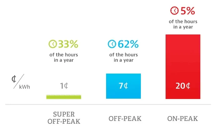

Here's GA POWER's EV Overnight Charge Rate schedule, which is a 'higher' 2pm-7pm rate, and to motivate us to move power usage needs to after 7pm, and even more to EV Charge after 11pm...
(you do need to sign up for this service change, versus the typical residential service of about .13cents per khw for all hours)
PEAK TIMES 2pm-7pm..............20.3¢ per kWh
Off-Peak ..7pm-11pm............. 7¢ per kWh
Super Off-Peak EV CHARGING ..after 11pm.. 1.5¢ per kWh

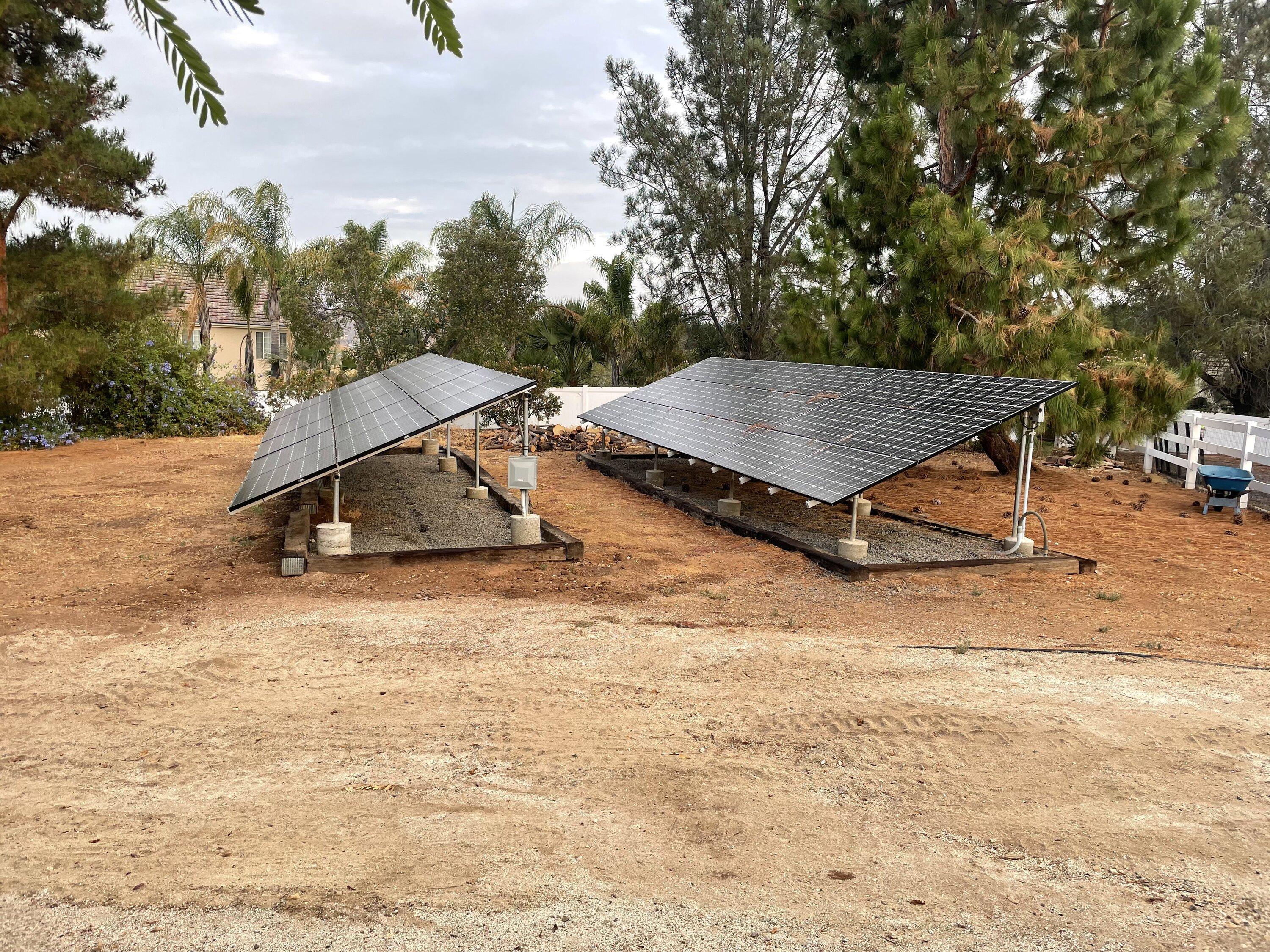

Im here in San Diego where power is expensive ~$.40/KWH. I have 36 panels that are 6-7 years old on a pole ground mount. They are 250 watt panels. I generate an excess of about 250-350KWhr per month which is not going to be enough to support my new truck. I think in the short run I will just pay the Tier one cost of $.40/KWhr but then add some panels as I see how bad the bill turns out to be. I have the room to add maybe another column of 3 panels on the far end to both sets. Another 6 panels at 300watts would give me ~an extra 270KWhr/month. That translates to a total extra monthly capacity of 500-600KWhr which in turn translates to 1200 miles of driving per month- which is probably about right. The other option is that I could swap out my 250watt panels for something with more capacity. Thoughts?

If you have more room it's probably best to keep your old 250W panels for a while. Probably not much market for them and if they are still working then just add some 330 or even 365 watt panels. You could run your new panels with micro-inverters if they don't match up with your existing panel strings.
