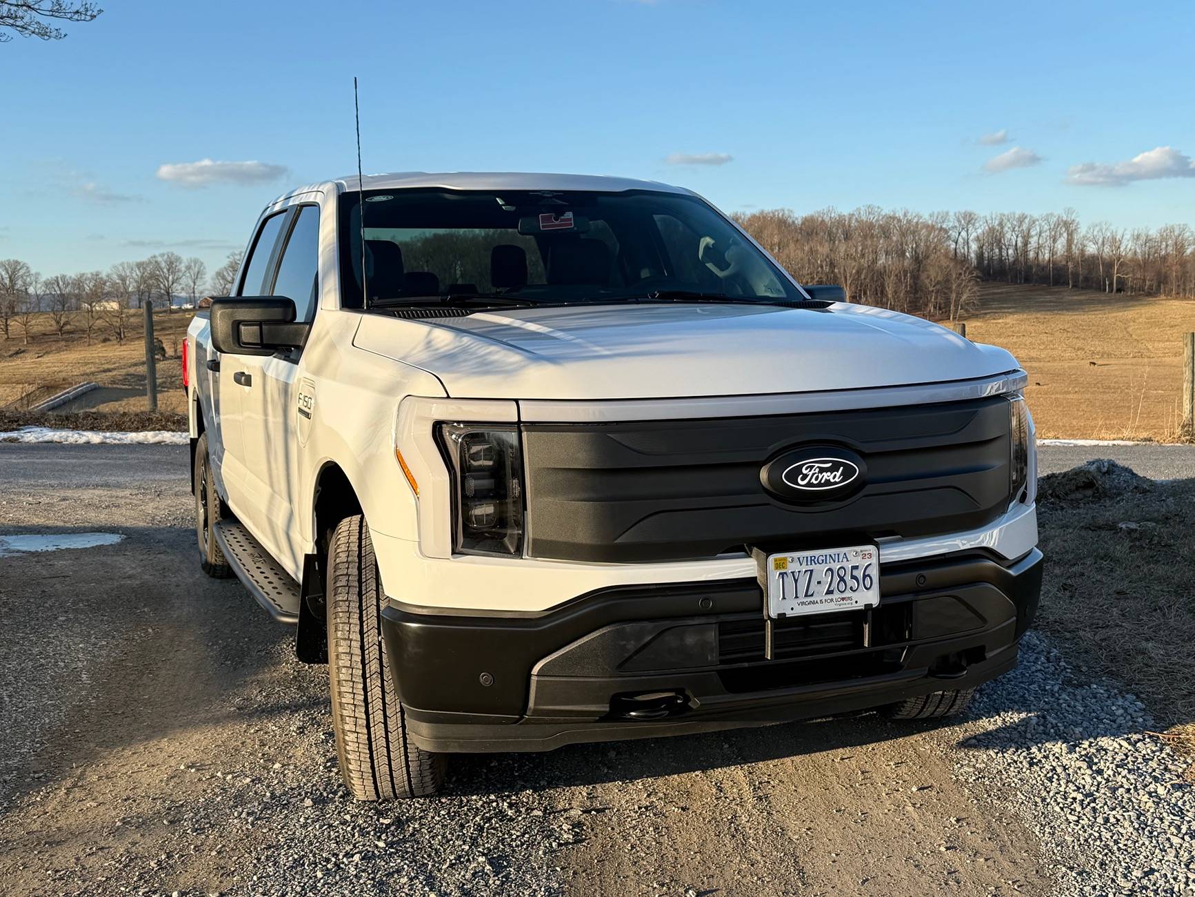

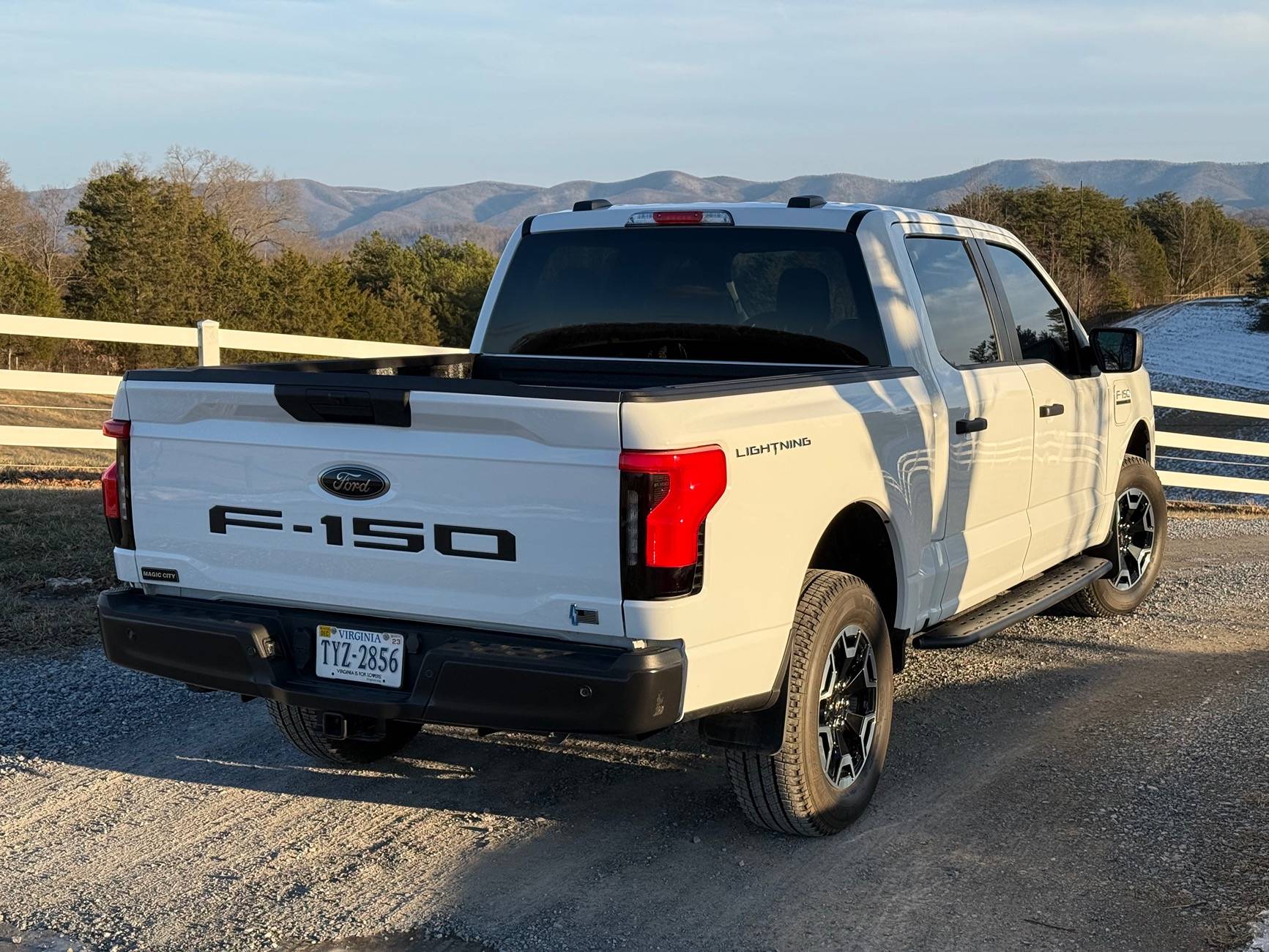

Well, my latest upgrade was delivered by a semi on the interstate when he changed lanes with me next to him. I emergency braked, but wasn’t able to get fully clear, so he destroyed all of my work 😭 it does drive with no issues but will be an extensive repair.
Several long months later, my truck is back from the body shop. A little over $18k in repair costs, luckily everything was covered by the trucking companies insurance.
Happy to say they did a fantastic job and even modified the pro grill to add the light bar back the way I had it.
I also had them update the front bumper with parking sensor cut outs. I don’t believe there is a config with how I have the truck setup to copy set, but I will update with some instructions if I get them working!
