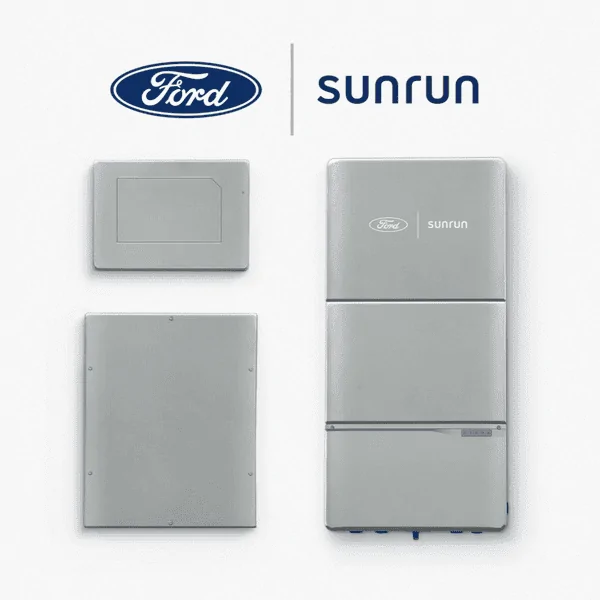

If you're talking about the backup power that sends power from the truck to your house, you need a lot more hardware than just the Charge Station Pro.

You need all these parts, if they are installed, and the commissioning process was completed, then it should work.
