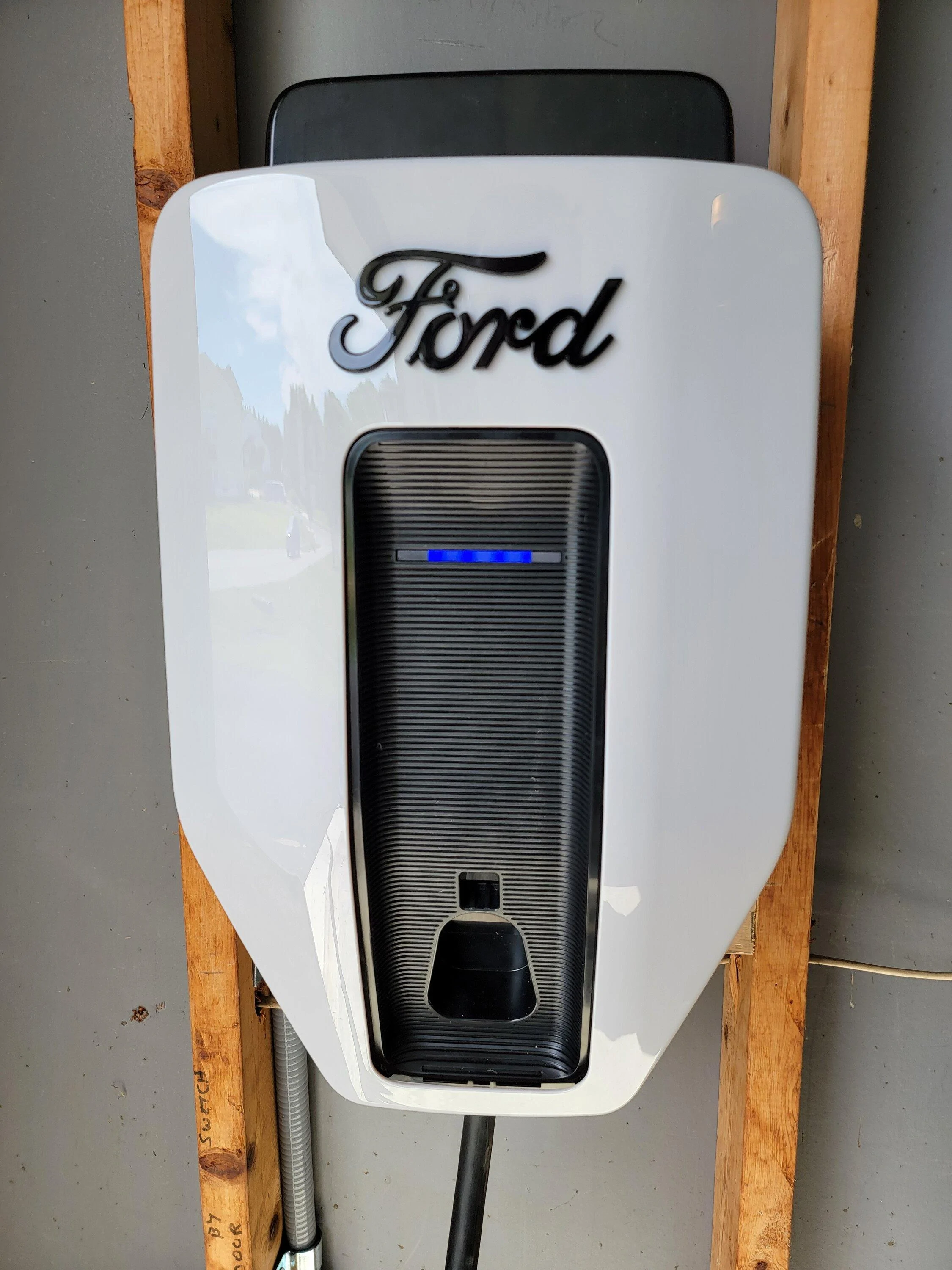

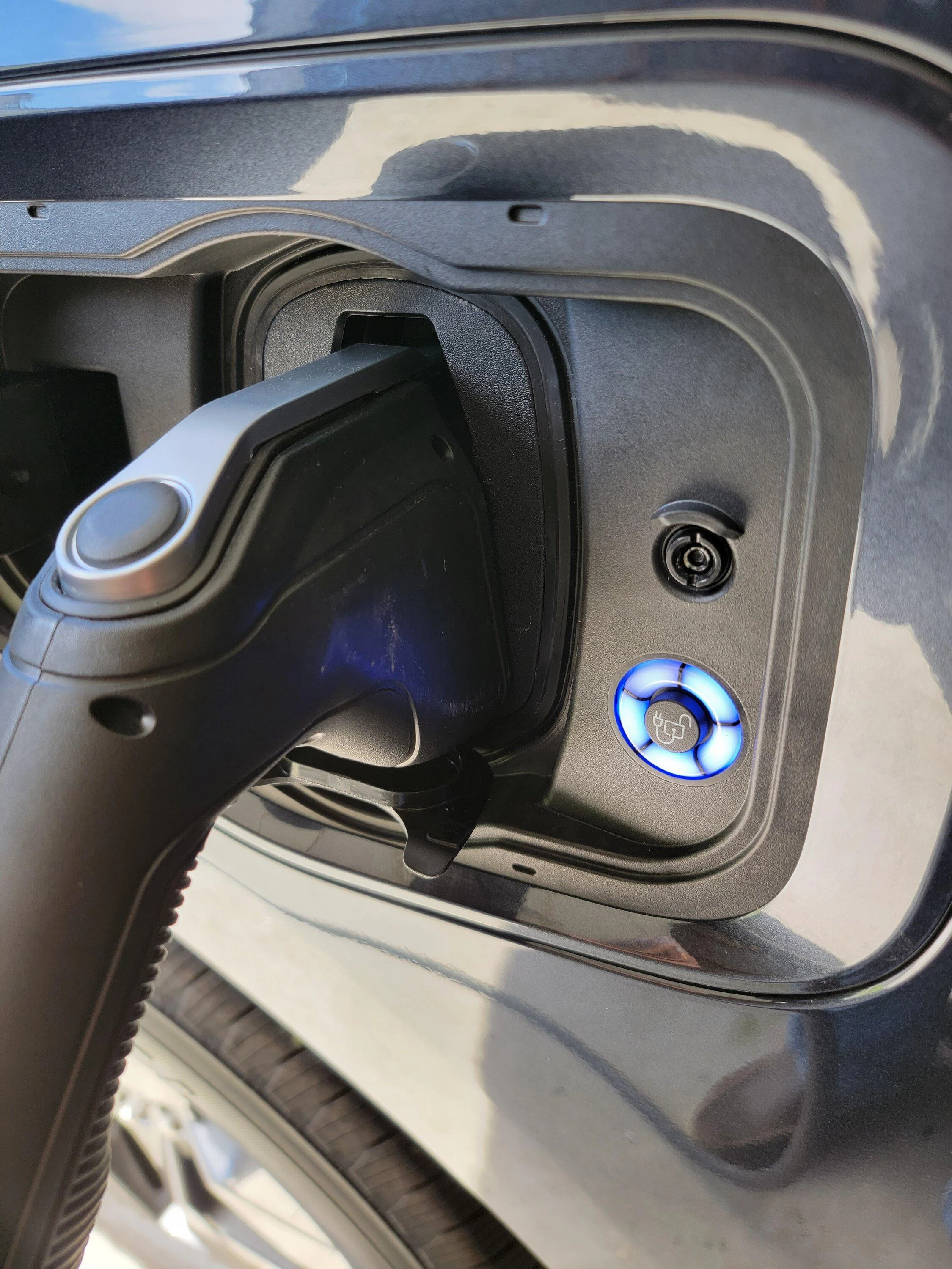

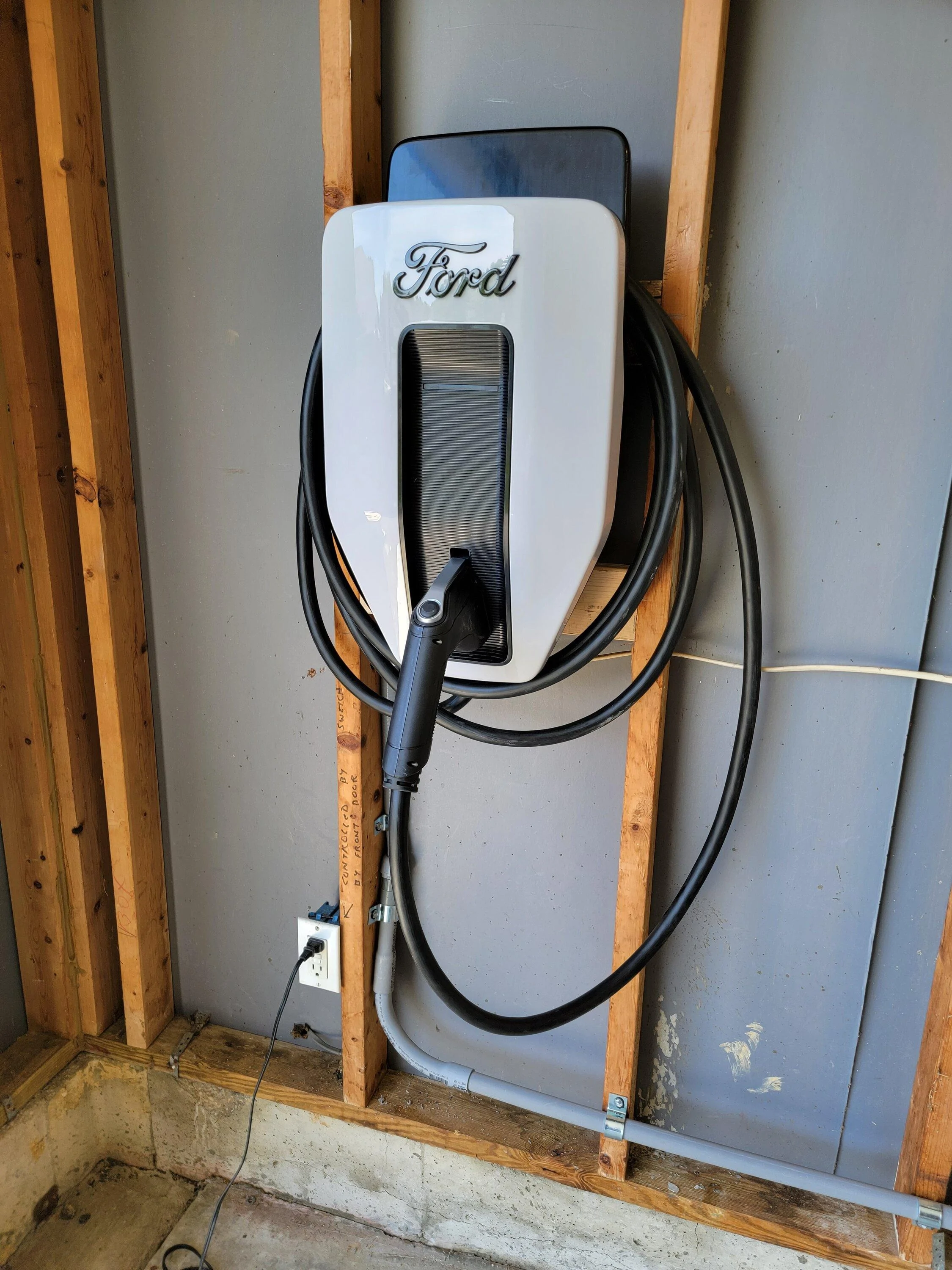

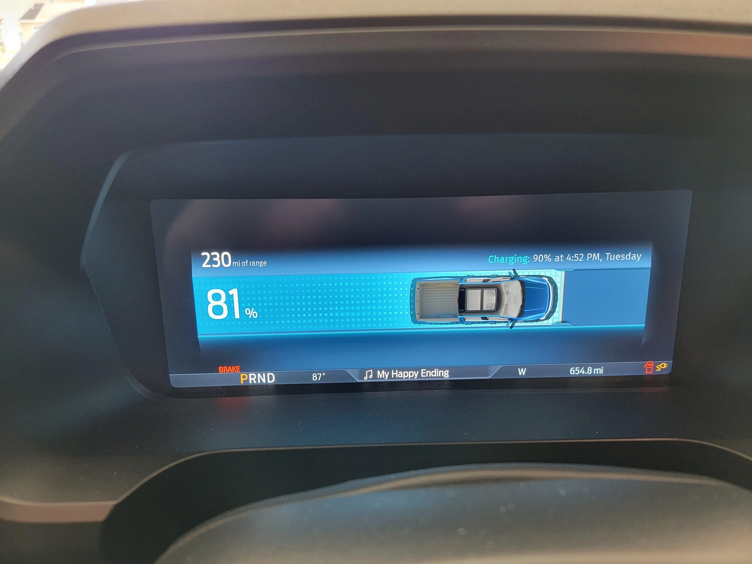

Charger installed by SunRun subcontractor and charging at 80A!! :cool:
Ford Pass App and the FCSP setup app not connecting :mad: The charge station is not visible in the app. I have tried cycling the power, an Android device, an Apple device, tried adding it manually without the setup app, etc. Nada...nothing. This is likely not an install issue since it is working just fine. If anyone has any insight or has dealt with this issue, I would love to hear the solution.

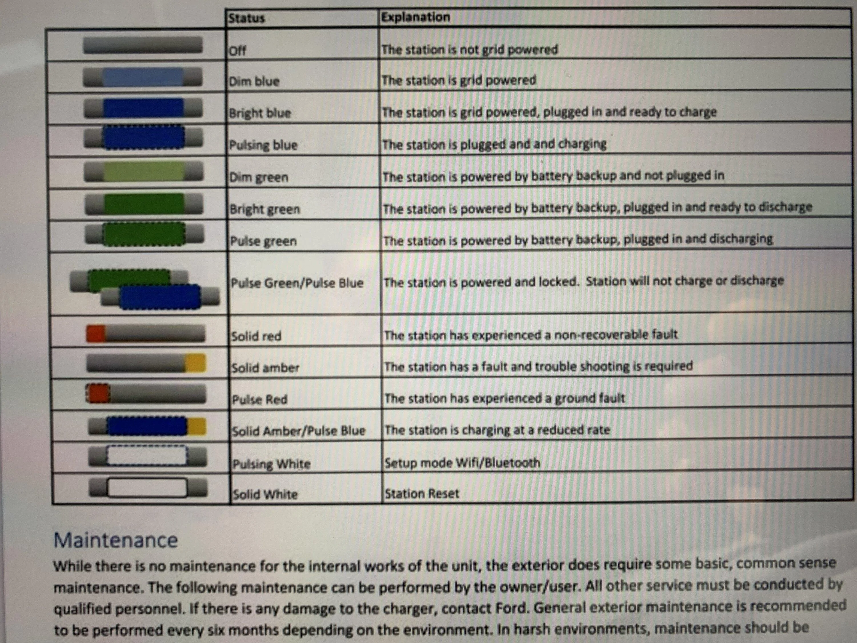

Are you getting (pulsing white )on the ford wall charger. See attached photo.
if you are getting the pulsing white light, log on your ford pass app, go to account..upper right.
then to charge station.
hit getting started..
select charging station
follow instructions
let me know if that works.
