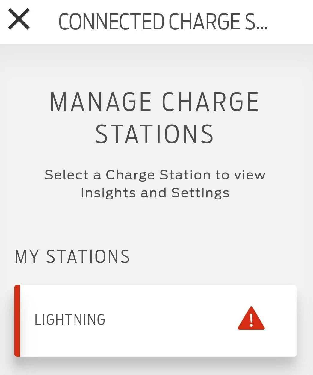

Once you've got the configuration set, yet later it seems to malfunction, just do a power cycle routine and wait a while, don't re-do the initial configuration process.
Most of the failures I've had are resolved with a simple power cycle, which triggers the FCSP to resume taking to the cloud server at Ford, eventually online status reappears on your FORDPASS, if your lucky cached data might also post, but most of the time it's lost.
188
14,187
15,338
Looks like I need to cycle her again.

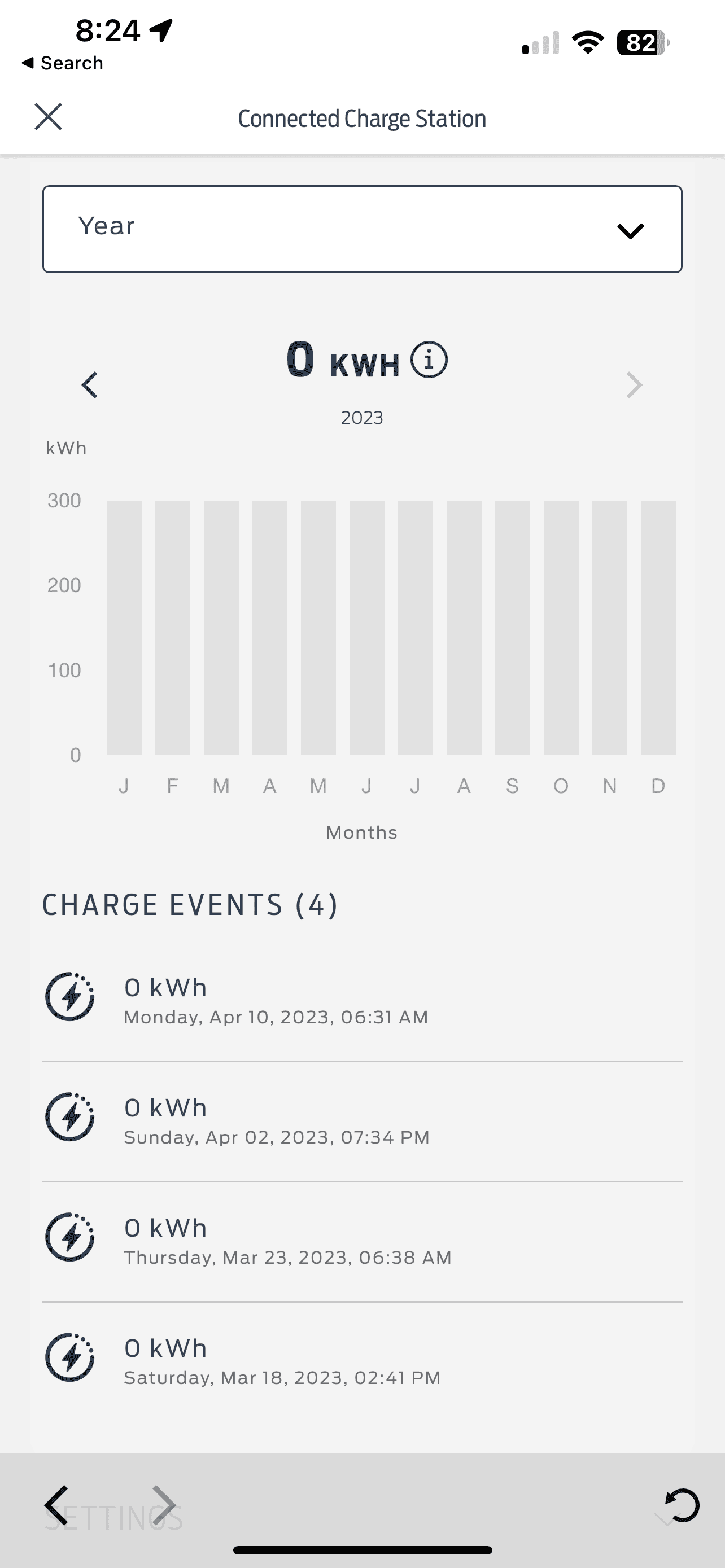

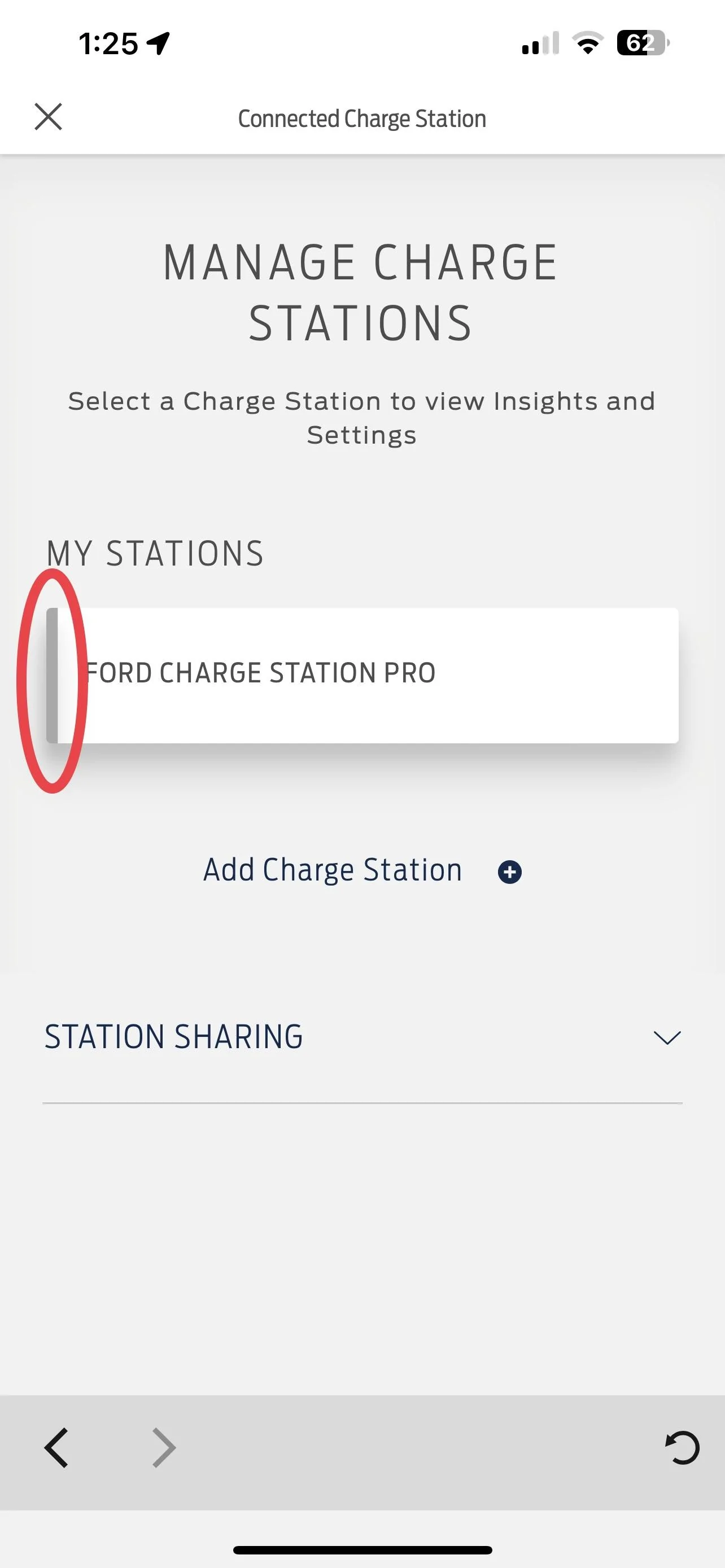

My FCSP charges the Lightning just fine at 80A, but it loses the connection to my home network every few days. It will reconnect after I power cycle the charger, but my biggest gripe is it's not recording power usage. Since it was installed seven months ago, it's only registered five Charge Events, but all of them incorrectly showed 0 kWh. I've had an open case with Ford for three months, and someone has been "checking in" with me every other week or so, but still no resolution.
I seem to remember the vertical bar below being blue when the charger is connected to my home network, but now it's gray.

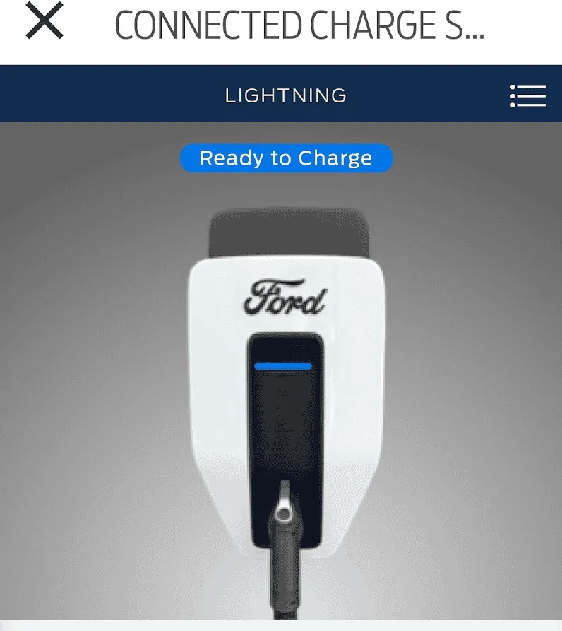

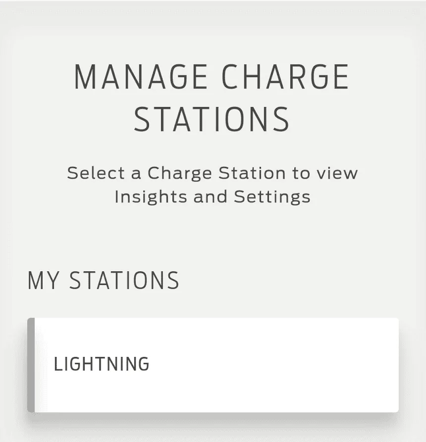

The power cycle worked, but the other screen still shows a gray bar, IIRC it was blue when ready or actually connect & charging, I think they broke this indicator in the last release.

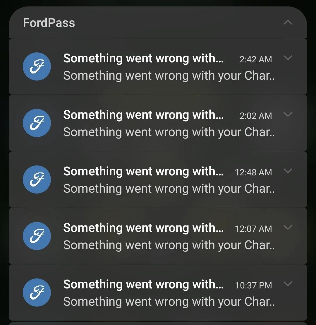

5 notifications last night.
Today it reached 106, currently 90. Started charging and after a few minutes got another. When I checked it said it had to stop due to over heating. I'm on the latest software, this is going to get old real quick. I derated to 60 to see if that helps.
Ford F-150 Lightning Poll - If you have your charge station pro installed is it working correctly ? Screenshot_20230621_043142_Nova7
Edit to add that the truck was done charging at 12:30, not sure why it keeps giving me errors after hitting target.

IIRC the truck periodically polls the EVSE, cycling it and that's probably tripping these errors.
