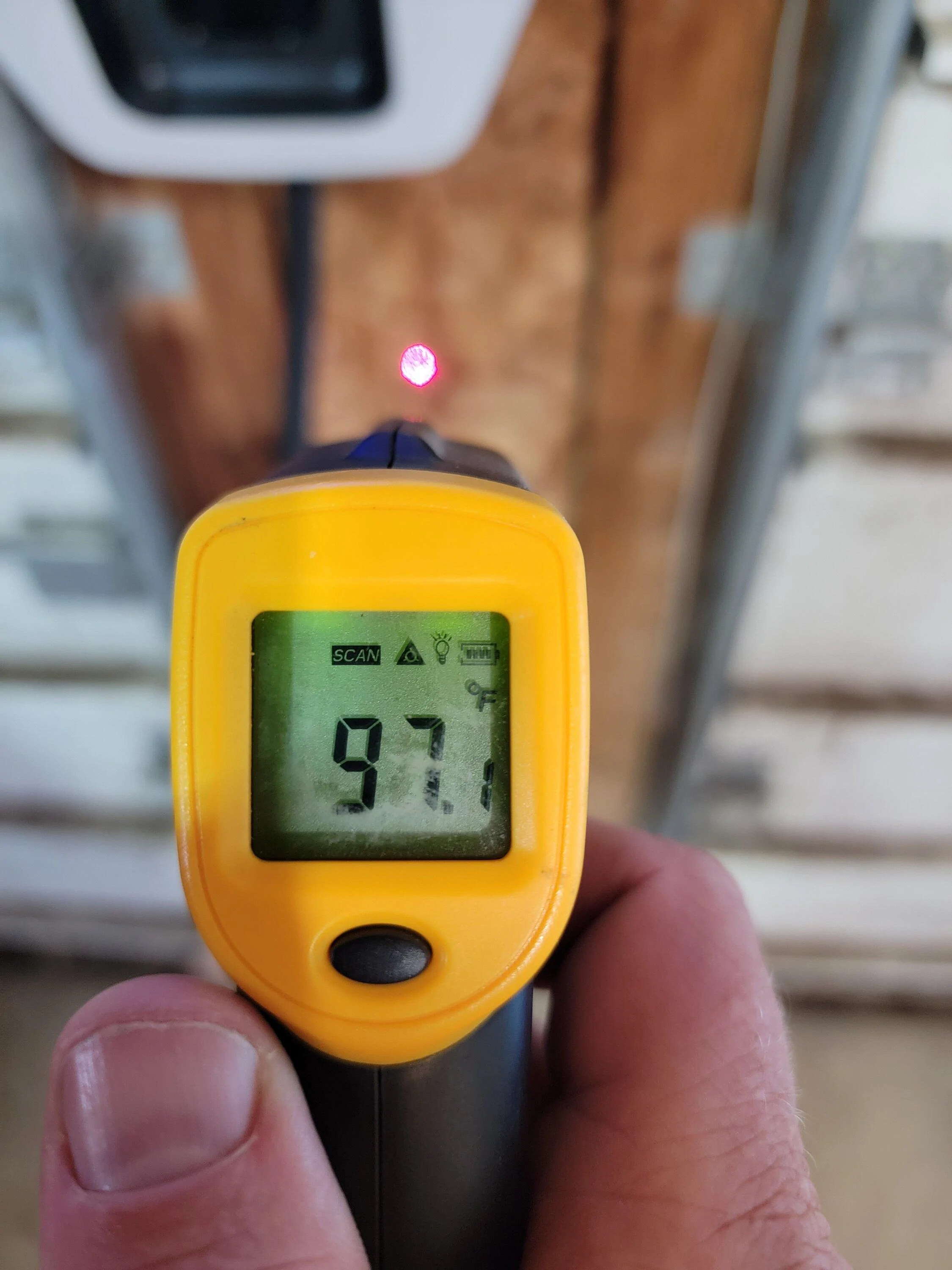

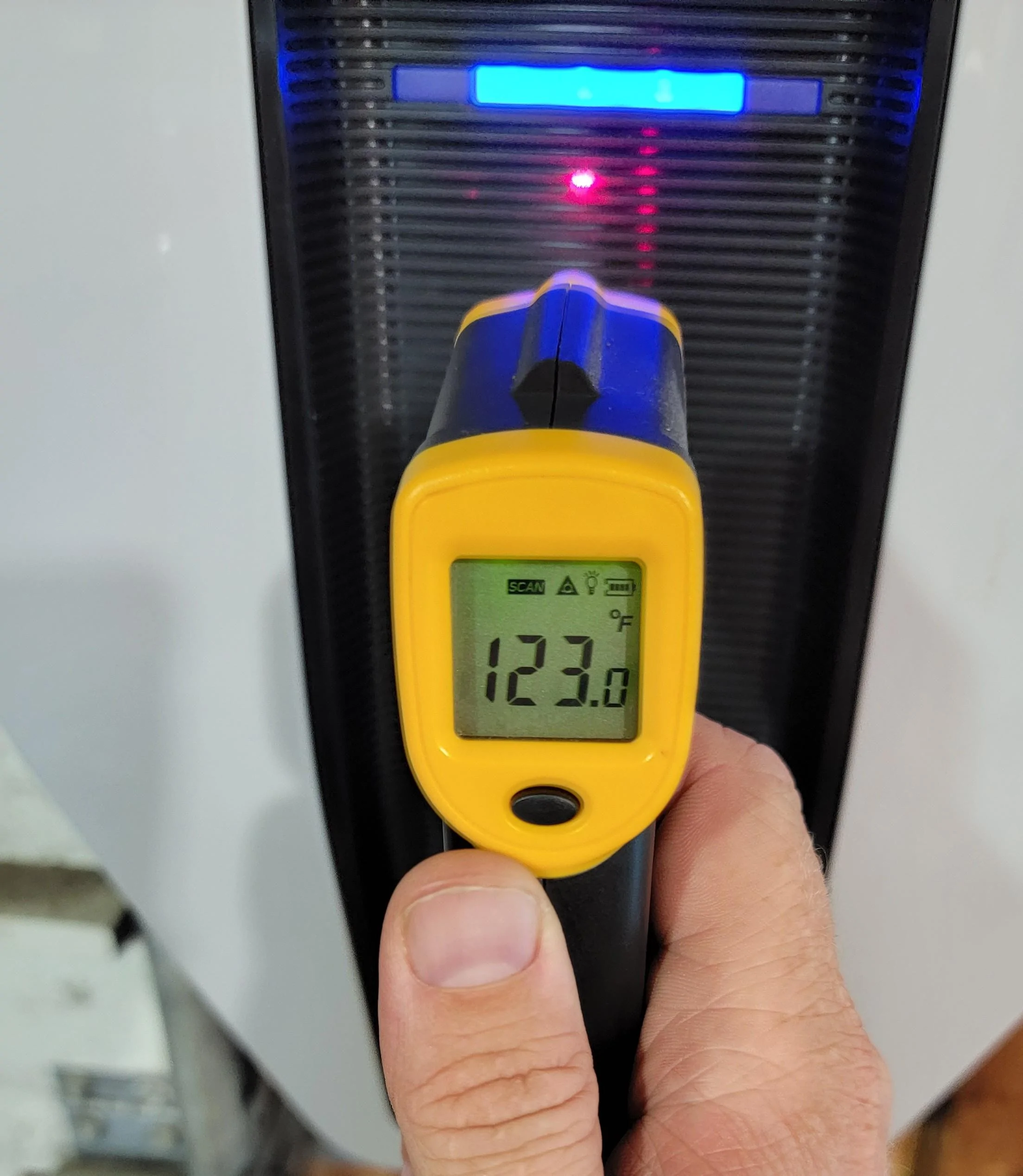

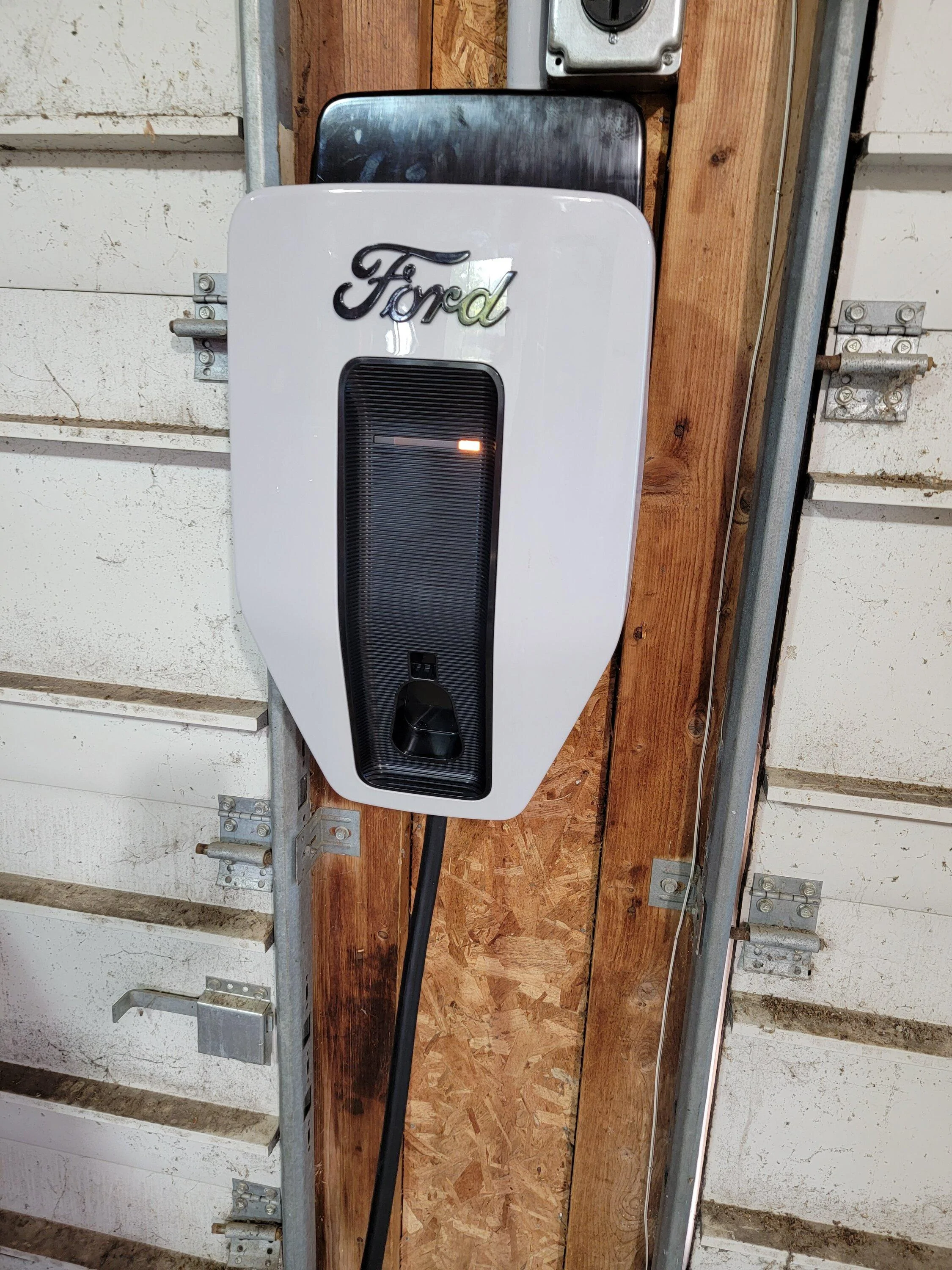

I installed my FCSP this morning, inside my garage - ambient temp outside today is 98. After about 15 minutes, the FCSP started to cycle just like everyone else's... as I noted in my observations thread about the FCSP being cheap junk, there's nowhere for the heat to go and the temperature quickly reached 120 degrees on the surface of the unit. I did open it back up and check the torque on the wiring lugs, it was properly torqued to spec.

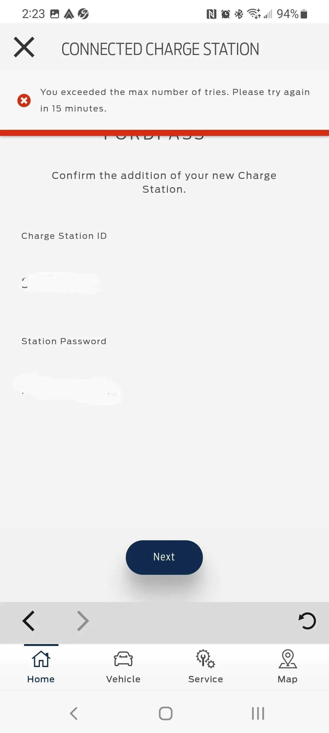

This is on top of the fact that the app doesn't work right... I successfully connected to the FCSP using the setup application and joined it to my network, but when it tries to connect it to FordPass, I get "Chargepoint Not Found" errors from FordPass, followed by a "too many requests, try again in 15 minutes". I tried another phone (iPhone instead of Android), no luck - same problems.

(Don't mind the timestamps, I took the screenshot of "Chargepoint not found" the second time after waiting 15 minutes.)

Ok - I took the cover off the unit and measured the temp of each component while charging to see where the heat was coming from.
ComponentTemp (degF)
Lower contactor146
Lower charge cable terminal (blue)144
Upper contactor163
Upper charge cable terminal (brown)163
WiFi controller / SOC144
Power supply167
The terminals were torqued properly / the same, so the only conclusion I could reach on these temperatures is that the upper contactor and terminal was absorbing heat released by the lower contactor in addition to their own. Both contactors are directly beneath the power supply on the board, and it seems that those components are also absorbing the heat from below (in addition to their own generation).
The Tesla HPWC can also get a bit toasty internally. During 72A charging today, its smaller chassis reached 115 degF on the surface and its contactors reached 135 degF (just for comparison). Tesla appears to use "beefier" contactors that generate less heat.
Now, for the final observation: the amber LED cycles stopped when I left the front panel off and placed a floor fan blowing on the components - and the truck kept charging at 80A without an issue.

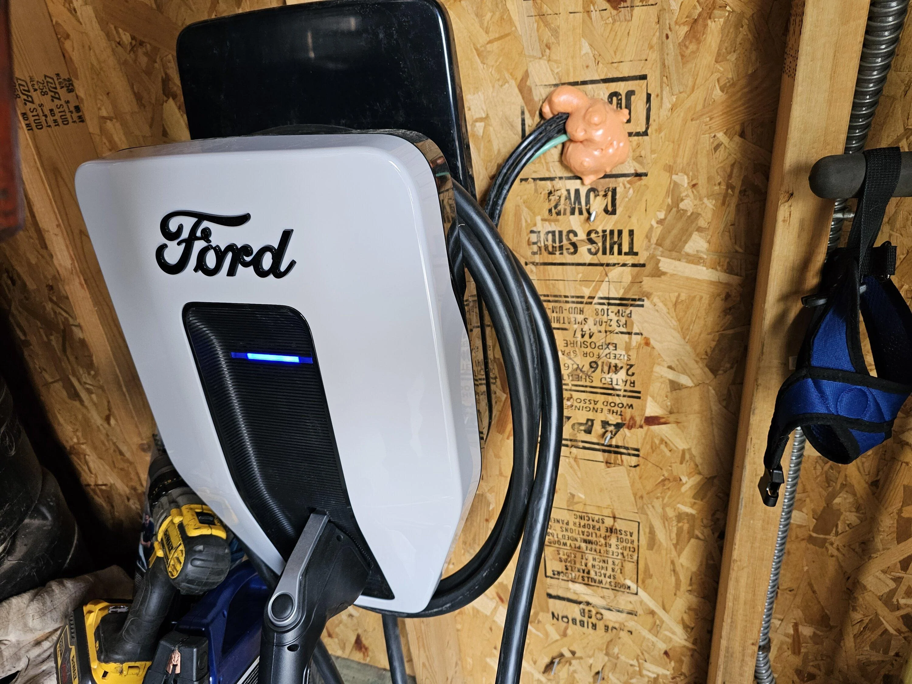

I've had my FCSP installed for about a month now and I have no complaints. I just have a few questions to the electricians and techs on the forum. My charger wires are not ran through conduit. Shouldn't this wire be inside of conduit to be up-to-codeÂż
Also, the installer put the unit on one stud instead of on maybe 2x4s going across 2 studs for better support. Also they have the plug handle just above knee-high. I need to get them back out here if these wires are supposed to be in conduit.
Thanks.

There is nothing in that picture that meets code. He obviously didn't pull a permit because that wouldn't have passed inspection. I wouldn't even leave that circuit energized and definitely wouldn't use it. Very dangerous.
The mount is fine. The wiring is a fire or electrocution waiting to happen.
Wow, thank you!
I will be calling them first thing tomorrow!
