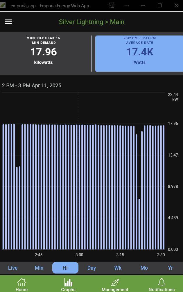

On occasion my FCSP will vary the charging rate when measure by the seconds & minutes in Emporia, I see this more so when I'm remote starting or using departure timer to pre-condition the truck, but I've also seen it during bulk recharging sessions.
Can't say for certain if the EVSE or the trucks onboard charge controller is commanding the slow downs, most likely it is the truck.

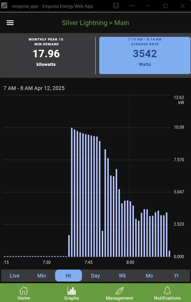

This mornings plugged in departure timed session preparing for long road trip today, past 8am it's modulating the energy output of the PTC to warm the cabin.

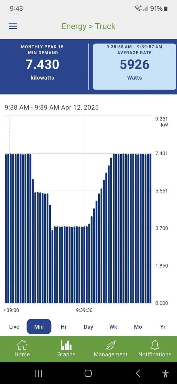

Last nights charging session preparing for Saturday trip.
