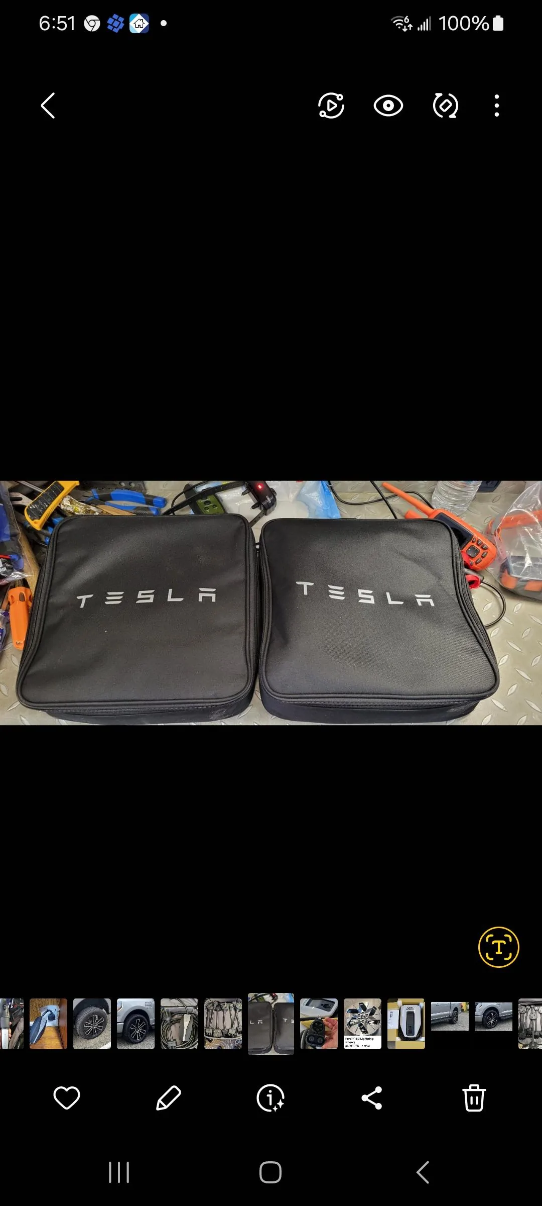

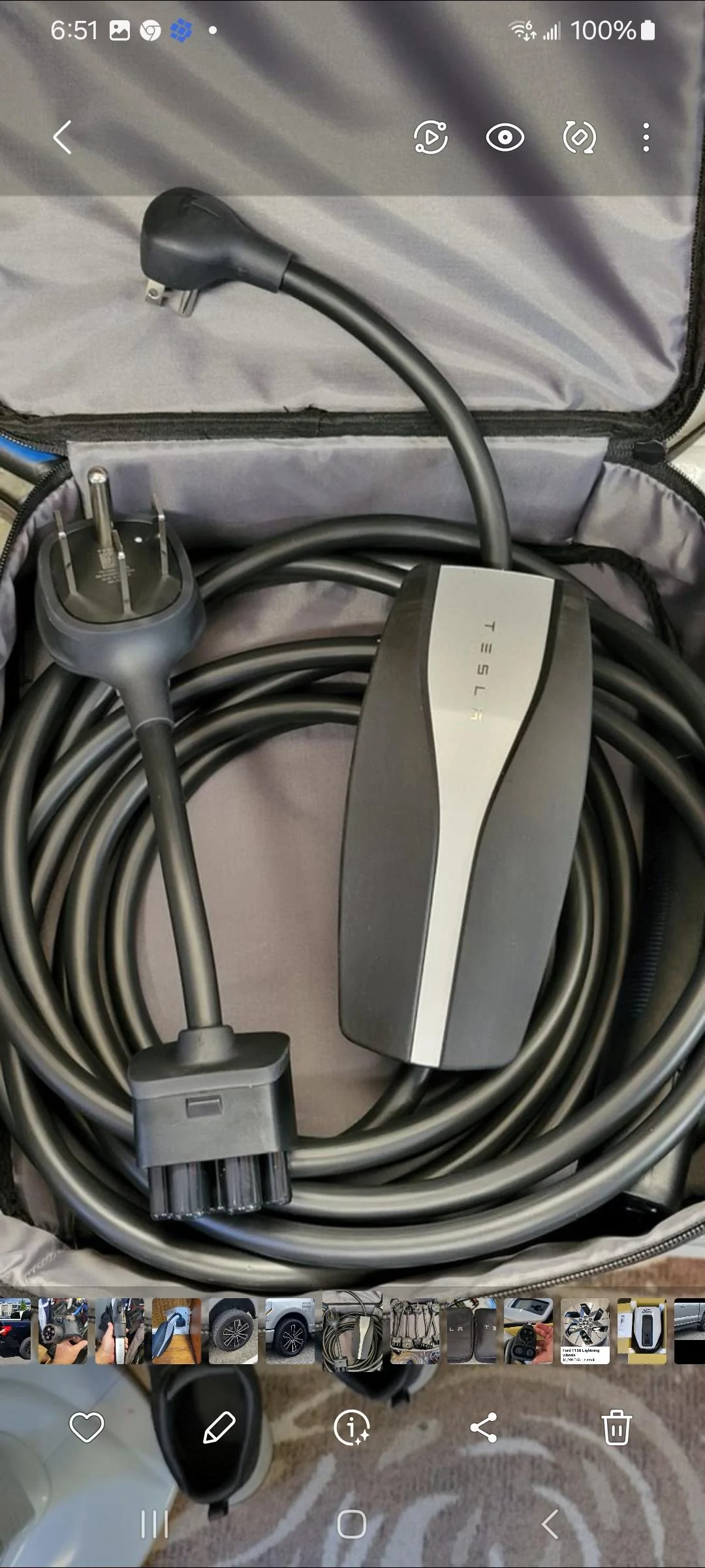

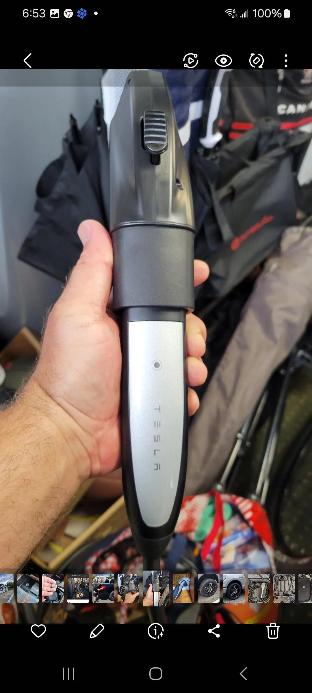

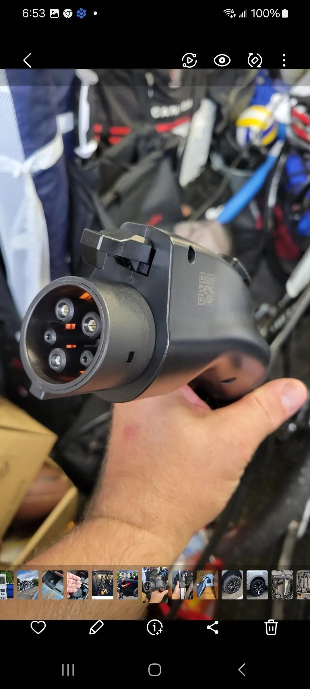

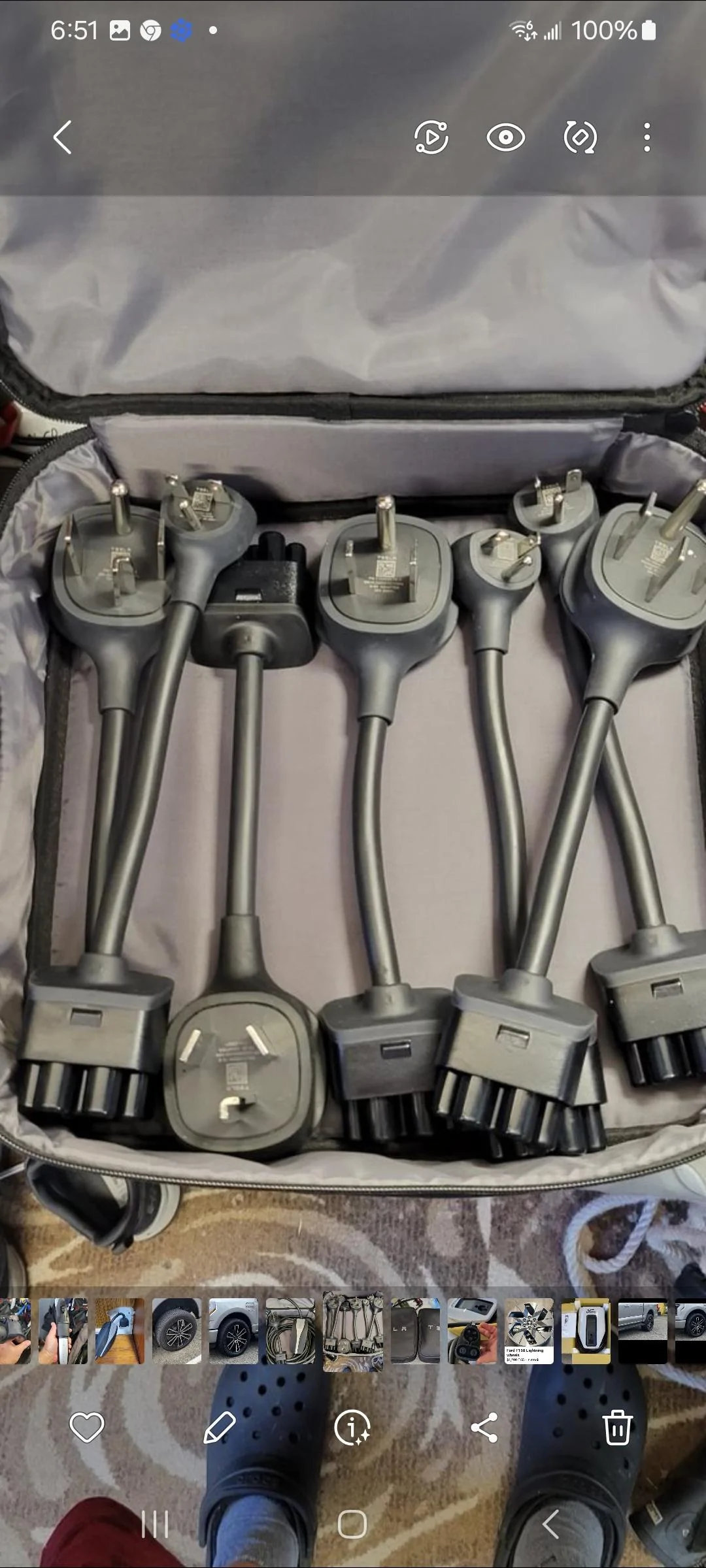

I've never used the Ford Mobile charger cause I bought the Tesla mobile charger and an adapter! The Tesla mobile charger is a bit more powerful couple more amps and every bit helps when using a mobile charger. Also the Tesla mobile charger I bought the adapters kit that has ever imaginable connection type, way better than Fords. There was a thread about this with links to buy it all, which I did. If I can find it I will post it here..
I also use the Tesla mobile charger with the same J1772 adapter and have had no issues at all. Love its usefulness, and have purchased additional dongles as needed for places I visit like my parents' place and in-laws' farm. Excellent unit that stays in my truck at all times.

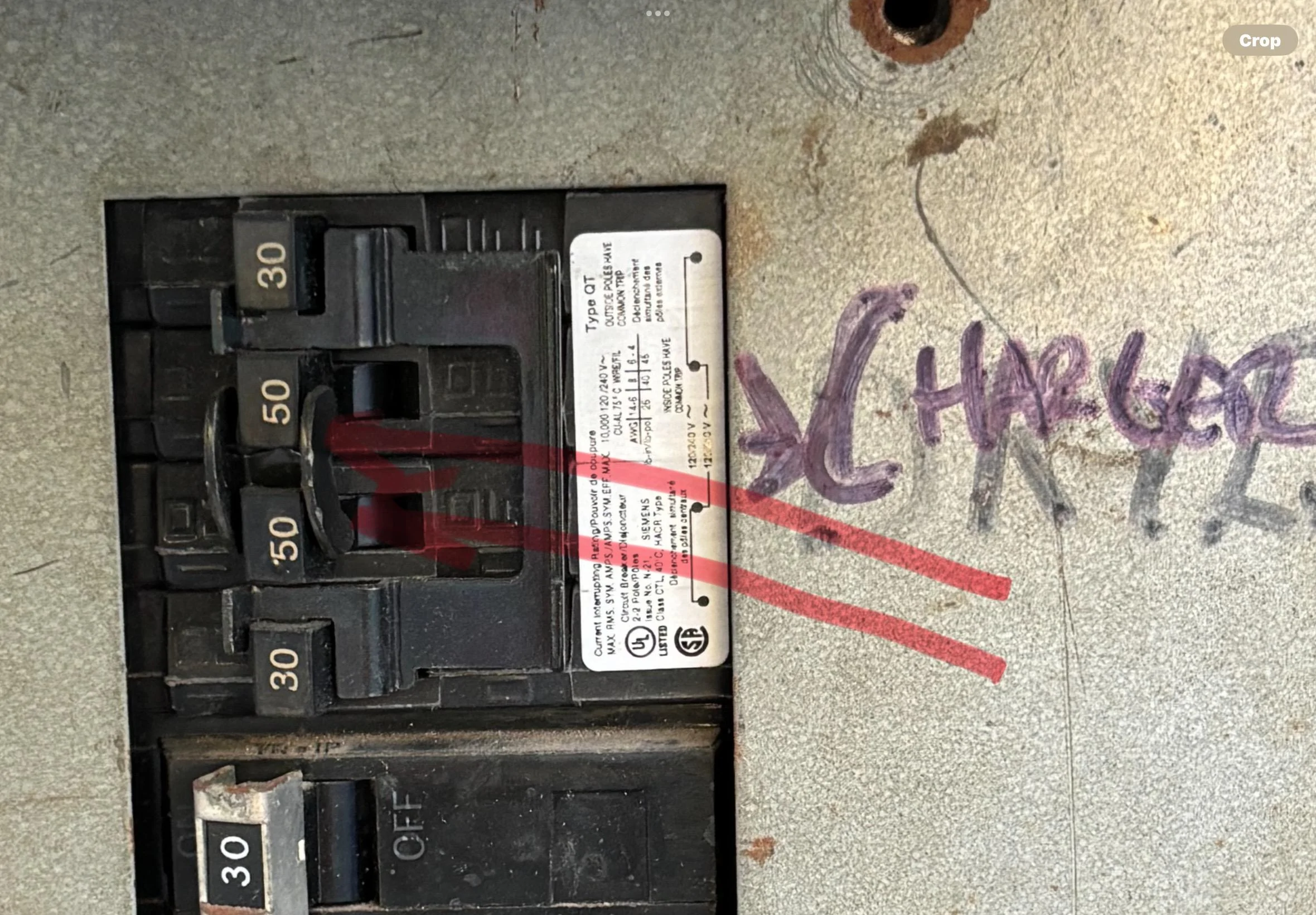

Breaker rating should not exceed the rating of the wiring or the receptacle.

Got it. This was done due to limited room on the panel. He bridged two 30a's around other breakers. It was either that or rebuild the panel. I was not aware that it would be an issue at the time or I would have had him rebuild the panel.
It’s FINE as it is. Perfect.
Thats a 50 amp breaker to your charger not a 60 amp. . It’s what is called a quad breaker. The two center paddles are 50 amp connected to made them a double pole 50 amp 240 v breaker. The 2 outer paddles are bridged to make them a double pole 30 amp 240 breaker.
edited to correct 30 amp as 240.

Oh, nice. I misunderstood the electrician. I thought the bridge on the 30a that connected them together made it a 60a capacity. Turns out that pair of 30a's is for the dryer (just checked), and the 50a is for the charger. The 30a's are connected, which I guess would make them a double pole. Clearly I don't understand this, and I very much appreciate the help.
