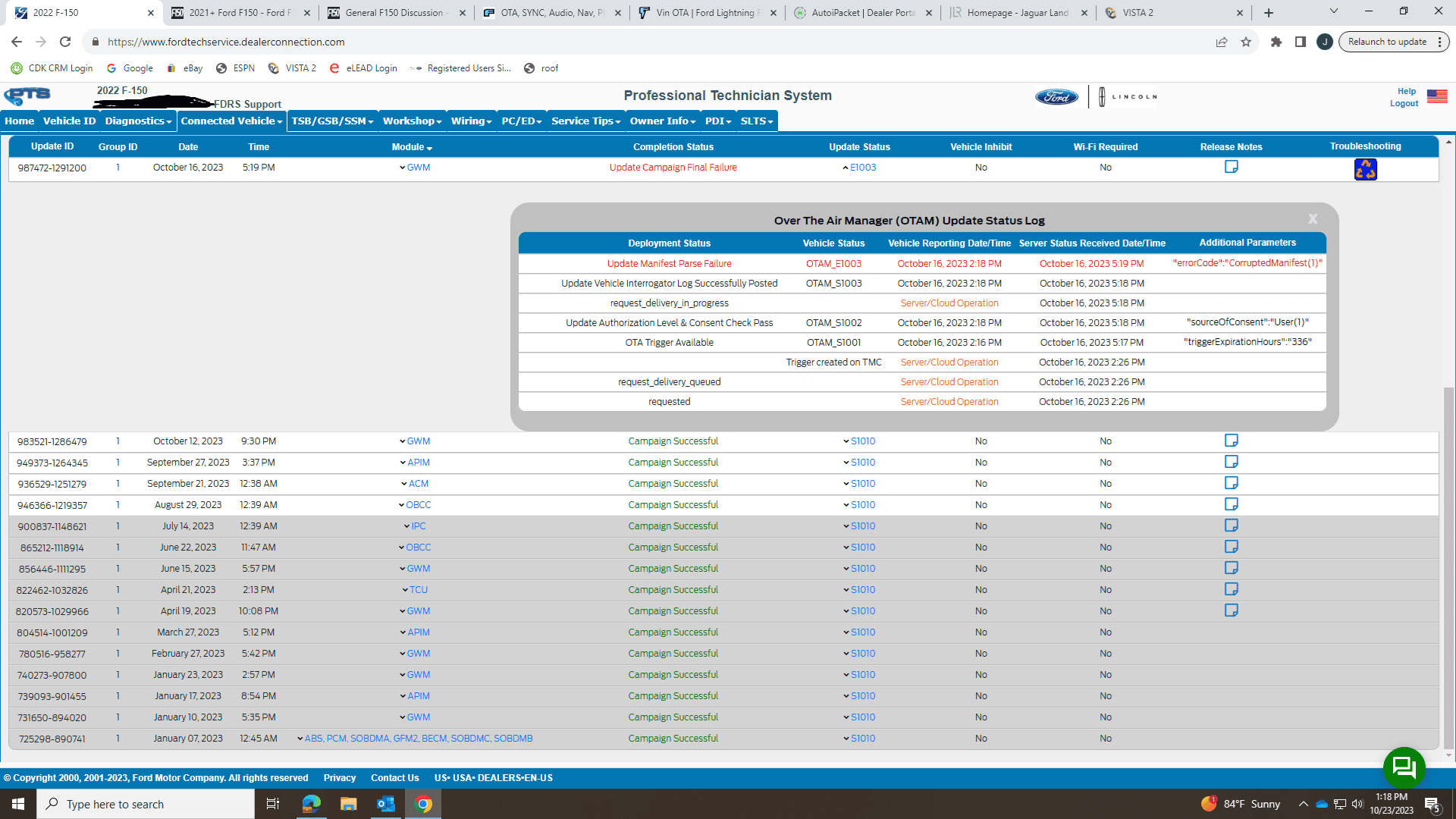

Ah. Looks like the OTA failed for some reason and the OTA trigger got canceled. Did they provide the error code as to why it failed? If they didn't and you want to know, I can check PTS for the OTA details with your VIN.

That would be great as they just told me it would upload later. No issues were found at the dealer during the High voltage update so who knows.

Post it or PM me if you prefer to keep it private. I will respond here either way so others can see what happened in case they experience something similar.

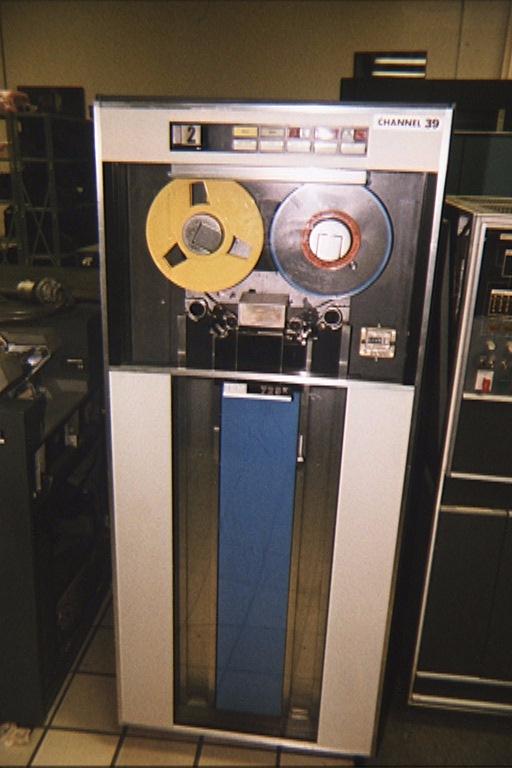

I found a picture of the Ford server.
Early in my IRS career, I worked with equipment similar to that at the Andover Service Center

Screenshot of your OTA dashboard is below with your VIN blacked out for your privacy. Update failed due to a manifest mismatch. There is nothing you could have done differently....this OTA would have failed no matter what. It only took a minute from the time you started the truck for the update to get rejected by your truck.

Thanks! Looks like the truck was disgusted by this OTA 🤣

lol It happens a lot more often than you'd think. It's happened to my truck, too.
Me too, but at a copier company whose name begins with X. Wonder if its 1600 or 6250 bpi. :)
12,059
12,652
It’s still there, I’m sure.
Actually, they decommissioned return processing at 7 centers including Andover, all is done in 3 locations now, Austin, KCMO & Ogden.
