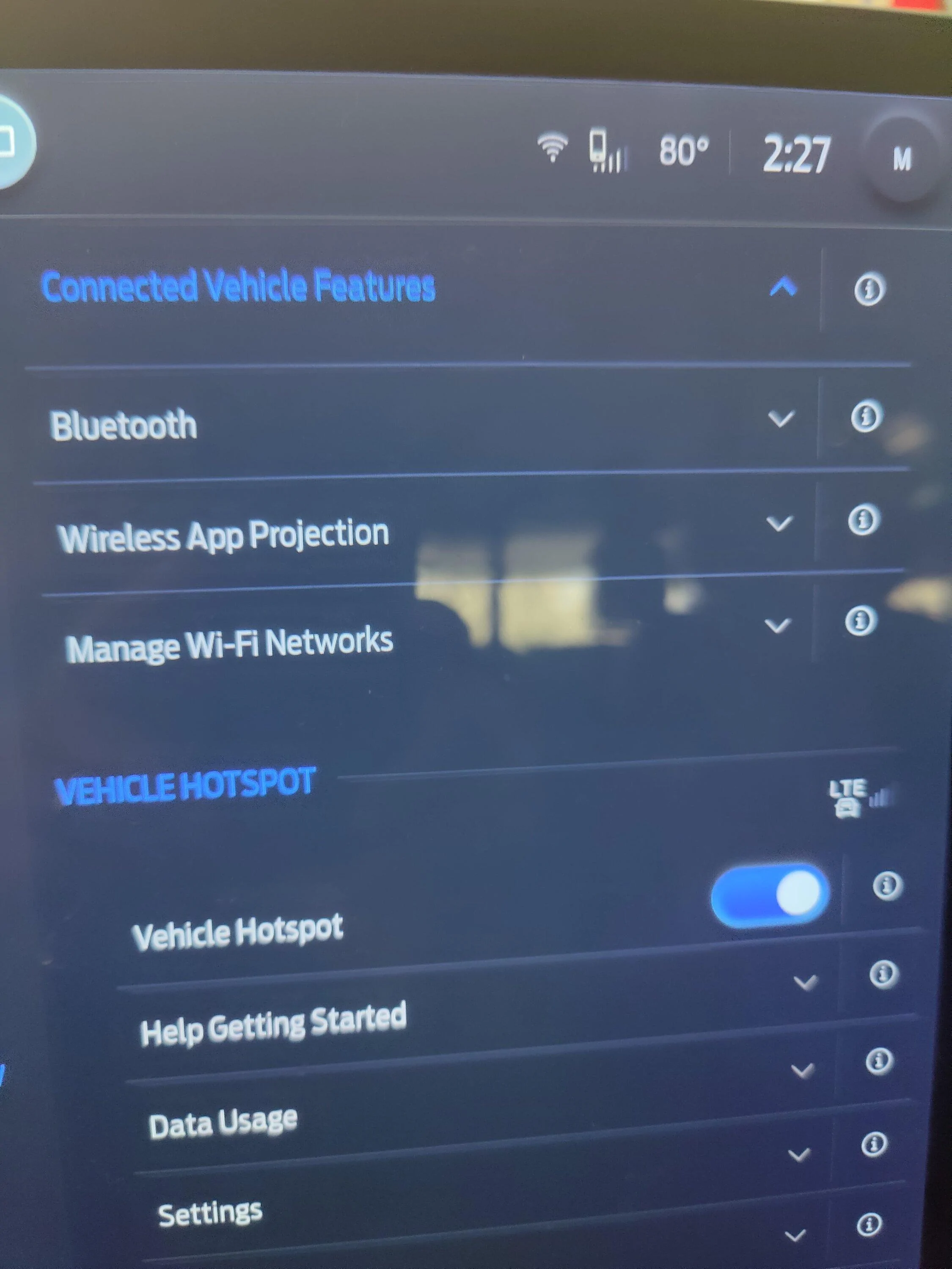

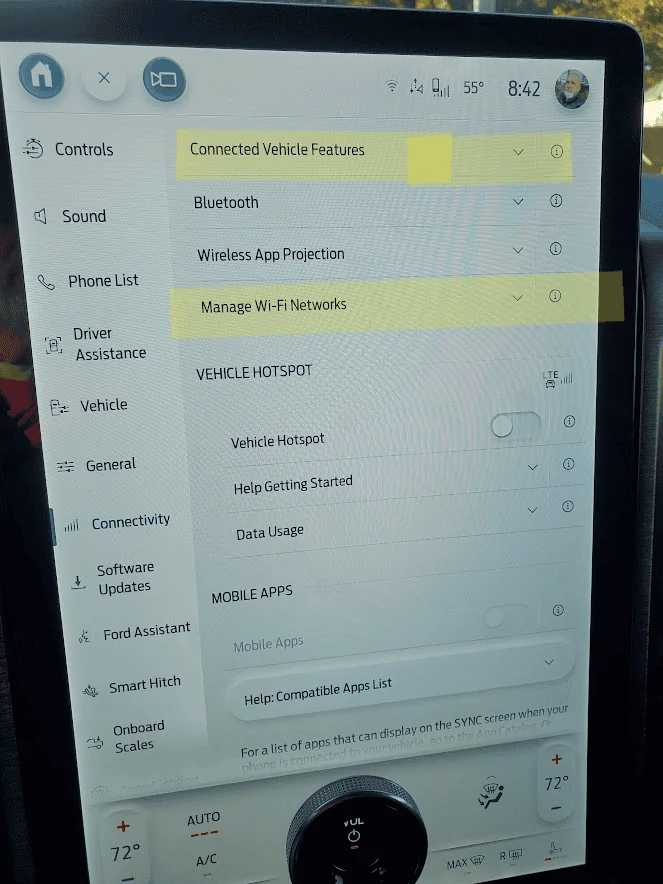

I went and looked at my Connected Vehicle Features, but when I select it, it will say please wait. But the options you show in the far right picture never show up. Anyone have any ideas why and also could this be contributing to me not getting any OTA updates since I got the truck the end of June?

It's a known bug that gets fixed with 6.3.0. Is your vehicle connected to your FordPass? Can you send commands outside of Bluetooth range?
Gimme_my_MME
May 29, 2022
486
794
Yes, I can send remote commands via FordPass.
Than most likely you are fine and just waiting for the updates. The bug keeping the menu from working is intermittent so check on it every so often and you'll probably be able to catch it and get it open and check
Look up at the top of the screen where the Wi-Fi, Cell Phone Signal and Temp are listed. There is another indicator that should be there, it's a triangle with two arrows next to it. That icon indicates an active connection between the modem and Ford's servers. Without that icon the Connected Ford features won't show up in the dropdown...it just times out.
I believe there has been a bug in the APIM or Modem or Gateway module for this.
If you happen to keep the truck in an area with very low AT&T cell phone reception and the truck looses its active connection to Ford's cloud the Icon will drop off. Then when you fire up the truck and drive a few miles down the road the AT&T signal improves and the truck/modem reconnect. The bug was that the APIM did not refresh to see that the modem had reconnected. Sometimes you would get the popup message that your truck is now connected to ford's cloud but the icon would not pop up.
So the modem and gateway were talking to ford and your ford pass app functions all worked. Just the APIM would not refresh to see the connection to ford's cloud.
In my case the icon would return after I parked the truck in an area with decent at&t signal and let it sleep for a 30 min or so.
After the most recent APIM update for the owners manual it seems this bug is fixed. I get the connected ford cloud icon every time I drive the truck. Sometimes it takes a few min for it to turn up but it's consistent now.
