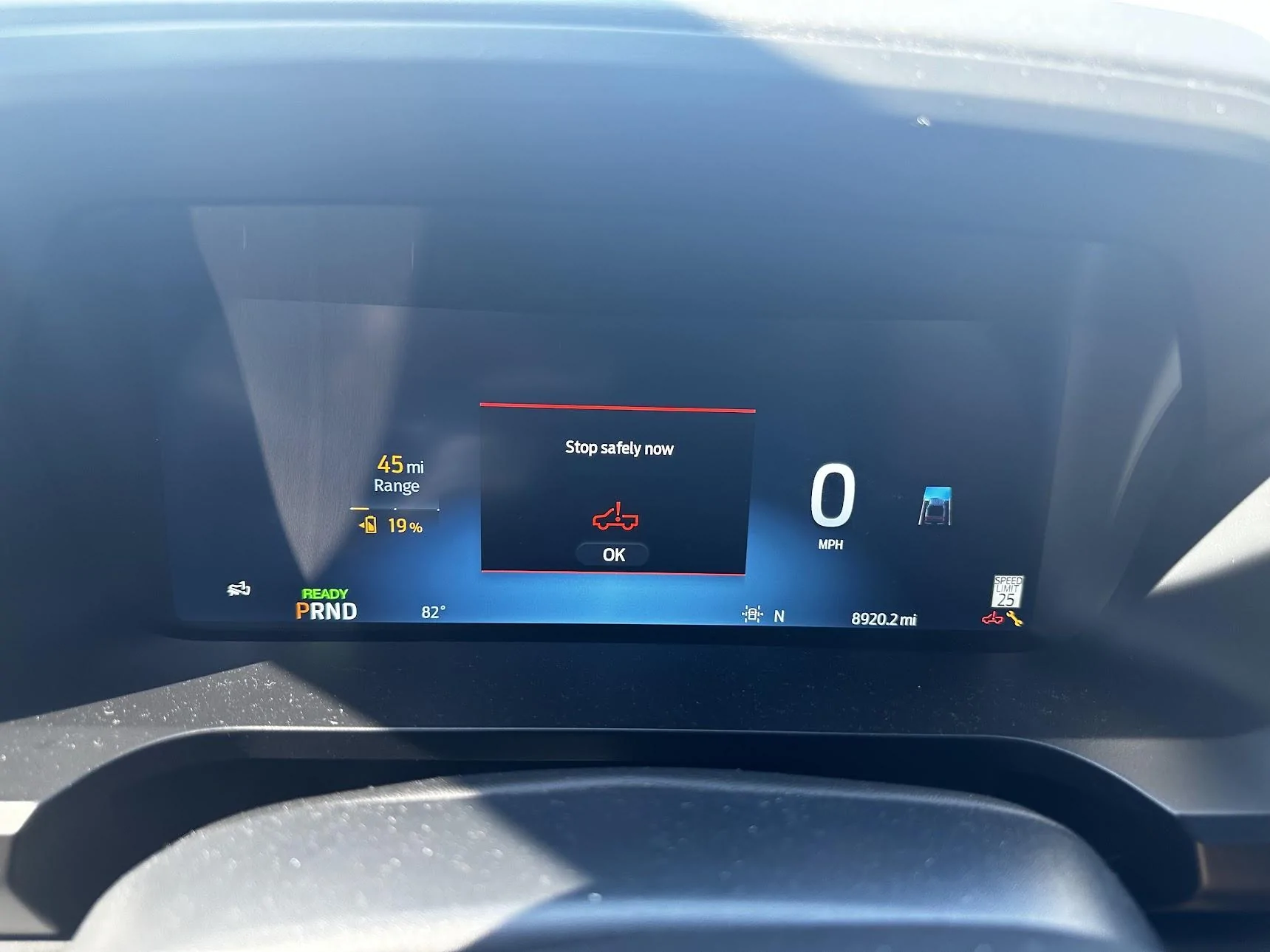

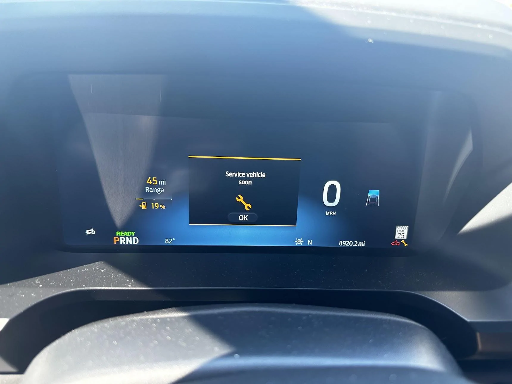

Here I go for round 2 (presumably). First time dropped off truck on 2/14 and received back on 3/17, fix was a High Voltage Battery Module Replacement. To Ford's credit, that time they proactively reached out to me as the truck must have phoned home and notified them of the pending issue.
Well I just got the "Stop safely now" and "Service vehicle soon" screens. Car went into limp mode and couldn't even make it up an incredibly modest incline. Car had 19% charge and hadn't been charged since this past Friday. Had a great EVGO session that morning, drove from OC to San Diego and back again, and did some around town driving over the weekend. Fine taking the kids to school this AM, but this afternoon it happened.
Despite absolutely loving the truck I'm not sure I'm willing to wait another 30 days for another fix (if it's the same/similar issue).

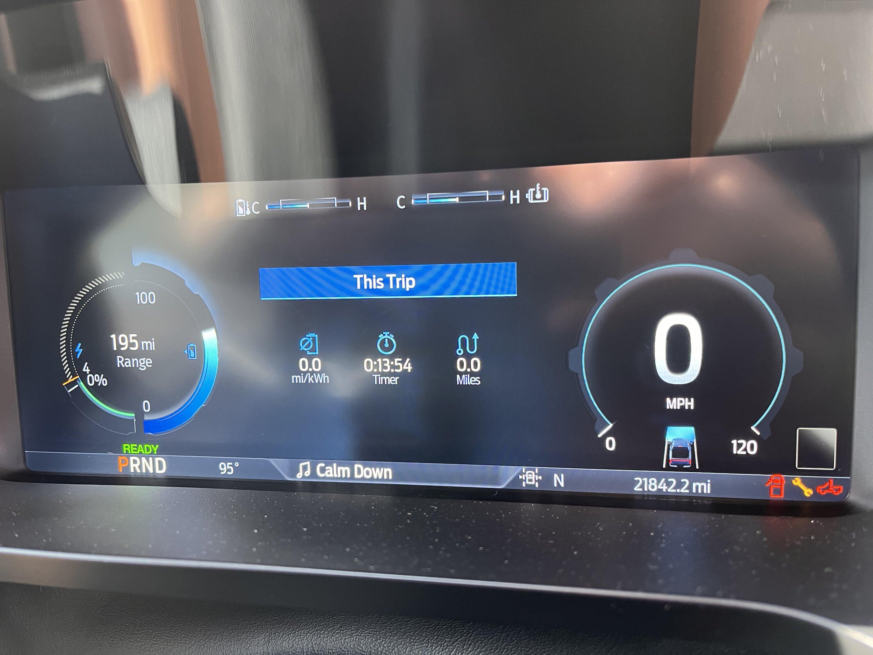

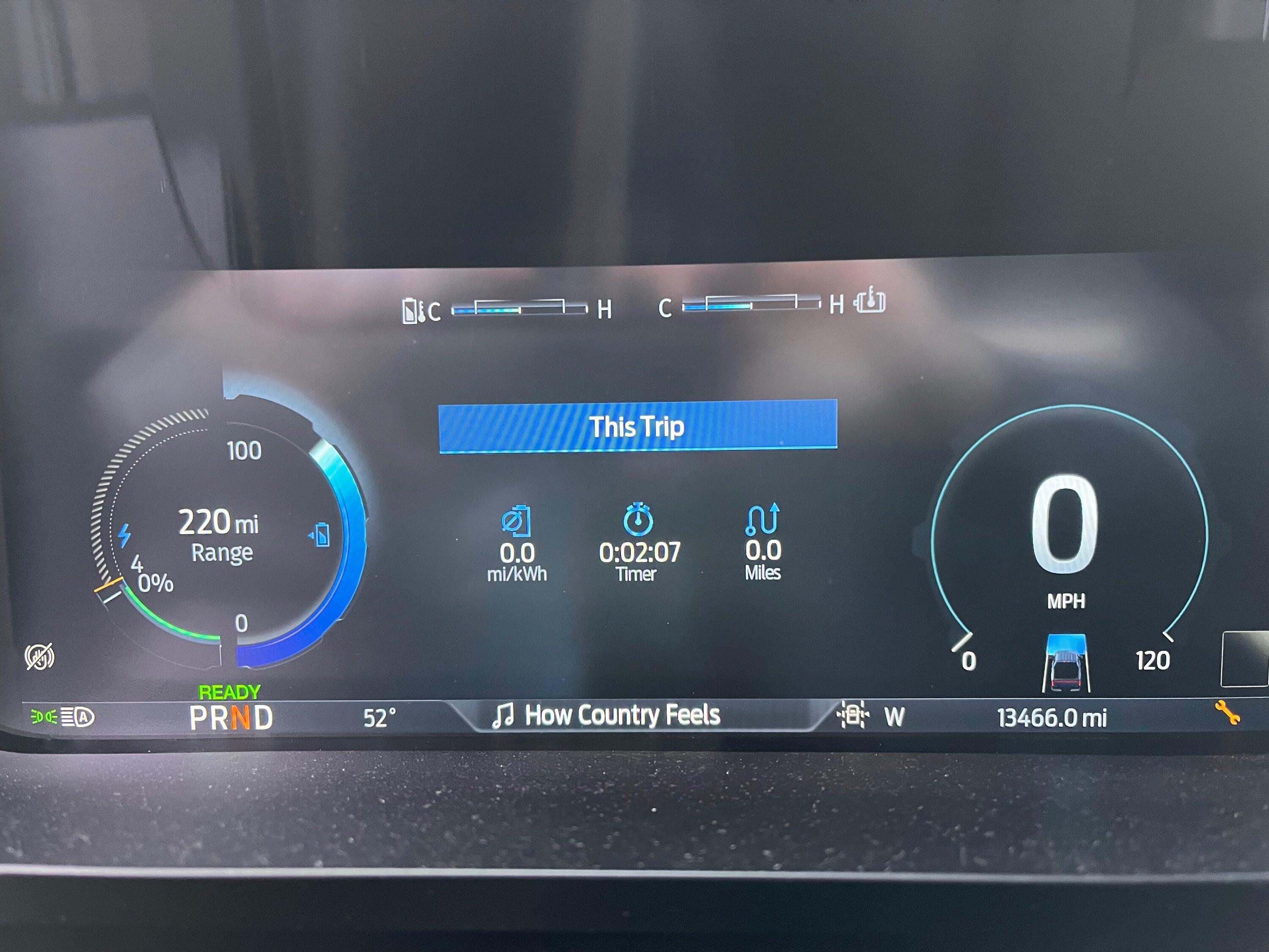

Dang! Yes, Lightning can hit twice! No pun intended. I just got stranded for the second time. 1st on December 22 with 13466 mi and 2nd now on May 23 with 21842 mi. I had the module #6 replaced on the 1st occasion because one of its cells failed. Expecting the same now. But still waiting for the shop diagnose. So upsetting. I love the truck but my trust on its powertrain reliability is completely shattered, sadly. Manufactured on May 22. Pattern noticed: when a module gets defective you cannot charge past mid-80s% (it will show 100% on the screen but when the charger is removed, it will immediately show the actual lower SOC). My daily standard recharge level is 90%. Then, once the SOC falls to around mid-60s%, the overall pack voltage colapses to a level unsustainable for regular driving, triggering the limp mode and the system faults. It seems there is something very wrong on early production SK battery modules. Or I’m just very unlucky. @Ford Motor Company , what’s going on?!
