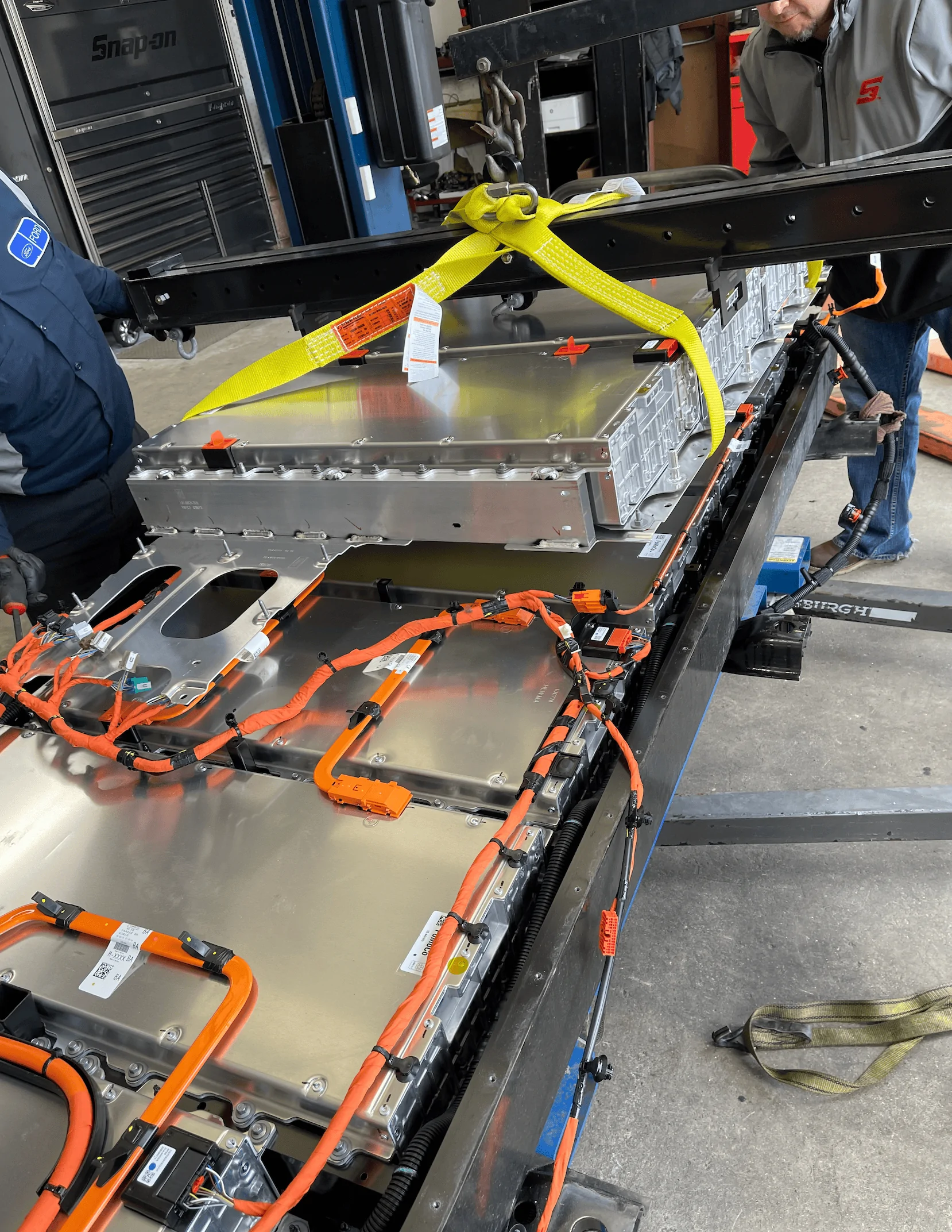

How much of the truck has to come apart to repair. I watched the battery tear down video once and don't think it drops from the bottom. So does the bed and or cab or both come off depending on which module needs replaced?
Gimme_my_MME
May 29, 2022
559
994
It gets dropped from the bottom, no need to take off the cab or bed

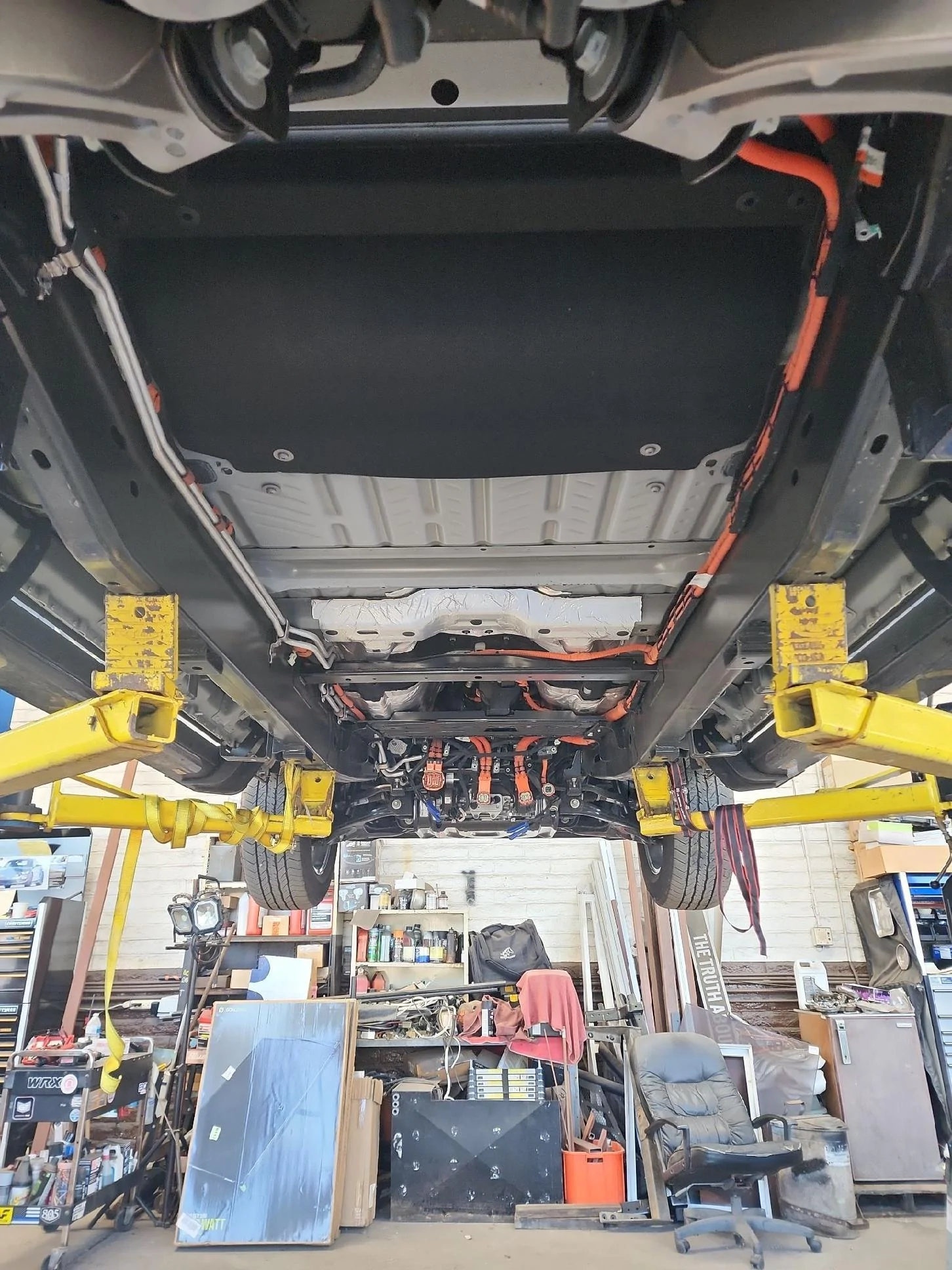

Mine was dropped from bottom.

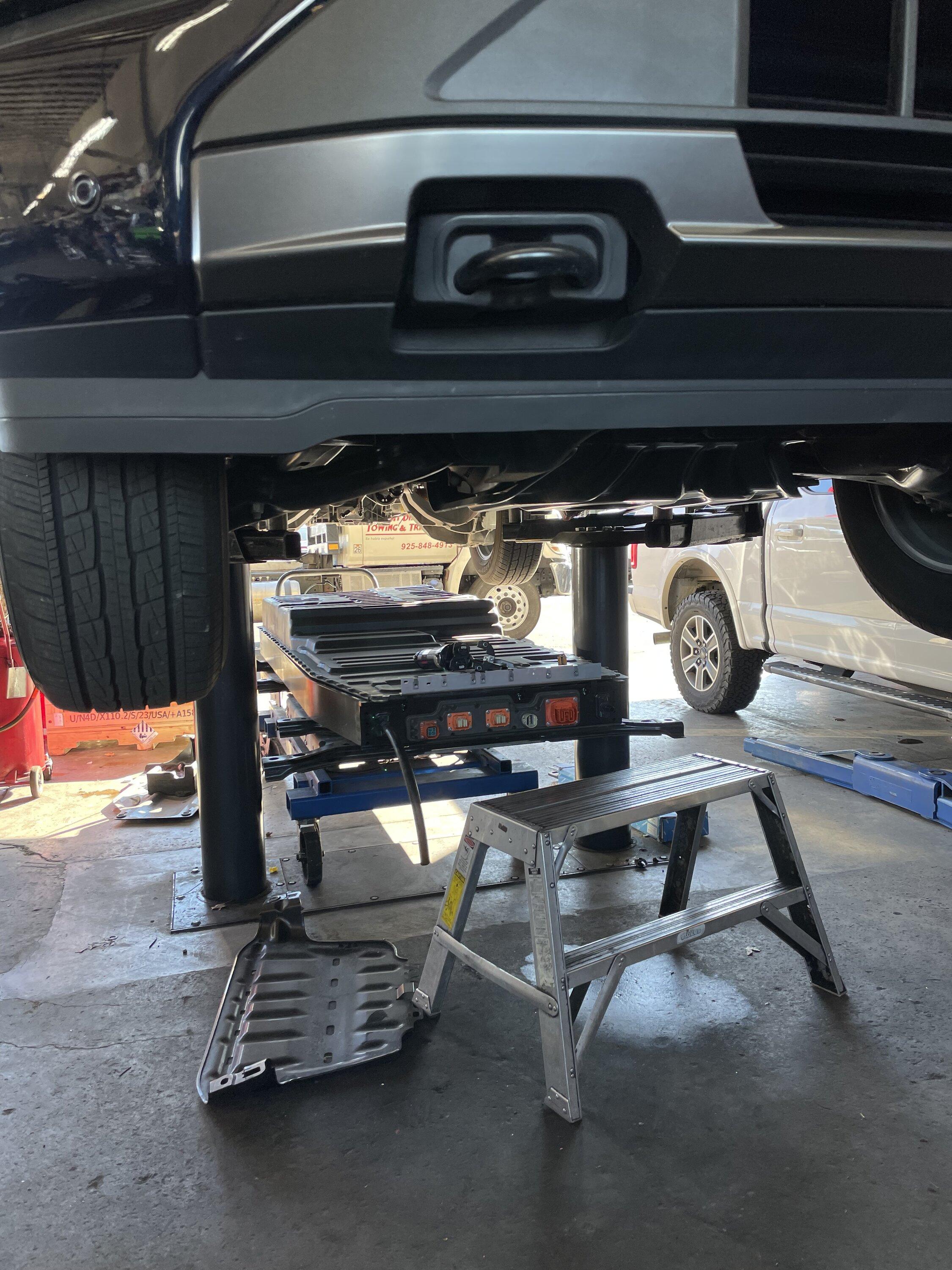

Same here, battery is lowered while truck is lifted.
They had a bit of scare on mine because the Decked in bed was full of tools and truck popped up a bit when the pack dropped. That’s why there’s some straps 🤣
