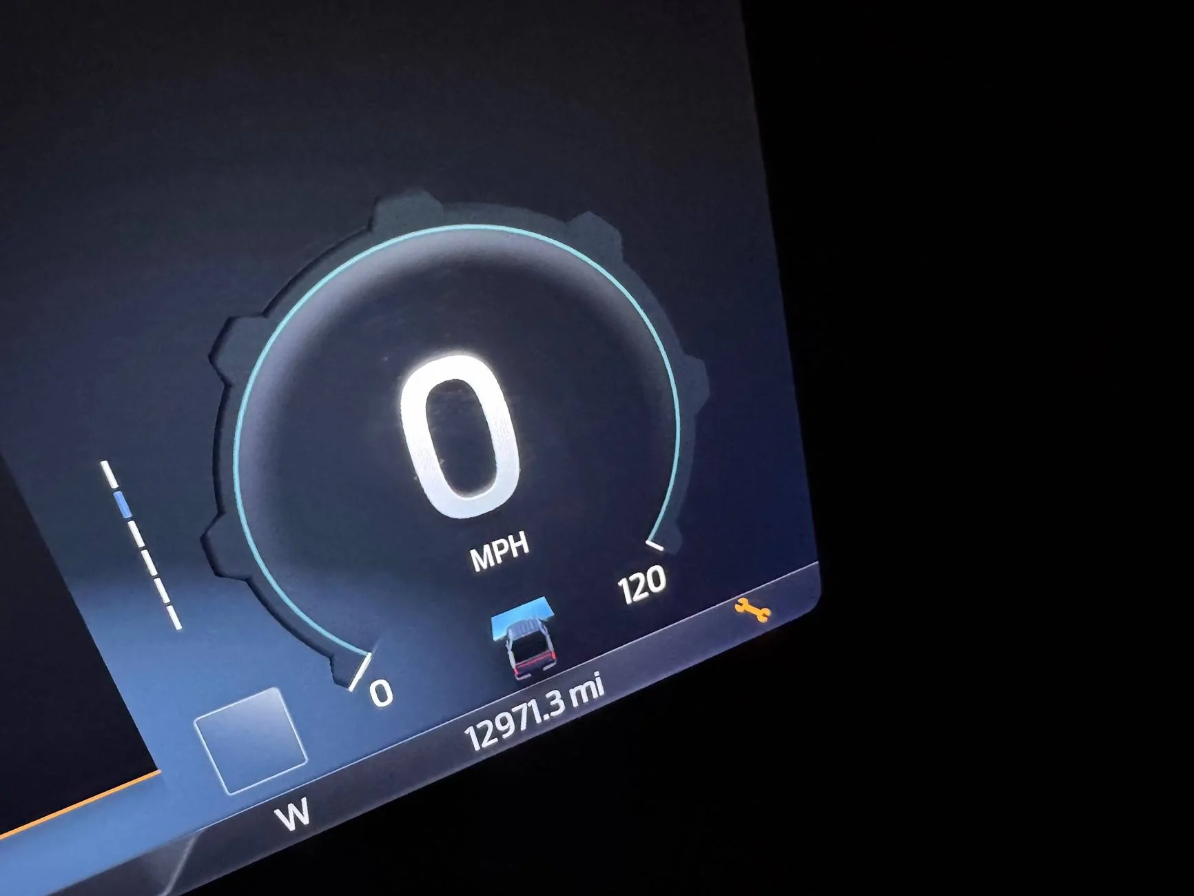

I have same issues!
Ford F-150 Lightning Powertrain Malfunction, reduced power to 67%, and "Wrench" symbol on dash IMG_7066

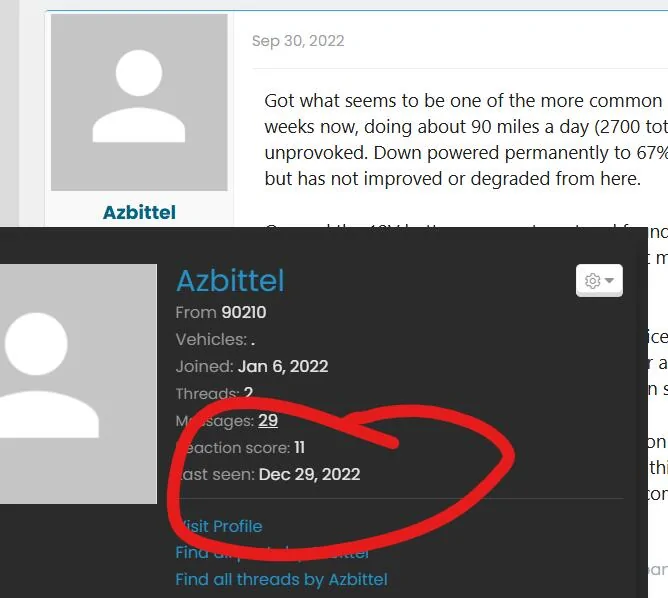

Doubt this members is around anymore.....
Ford F-150 Lightning Powertrain Malfunction, reduced power to 67%, and "Wrench" symbol on dash 1733436330282-rf
