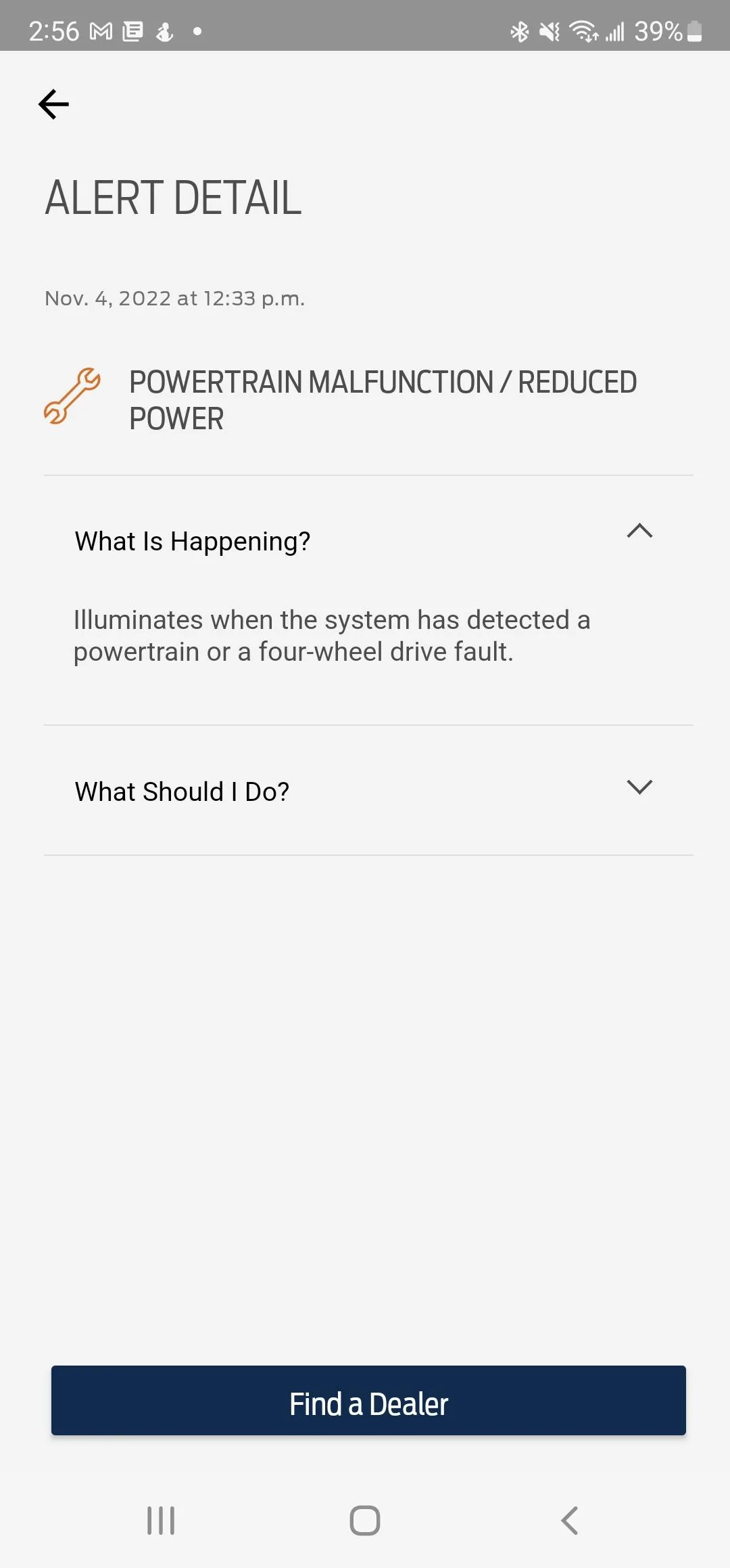

I also got the same message. Just took my truck to one of the local dealers. I had no driving issues, but he said this repair could take 3 months!!!! I am pisses
I have gotten a few of these messages, I won't make any assumptions on your part but found that my 12v battery connection was loose which was recommended by another forum member. Just in case you haven't checked that yet, brought mine to the dealer and they confirmed this was the issue and sent me off. Haven't had the error since...

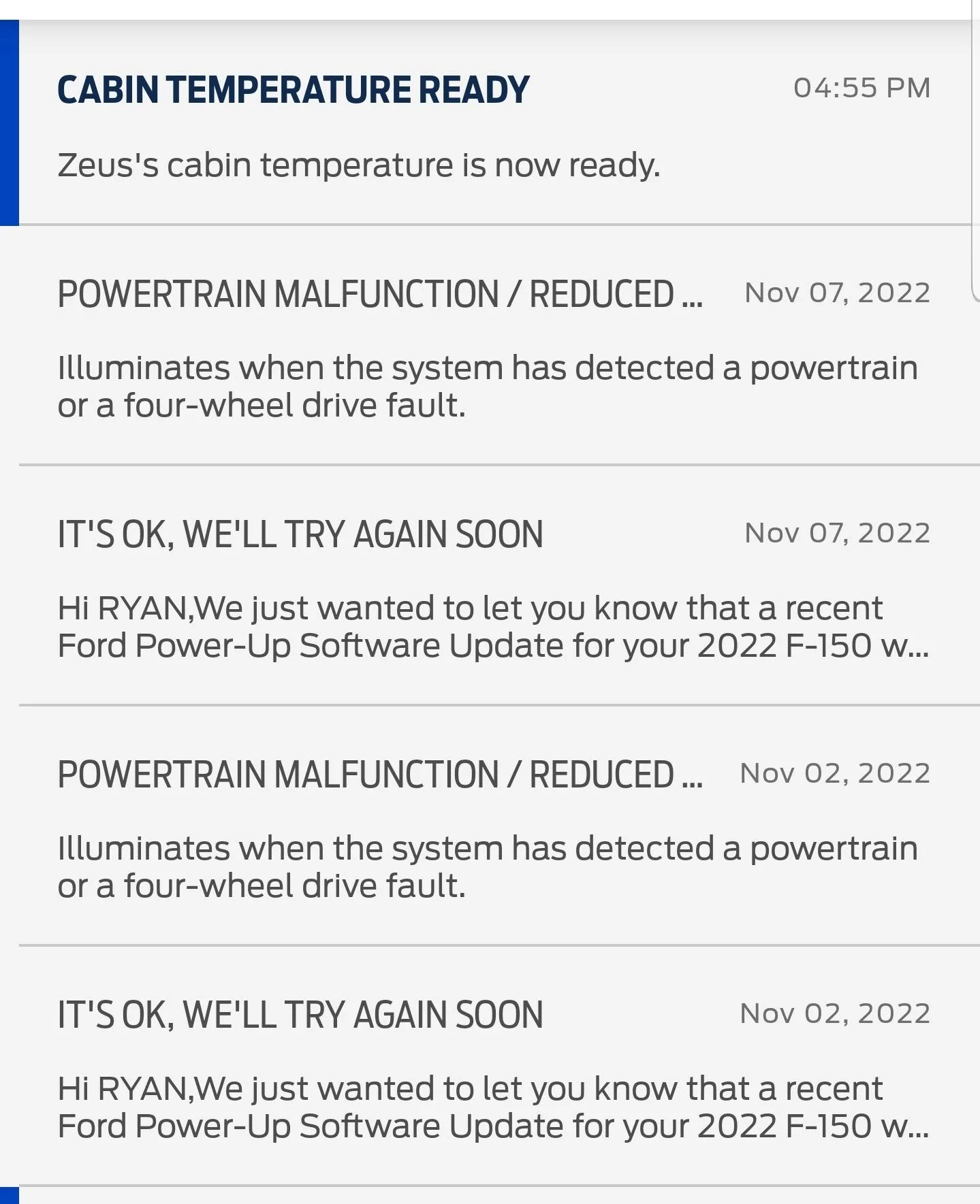

I woke up to the truck alarm at 1:05am, then 1:20am, then again right after. The fob wouldn't shut it off so I had to go to the truck
The big screen in the truck was lit up and said the update had failed, I had the updates scheduled for 1am (now it's 1pm lesson learned). The next morning I had a power train failure. Then it happened 5 days later. I got a call into the dealer, but seems centered on this update to me.
