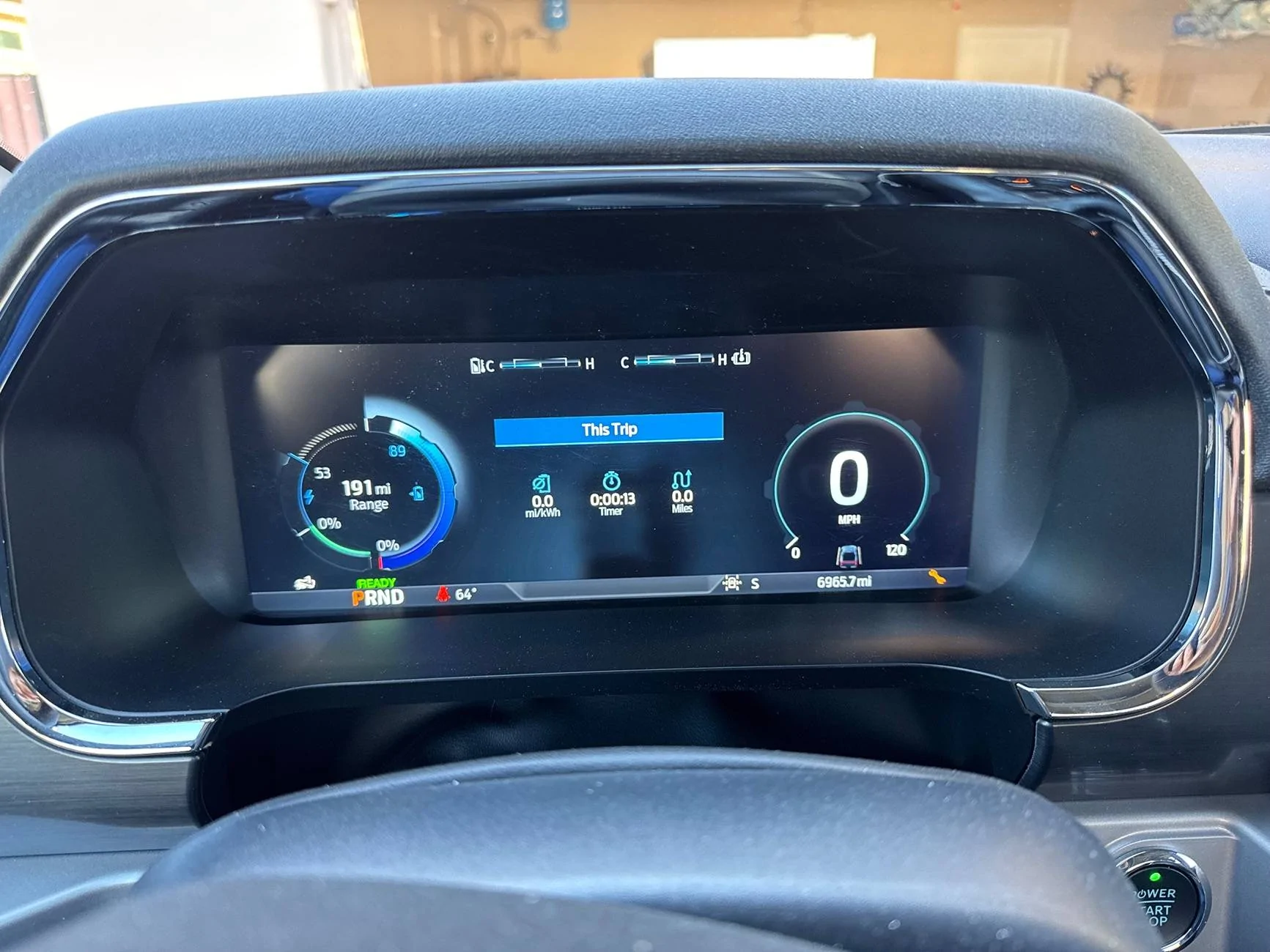

Add me to the list. 2023 XLT SR power reduced to 53 and charging faults. Dropping off at Peoria Ford here in AZ tomorrow. Been on software update 10.1.1 for a month so no new updates that would have caused this.
Build Date 10/23, purchased 7/24. 6900 miles.
