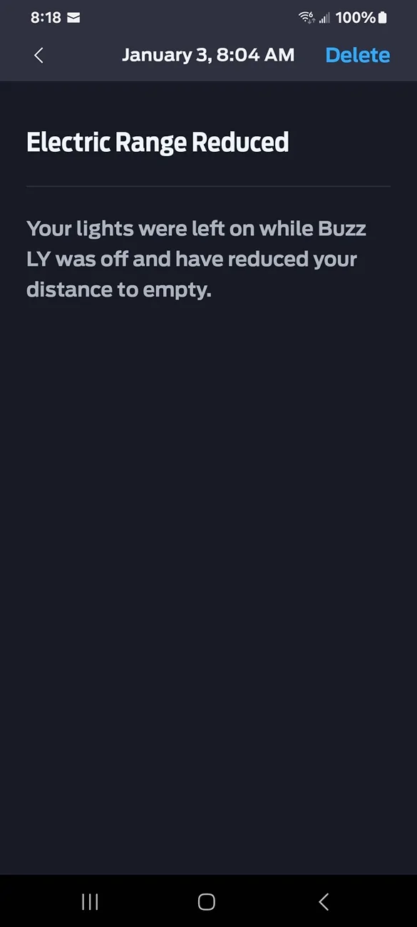

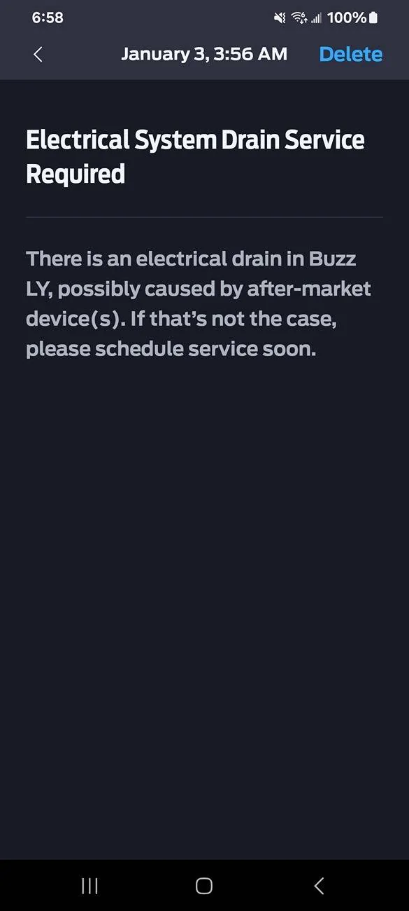

So, par for the course. Truck is not ready. They'll keep it for the weekend. Truck sent me a message at 3:56 am . See screenshot. There is an electical drain, service immediately . Then at 8 am I get another message from my Lightning. Your lights were left on and now range is zero. Strange. I call them at 9:20 and tell them that the truck is still sending an SOS to me .lol. The service writer tells me the 12v battery is no good and will cost me 130 bucks to replace. I told him I charged that battery and did a load test on my Snap on battery tester and it passed. So I tell them I have to work Sunday night and need a loaner. Hmm, they don't do that at Robert's Ford in Alton,Illinois. Long story, but I called back the BEV team, got disconnected twice only to be told to rent a car on my dime. It might get reimbursed. So far NOT IMPRESSED WITH FORD CUSTOMER CARE ON ANY LEVEL. And then of course they send a survey. Lmao

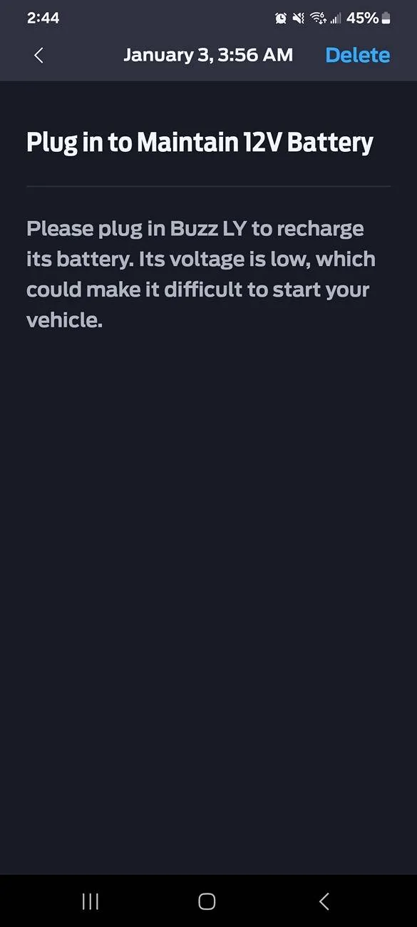

So today I check my messages. Got the one this morning about Android 14 users having a hard time with phone as key. I am looking at my previous messages about the lights being left on. It was DELETED ( NOT BY ME) and replaced with this Bull shit . See screenshot.
Ford F-150 Lightning Powertrain Malfunction/ Reduced Power Screenshot_20250105_144400_FordPass
Are they trying to cover their butt's about killing my battery ? Not cool. I took a screenshot of the original message. For proof.

Does the dealer have the ability to delete messages in Ford Pass App? Or who did they get to cover their butts? Going to raise hell tomorrow about this. If the FORD official is watching this . Help!

Not that I am aware, but I usually flush out messages once read, but if I were experiencing a "problem" then I'd probably keep any related to the issue.

Luckily, I took the screen shots to post on here! Just seems shady ? What they actually did is replace the, Left lights on message with
Quote/" Please plug in to Recharge its battery, it's voltage is low, which could make it difficult to start your vehicle". And it was at a different time stamp than the original.
