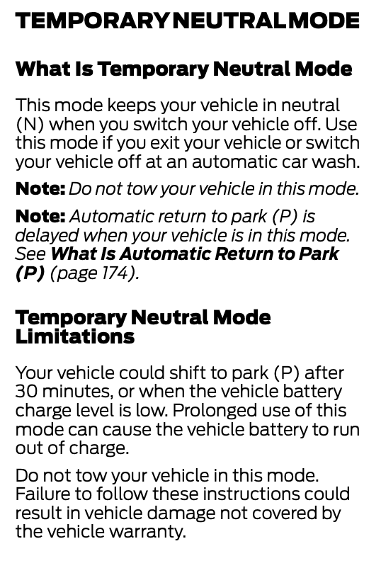

All this talk of probably not being able to flat tow brings up another question: surely the lightning will have a neutral position on its gear selector, what will this actually do? Will I still be able to put it in neutral and push it out of the way if it’s dead? Will I be able to spin a wheel freely if I jack up the vehicle, as if to change a tire? If these situations work, why wouldn’t you be able to flat tow in neutral?
The Mach E has a neutral for being pulled through car washes, towed not flatbeds, and other emergency situations. However, it is designed for slow speed and short distance use only, not flat towing.
Ford F-150 Lightning Powertrain questions Screen Shot 2021-05-24 at 9.05.30 AM

You don't really need a classic "neutral" to push it or rotate a wheel. You only need a button to release the brake assuming that the park brake is automatic.
So what are the technical limitations that won’t allow flat towing with this neutral mode?

I can only guess that there is a mechanical lock up when power is lost. It needs voltage to get out of park.

Permanent magnet motors are always going to be either motors when supplied with the correct voltage or generators when they are spun. If the energy being generated has nowhere to go, it can overheat or damage something in the system and if the electrical current flow isn't balanced properly it will overheat and damage the windings or insulation of the motor.
Even AC motors and generators, which tend to be more robust than their DC counterparts can suffer permanent damage under the right (wrong) circumstances.
Electricity and magnetic fields can do wacky stuff and since it can't be seen most of the time it's one of the harder things to conceptualize.

Thank you for the explanation.
