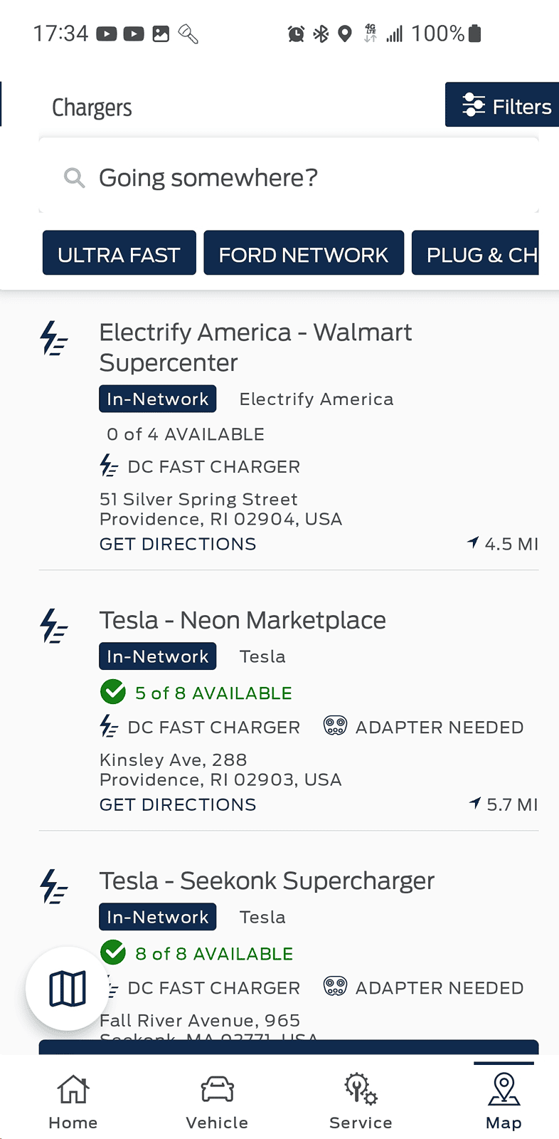

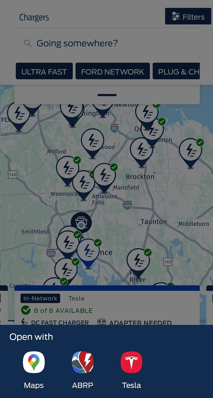

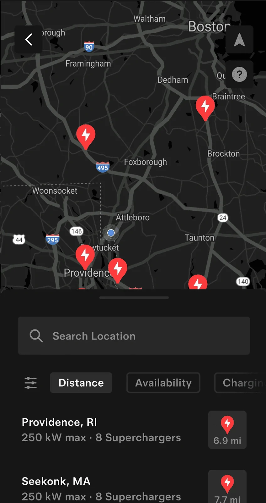

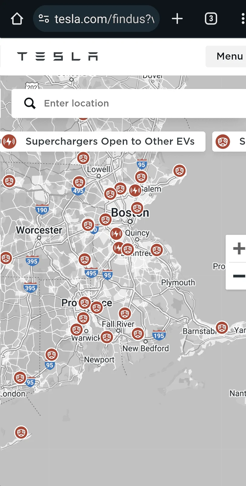

If you don't have the Charge Assist app, then use Tesla's proprietary app to locate stations that are open to NACS adapter customers
Ford F-150 Lightning 2 Questions 1712179852817-e6
Ford F-150 Lightning 2 Questions 1712179925661-ma

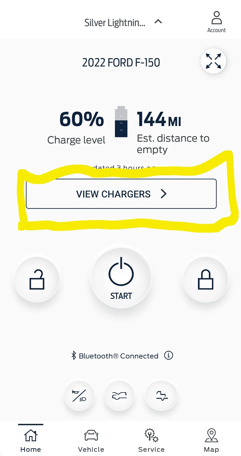

Use Fordpass
Ford F-150 Lightning 2 Questions 1712180014224-mt
Ford F-150 Lightning 2 Questions 1712180071507-wx
Push address to your favorite routing tool
Ford F-150 Lightning 2 Questions 1712180128948-7a

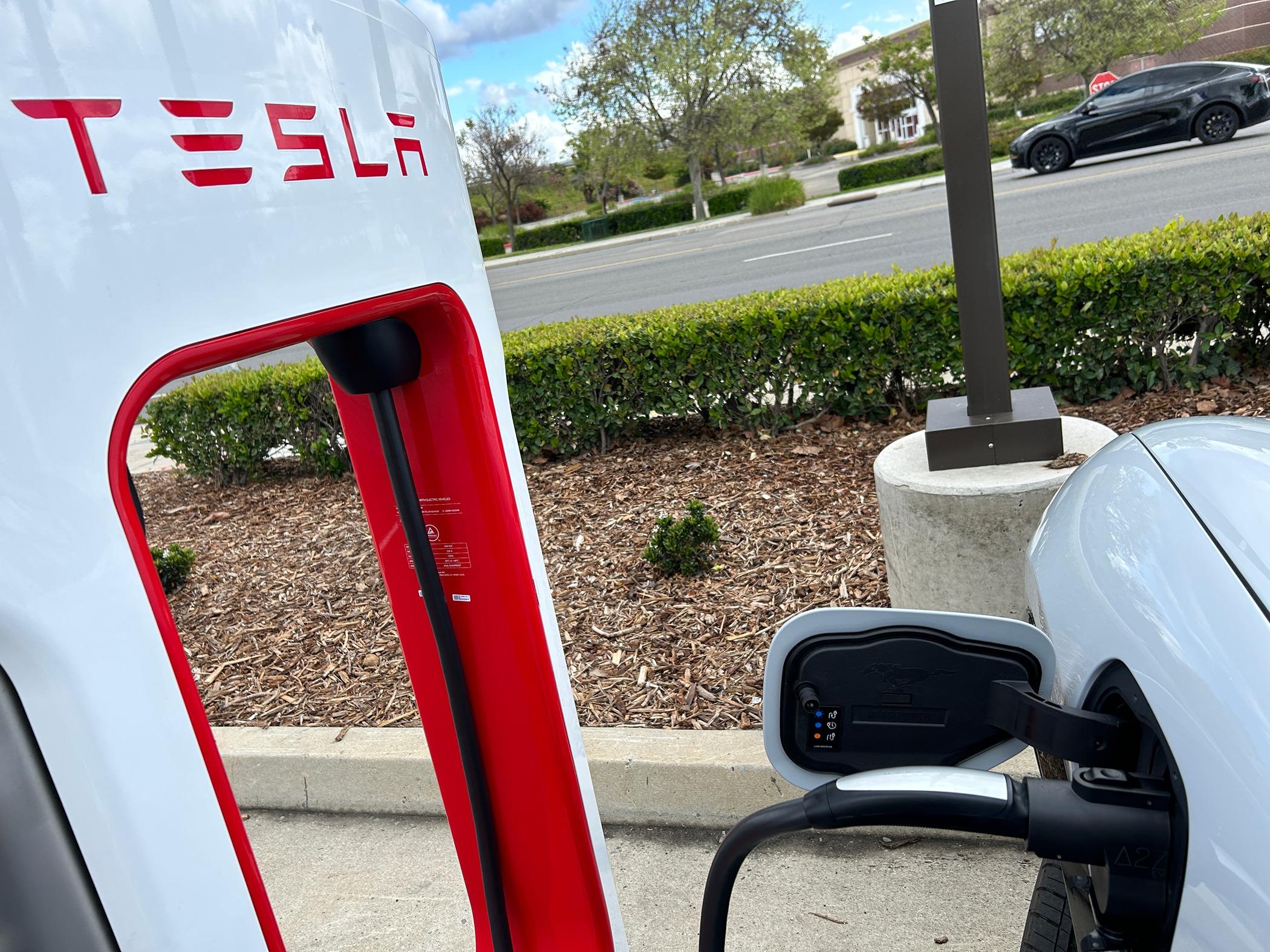

Charge Assist / Public Charging is useless while in motion.
If you can stop to choose a Tesla SC then it's great.
I had to use Tesla app to locate SC while on a road trip (can't stop on freeways) and entered the address into the Ford Nav.
Hopefully in the future Ford Nav will include Tesla chargers....
Love my A2Z adapter while I wait for the Ford adapter.
