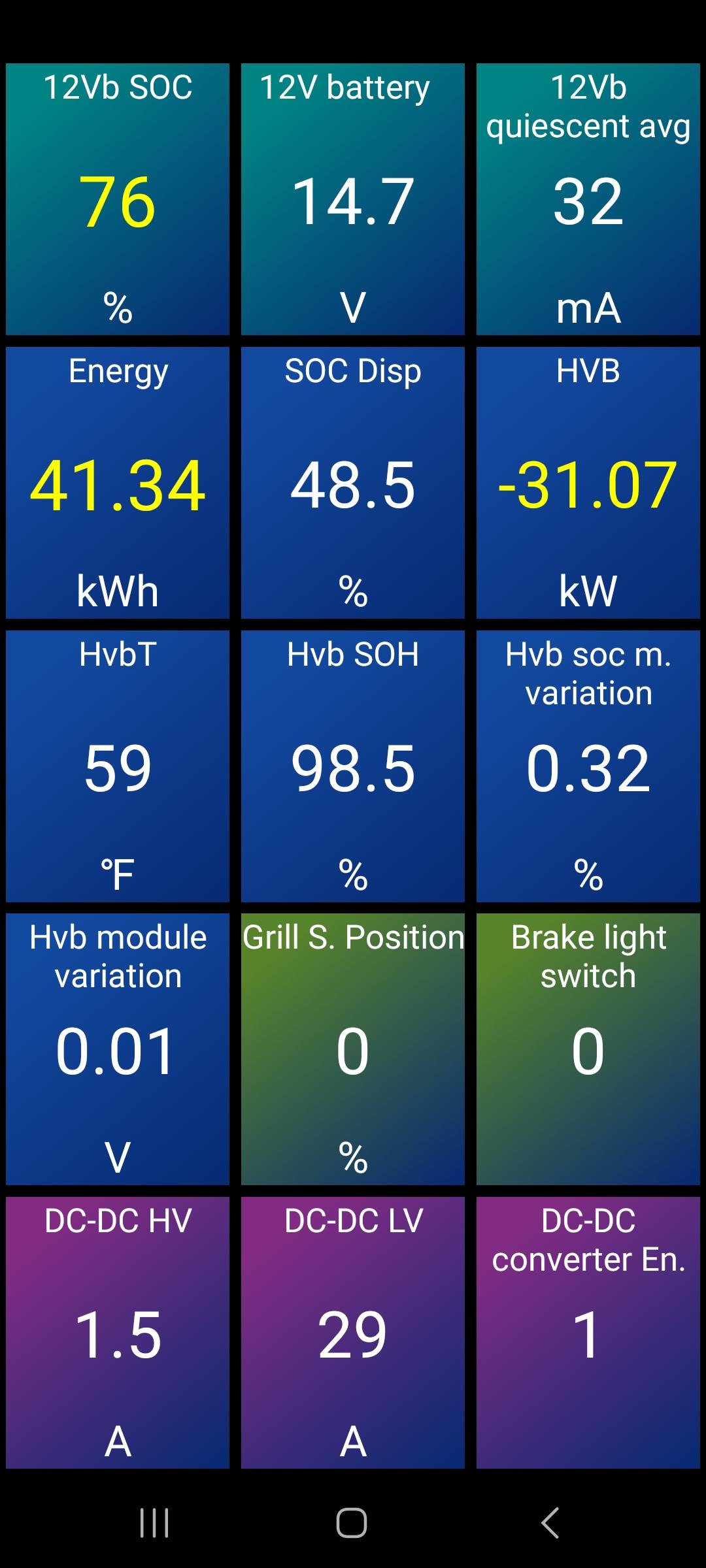

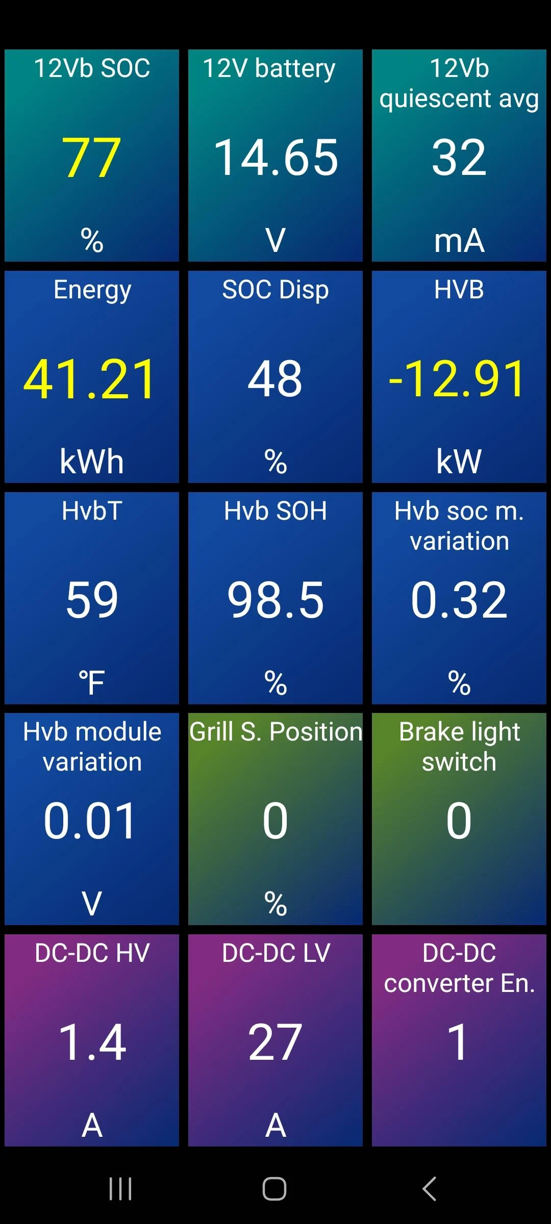

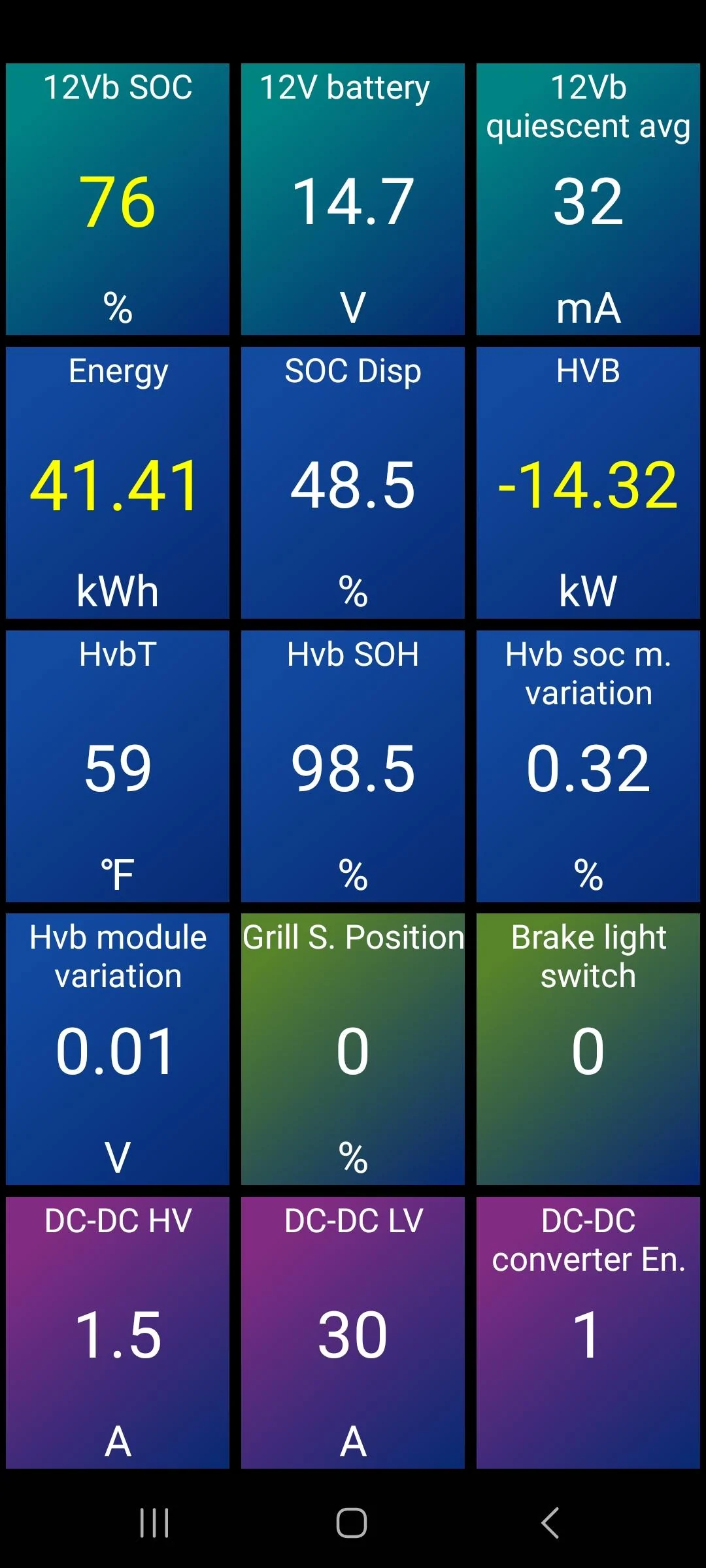

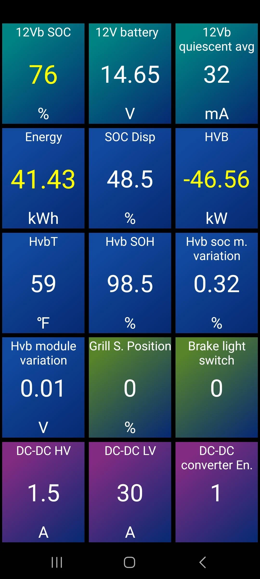

Just did a drive down the hill with foot off everything. Same slope for all. One pedal driving is off.
Look at HVB for regen in each driving mode
Looks like brake light is not coming on unless I press the brake pedal.
Regen for each would be higher at steeper slope.
Normal
Ford F-150 Lightning "STUPID QUESTIONS " Normal_20240126_132715
Sport
Ford F-150 Lightning "STUPID QUESTIONS " Sport_20240126_132740
Tow haul
Ford F-150 Lightning "STUPID QUESTIONS " Tow_20240126_132810
Off Road
Ford F-150 Lightning "STUPID QUESTIONS " Off_20240126_132926

Just did a drive down the hill with foot off everything. Same slope for all:
Normal, sport, tow haul, off road screens in that order. Look at HVB.
Were you coasting even with TOW & OFF-ROAD or did you need to touch the pedal ?
If not touching the pedal, maybe the slope was deep enough the truck passively engage the regen even in these modes.
Last night when I did a quick check, it was on relatively flat section of secondary highway at speeds of apx 45 mph, these was a noticeable absence of passive regen in tow & off-road until I touched the brake pedal.

In all four cases I was coasting down hill at the roughly same speed with my foot off everything.
How did you know there was no or less regen? Mostly by how fast the truck slowed down when you took your foot off the go pedal?
188
14,172
15,294
Yes, seat of the pants sensation of deceleration the instant I lifted foot of accelerator pedal, as well as watching the [green/white/orange] arc between 6 & 8 o'clock on the power gauge, intensity of battery replenishment animation pulsing [blue/white/orange] arc 6 to 2 o'clock.
Your numbers definitely show regen is happening at various intensities though.
