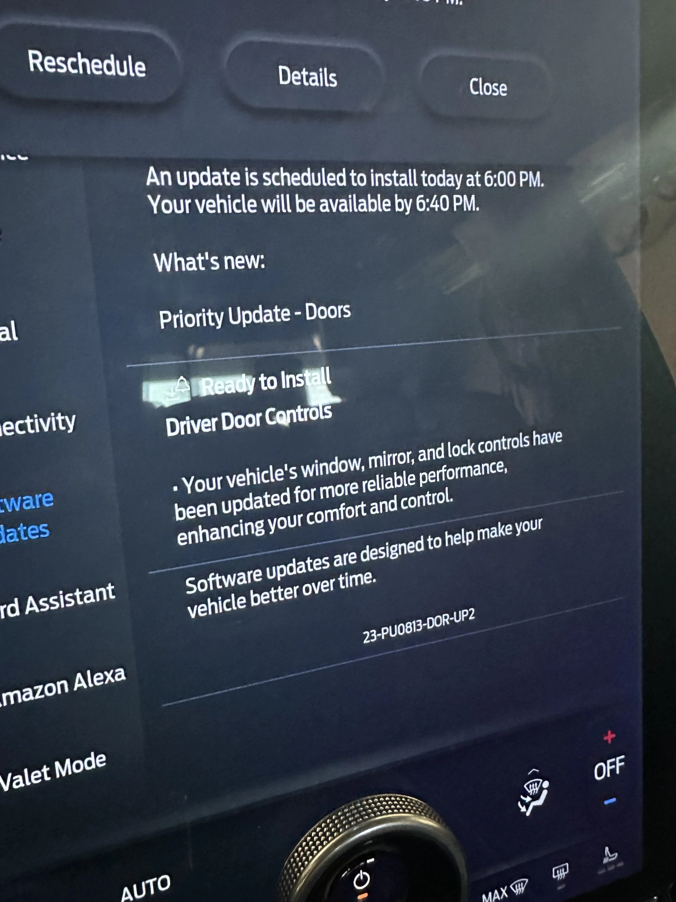

Priority Update: 23-PU0813-DOR-UP2
COrocket
Jan 20, 2022
363
873
F-150
Im guessing this isn’t the one that enables walk away lock yet?

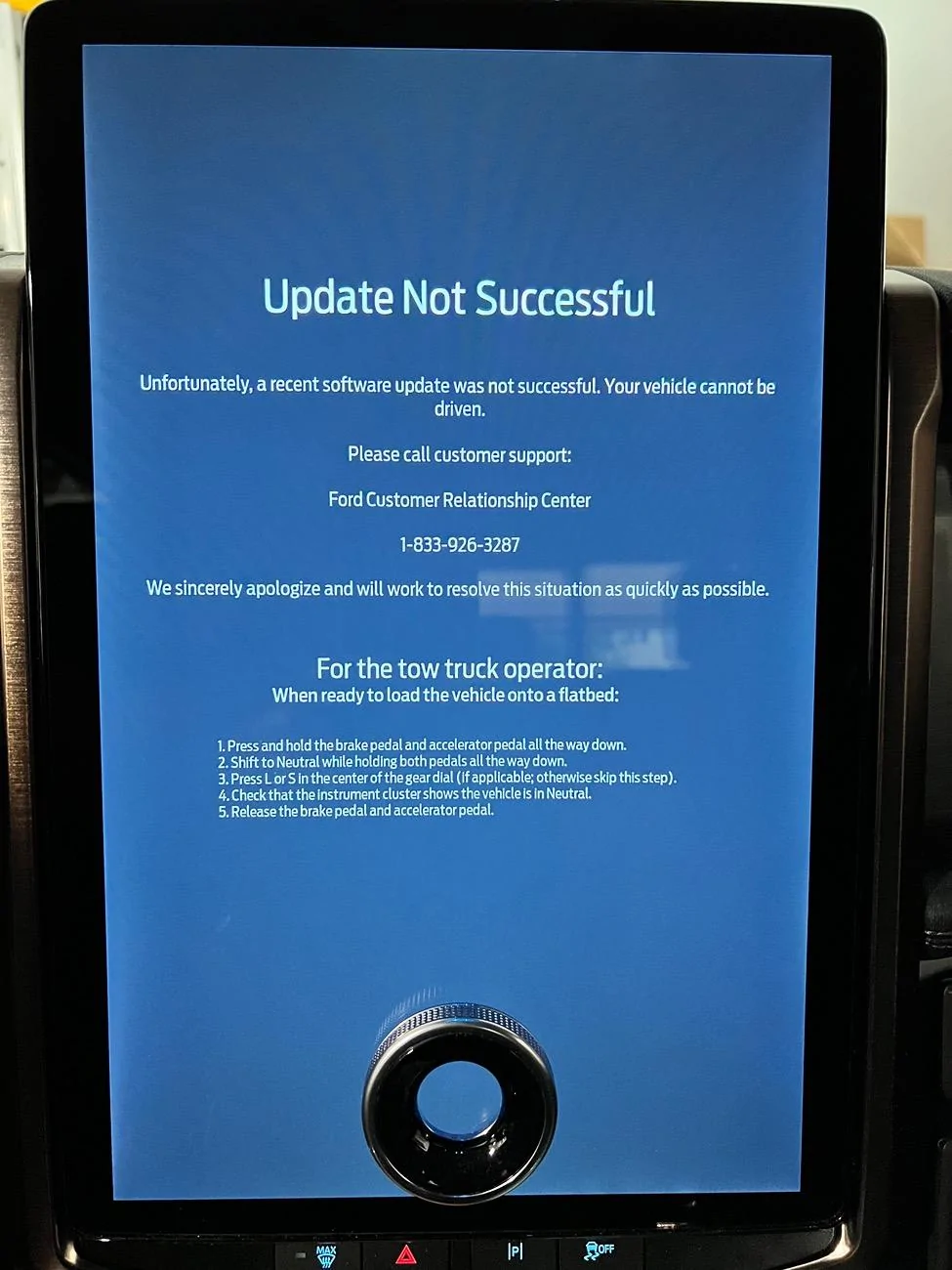

Update failed for me, too, at 5 AM today. Truck is stuck in INHIBIT MODE. Trying to power it on, only starts in "Full Accessory Mode." Shift lever won't go out of PARK, etc.
Car Scanner said my LVB was 86% SOC before it started, 85% SOC when it ended (my truck was plugged in to my FCSP). I haven't had the BSM monitor replaced yet. My dealer had it on back order and hasn't called me about it yet.
Did you get this screen? You said you can’t get it out of park but will it go into neutral if you follow these instructions? This is what happened when I got stuck in inhibit but mine was on a bigger update before the BMS update.
Yes, I eventually got that screen. It only showed up after quite a few attempts at starting my truck. Now it's the only thing my SYNC screen displays and I can't go anywhere else or see anything else on the screen, same as your photo shows. :sadface:

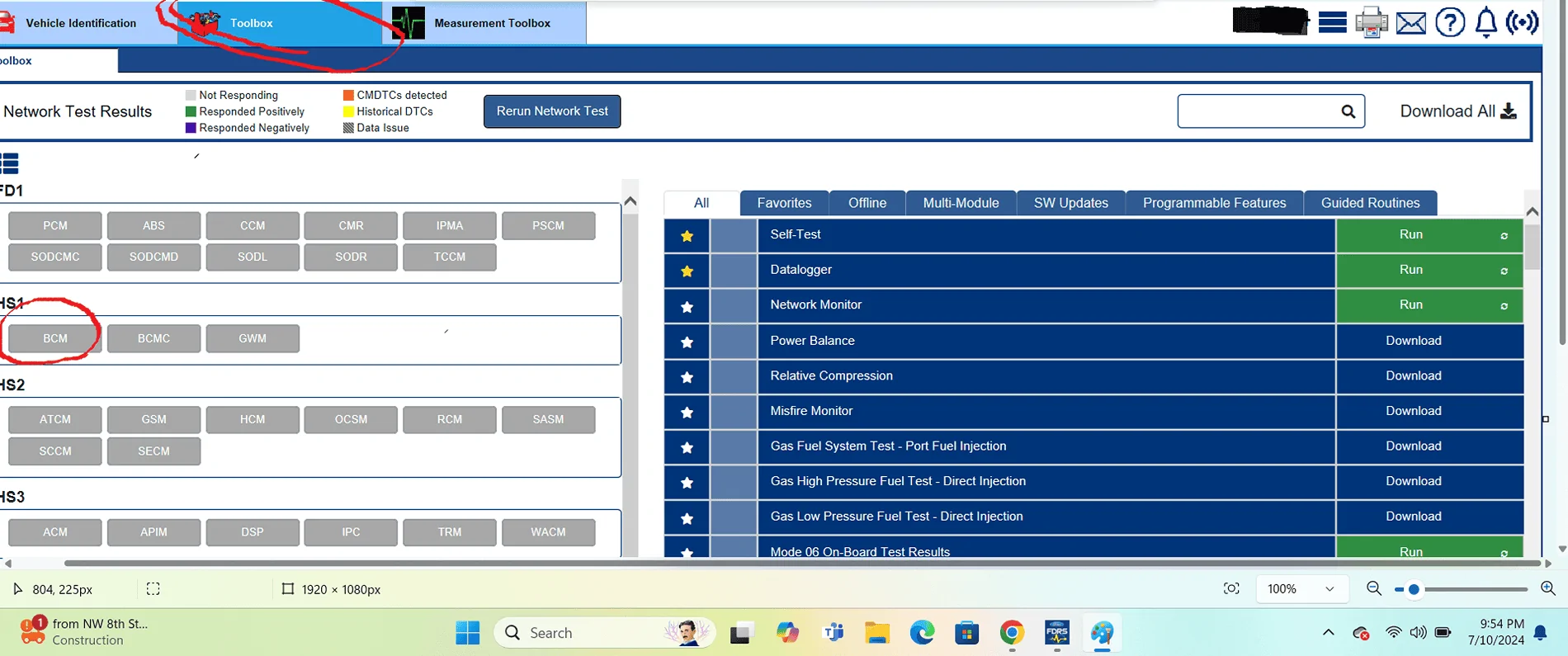

rugedraw
Javier
Dec 14, 2021
1,877
2,302
Miami
Auto Sales

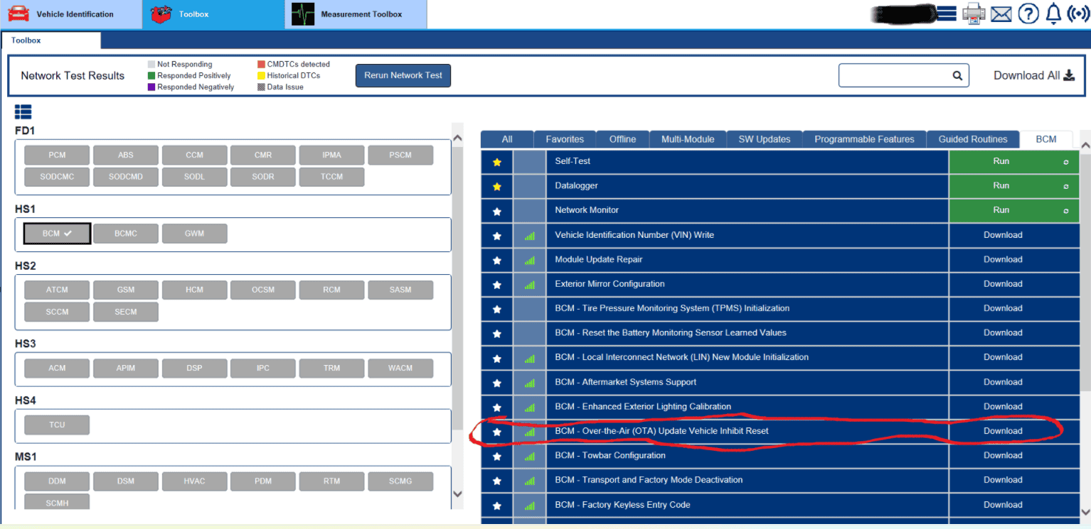

Once you get FDRS set up and you read the VIN from the truck, you'll click the toolbox tab (circled) and this is what you'll see. Next, click the BCM (circled).
Ford F-150 Lightning Priority Update: 23-PU0813-DOR-UP2 1720662946486-jn
Once you click the BCM, you'll see this screen below. Look for the BCM vehicle inhibit reset app, and click download to the far right. Once it downloads, it'll change to the word run in green. Click run and then follow whatever steps FDRS tells you to do.
Ford F-150 Lightning Priority Update: 23-PU0813-DOR-UP2 1720663132238-o2
