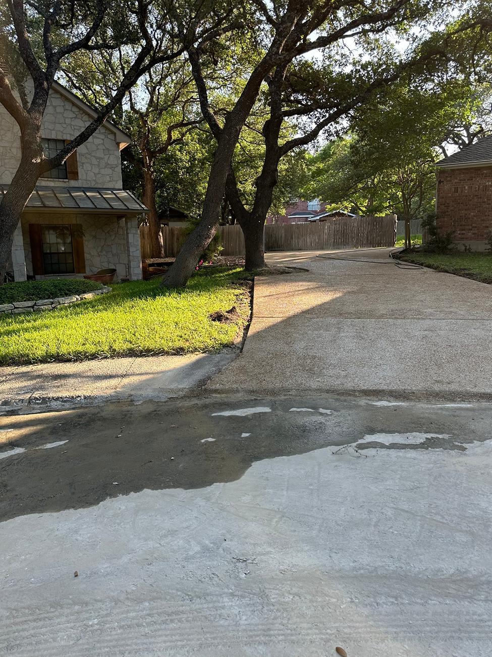

My driveway rises about 5' from the street and makes a greater-than-90-degree turn into the garage (I normally back the truck up the driveway, then drive forward into the garage). AFAIK, there is no way Ford Roadside Assistance could get a flatbed trailer positioned to winch the truck out of the garage onto the trailer. Roadside Assistance told me in reply, "Our people are experts. They'll put your wheels on dollies and roll the truck out of the garage." But as you can see in the photos below, the drive slopes down about two feet to its outer edge, and the neighbor's house is only about 15 to 20 feet away from the driveway. If they lose control of the truck, it will end up crashing into the neighbor's house and/or taking down fences at the top of the driveway. Do dollies have brakes that can be remotely applied?
It's crazy to have an expensive, time-wasting trip to the dealer for who knows how long just because there is no reset mechanism to unlock Inhibit Mode at least enough to be able to drive out of my driveway to be towed onto a flatbed easily.

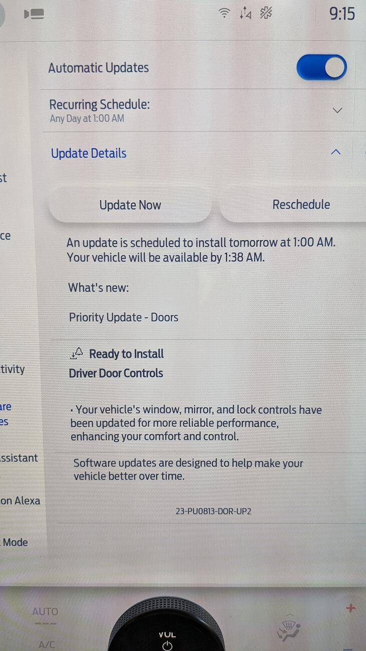

Ford F-150 Lightning Priority Update: 23-PU0813-DOR-UP2 IMG_0887
Ford F-150 Lightning Priority Update: 23-PU0813-DOR-UP2 IMG_0900

@Jim Lewis I work at a dealership that works out of a 9-story 550k sq ft building with columns and tight spaces everywhere. When roadside brings in a car that is not running, our drivers make it work in MUCH tighter spaces than what you showed in the pics. That I would not be concerned about.

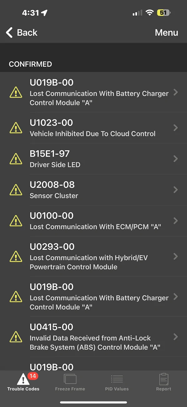

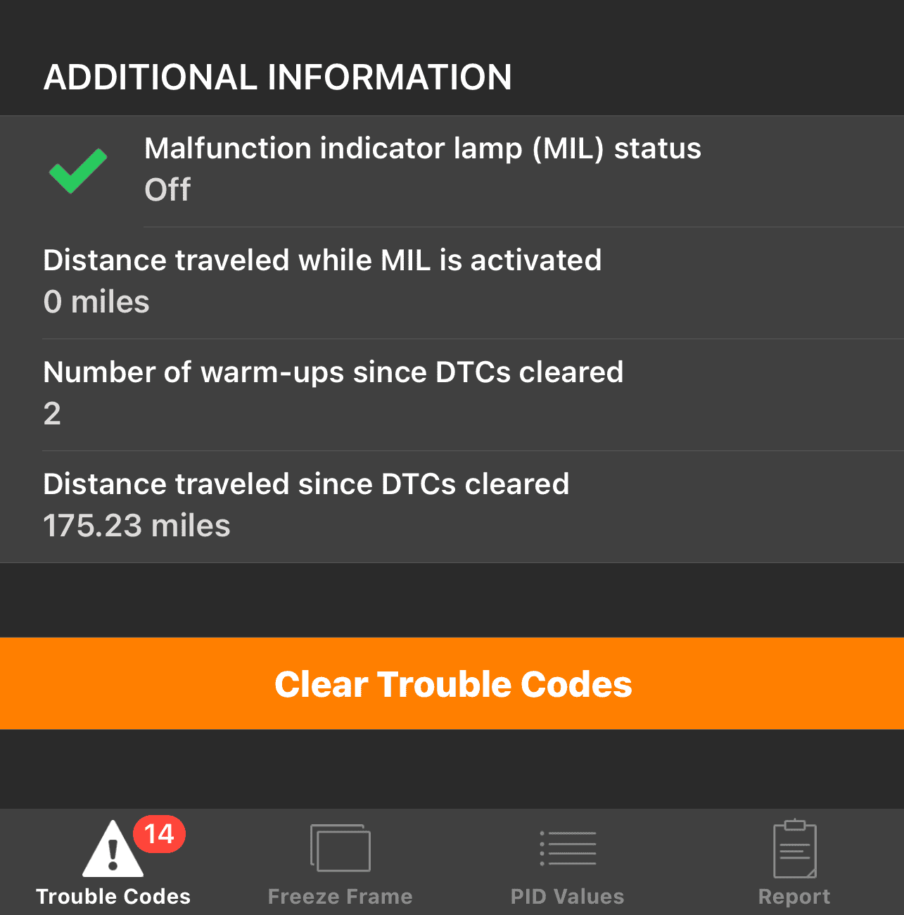

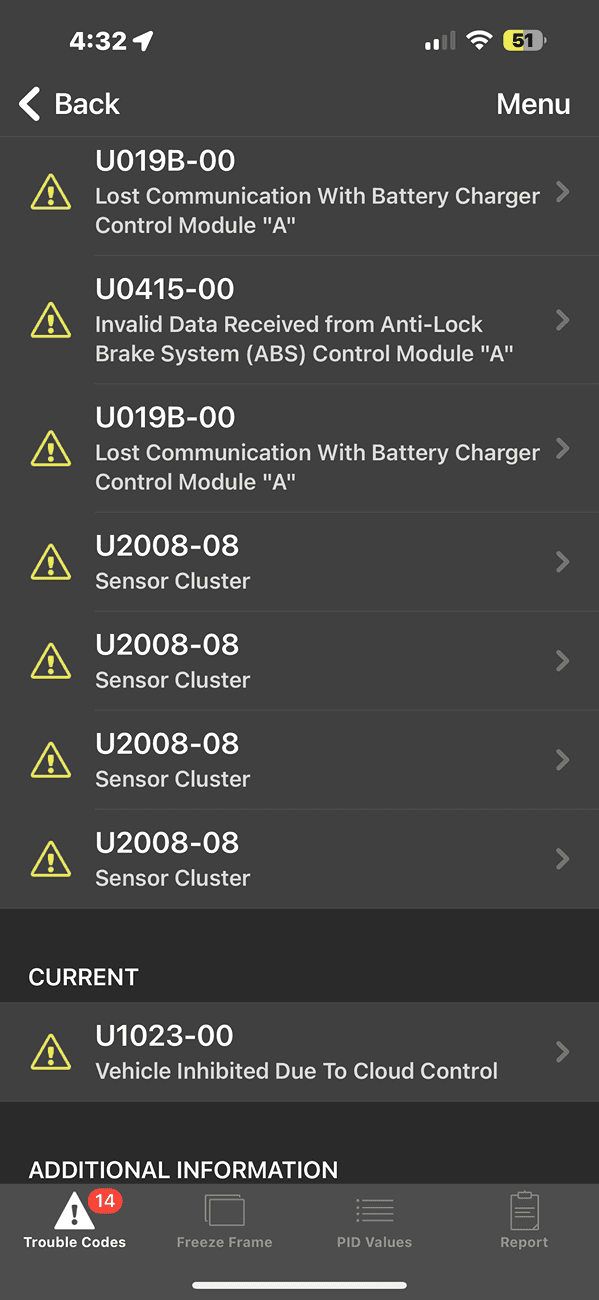

Shortly before the failed update, my truck had no DTCs, either via OBDLink or Car Scanner using an OBDLink MX+ OBDII reader.
Here are the DTCs that OBDLink currently reports for my vehicle, including being inhibited due to "cloud control" - I was wondering if I release Inhibit Mode with the Mongoose, which just arrived, whether "cloud control" is just going to be reapplied right away?

The exported DTCs from Car Scanner are much more extensive, including numerous listings of module diagnostics not completed, undoubtedly due to Inhibit Mode (see attached text file).
I thought I'd try removing Inhibit Mode via the Mongoose. If that works and the truck can be started, then I can clear the DTCs, scan again, and see what error codes I still get, if any.
If Ford Roadside Assistance has motorized dollies that can brake and be steered, I can see how they could get the truck out of my garage. Otherwise, if they can't make it in one turn, I don't see where they'll find the room to move the truck back uphill to make another turn, even though the grade is modest.
