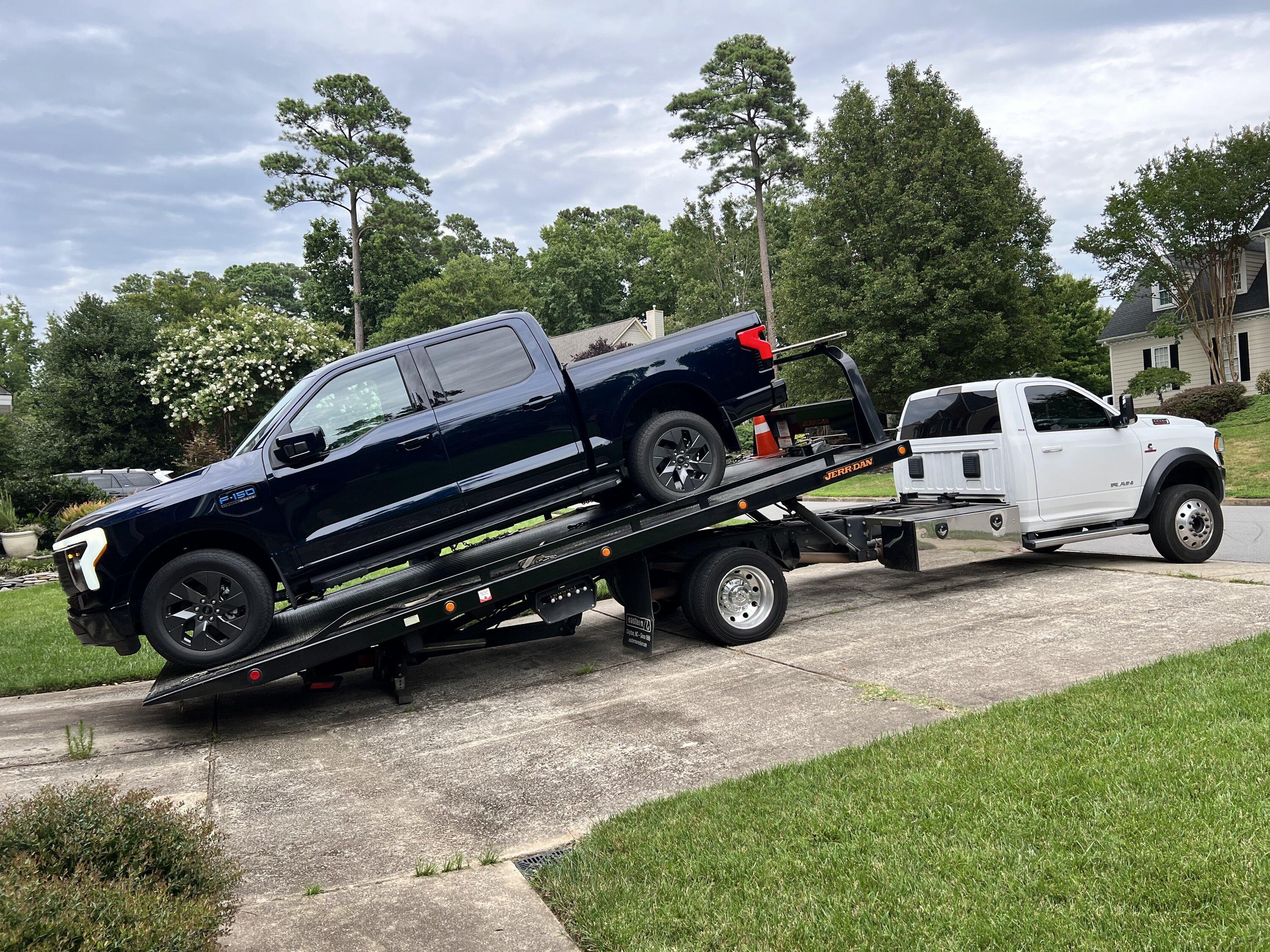

On my 14th try I got this. Waiting for the tow truck.

So those are the correct instructions. I showed the driver how to do it. It does seem to be missing a step though because as soon as I released the pedals it put itself back into park (the door was open). You need to press the Neutral button to keep it in Neutral for 30 minutes before you release the pedals.

Need to close the door
So if I had put it in neutral with the door closed, then released the pedals and opened the door it would have stayed in neutral? I had the door open so the tow truck driver could see what I was doing and he would know how to get it back in neutral when he dropped it off.

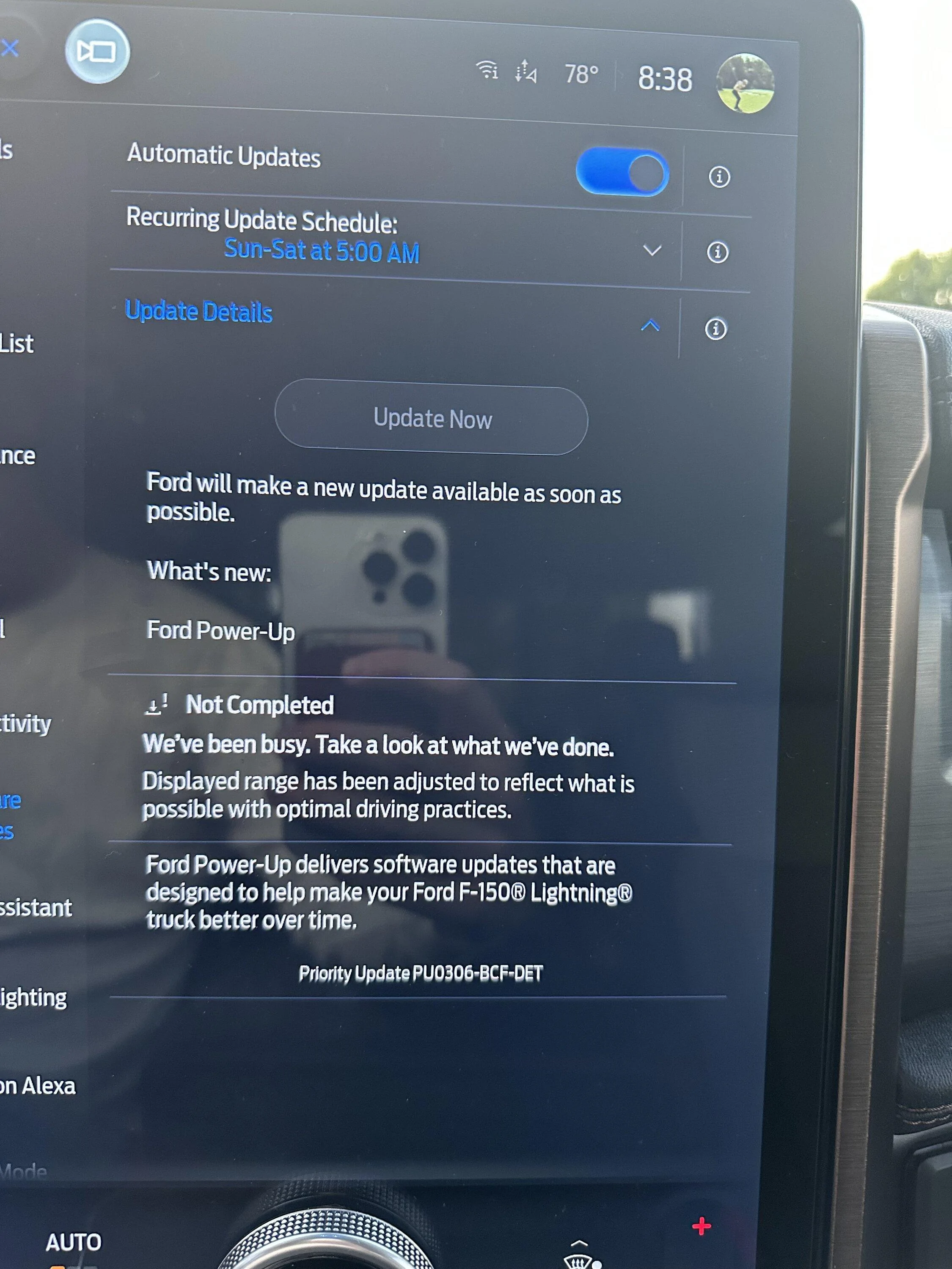

After more than a few dozen failed attempts at this update (first time failures have ever happened), the update notification went away and was completely cancelled, leaving me the message pictured. Called Ford thinking they had pulled the update, but after a long time on hold as a very nice woman tracked down answers, she said my update was automatically cancelled due to multiple failures for the same issue (12v battery). I guess there’s a failsafe at some point? She said my truck has been placed in the back of the update queue and that there’s nothing they can do remotely. Lovely! She suggested taking it in to have the 12v looked at. Tested it myself and it is completely charged up and healthy. What a mess.

I’ve been advised to do the reset by people that do know what the reset does so I assume it is OK. I don’t think the reset was a cause but it may have finally exposed the faulty battery.
Mine has done the same thing. I'm scheduled for a light switch replacement on Tuesday so will have them try the update.
