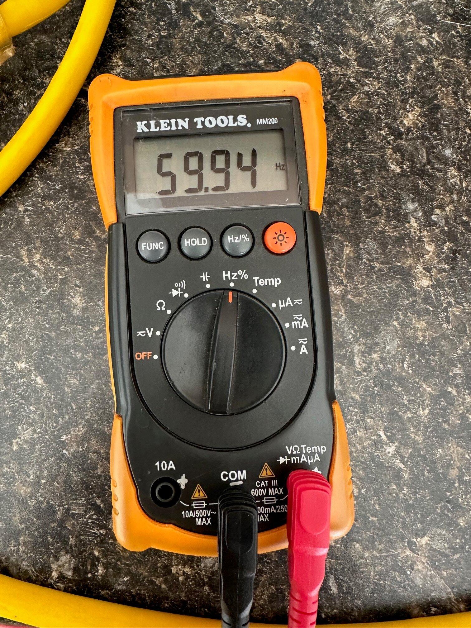

OP here. Figured out my other meter does HZ. Frunk inverter is putting out a steady 59.94 hz. Checked grid to confirm meter accuracy and it was right at 60. Rear outlets (120v and 240v) jump to 60 hz for a split second and then jumps all over the place. I hope I didn't fry any of our electronics.
This should be pretty easy for a dealer to diagnose.
Frunk:

Looks like a defective inverter.
Definitely. My dealer says they have no way to diagnose it. I even hauled the damn oven there to show them the frunk inverter will run it but the bed inverter won't. Going to a different dealer on Tuesday that has a oscilloscope. They may not need it when I show them the crazy HZ readings.
I can't bug my selling dealer too much as I need a good relationship with them for the next battery module replacement and all the recalls this truck has :ROFLMAO: They gave me a nice loaner during my first module replacement.
