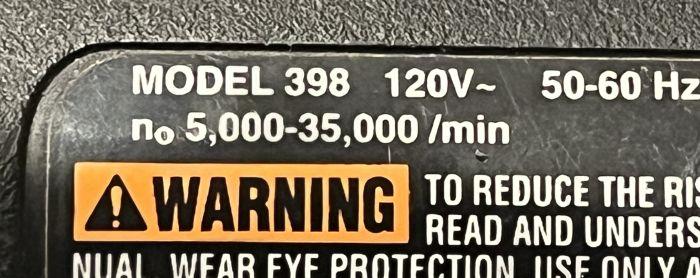

Thanks for testing some Dremels in your LIghtning.
My Dremel is a model 398. An online manual is marked 1997.
