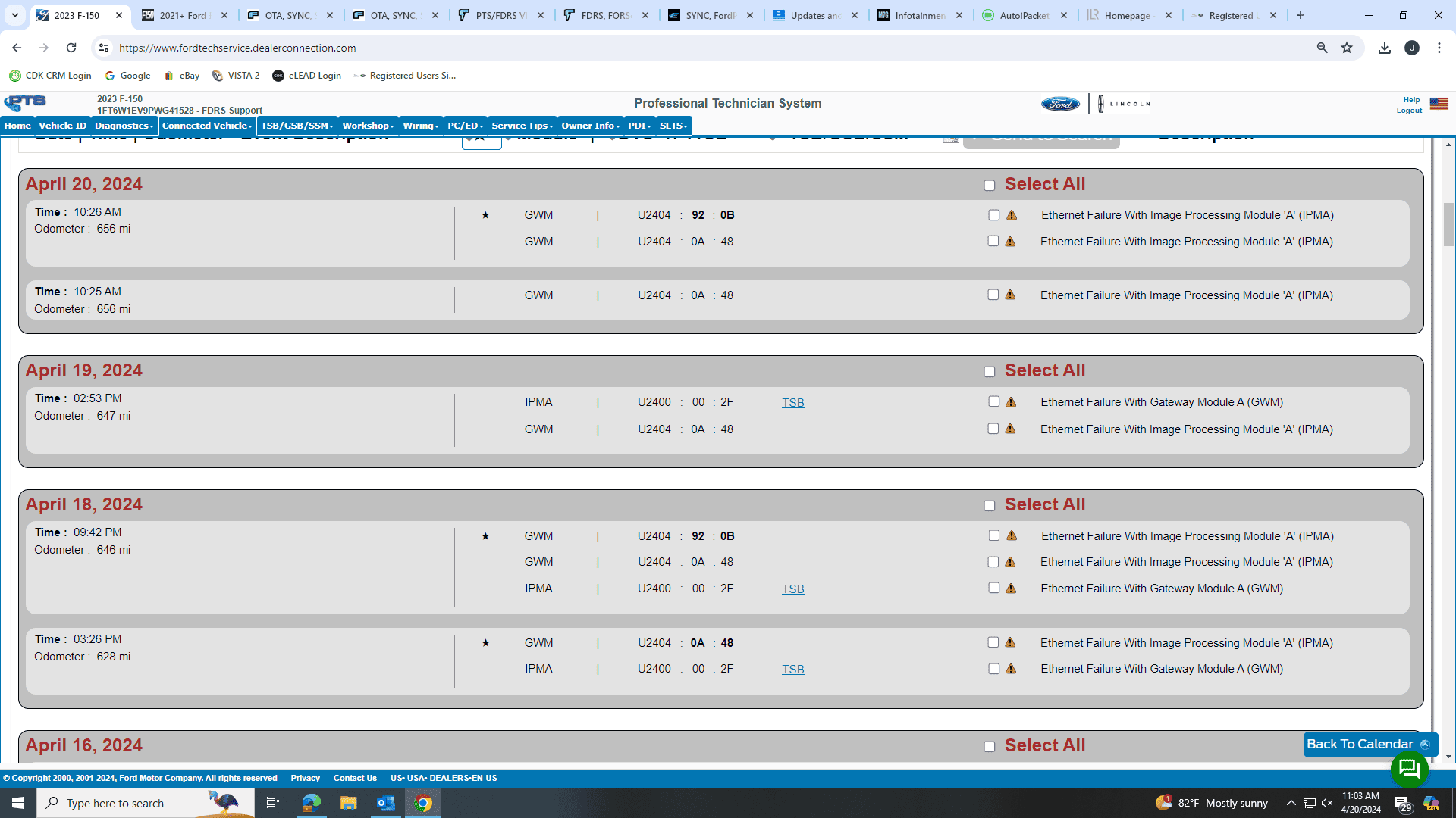

Could you check 1FT6W1EV9PWG41528
Just got it back from the dealer after sending it in to fix bluecruse. They said they flashed all the modules, but the issue remains. ( BlueCruise never engaging )

Everything looks good as far as the config and having the correct updates needed for BC to work. I had someone else look at your truck and I was told these codes is what is preventing BC from working. If you don't have FORScan, get it. You need to go into the wrench icon and clear codes for both the GWM and IPMA and BC should work after that.
Thank you! I was checking FORScan yesterday, but did not try the module reboot procedure. Just restarted both, cleared the dtc and no longer seeing any errors! Will be on the highway later today and wil report back
Error came back at some point and BC never engaged, so assuming it came back when I took it out. Will have to keep playing around with it. Thanks again for checking.
My bad, I missed a step. Reset both modules and then clear codes.
